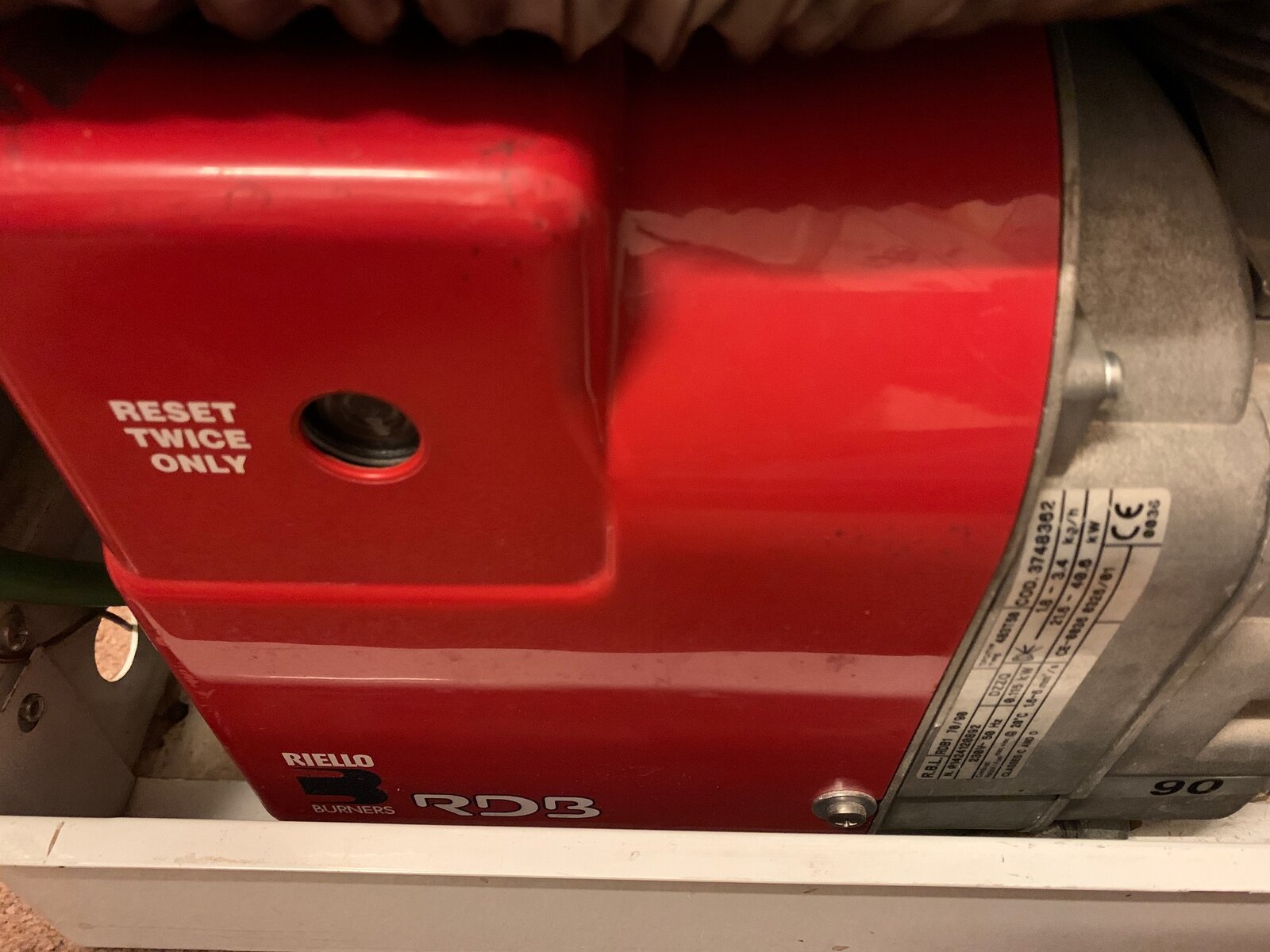

We have the above Oil Boiler. Had a selection of new parts fitted over the last 12 months (see below). Everything has been running fine for about 6 months since last repairs.
Over the last couple of weeks, any time the CH is switched on, it fires and heats as it should but once the heating is on for more than 45min - 1hr, the control unit trips to red. Everything else appears to work fine, hot water no issues. I checked the expansion vessel, it had failed (full of water) replaced this assuming that was the obvious issue but the reset problem still persists.
Any advice before I spend yet another chunk on getting this investigated. It's been a cash hungry boiler over the last 12 months! Some expert advice or suggestions would be wonderful. Thanks in advance.

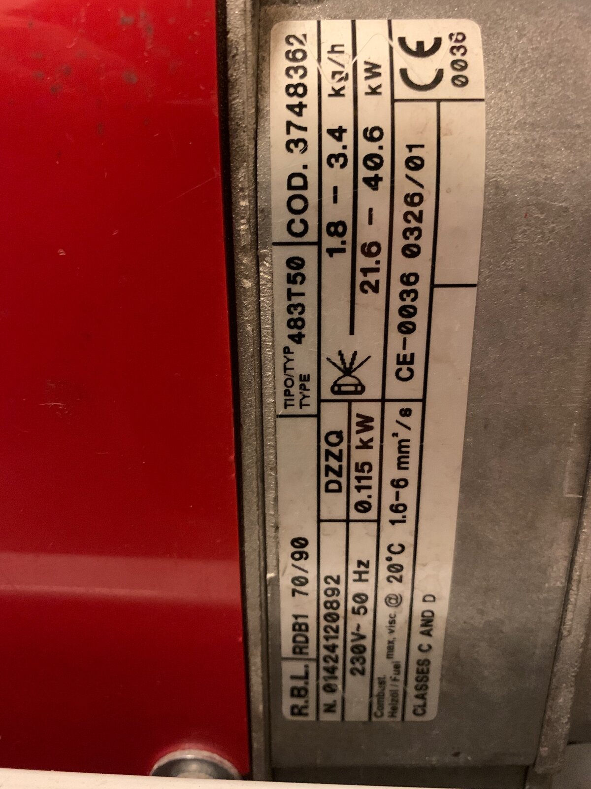

What burner do you have fitted to this boiler? Your mention of a digital control unit suggests that the burner has been replaced from the original Riello G5.
Your fault suggests a failing oil pump solenoid coil. A cheap part and easy to replace, but you need to know which burner you have.
i'm guessing it still has a G5 but he is referring to the red light on the control panel. pump solenoids rarely fail on riello's so i would be looking at fuel starvation. I would check the filter at the tank is clean first.
Thanks for the input gents. I've added some photo's of the burner for clarification. I think it is the original one but couldn't be sure as we inherited it around 3 years ago. I'll defiinitely check the filter at the tank. It was replaced a couple of years ago but doesn't seem a difficult job to access or clean. Fingers crossed it is that as this would certainly be an easy and cost effective solution! Any other advice or suggestions will be greatfully recieved.

This is an RDB burner and is a replacement for the original. I still think, for what it costs, replace the solenoid coil on the fuel pump. This can be done without removing the burner and it is straightforward when you look at it. Just be sure you refit the steel horseshoe shroud. Riello coils are more reliable than Danfoss, but they do fail.
