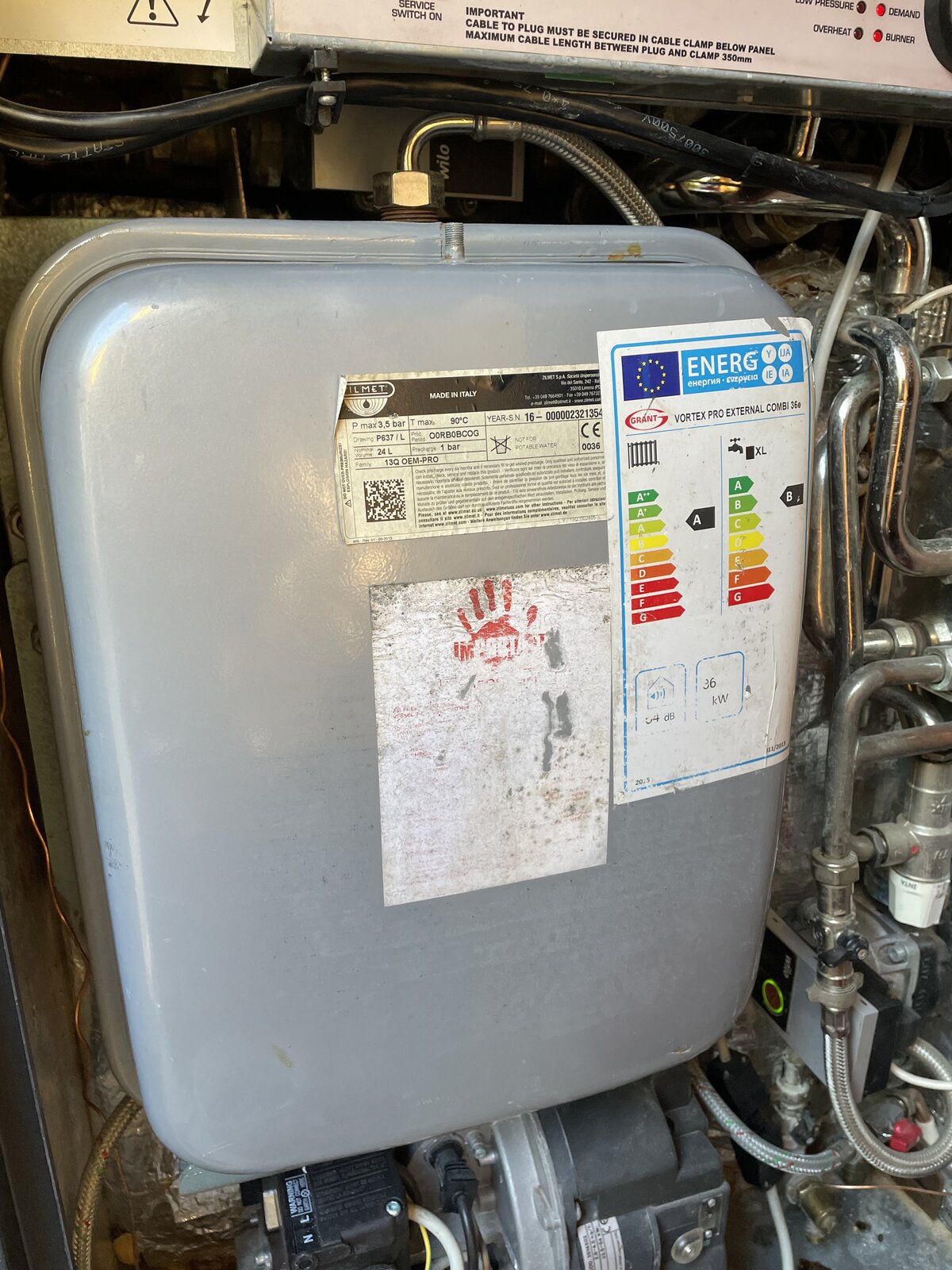

My question is - does the expansion vessel (24L internal grey one) - needing recharging - swapping ?
Or is it frost stat / combination of both ?

The grant PRV is set to 2.5bar vs 3.0bar for most boilers but you have a huge EV (expansion vessel) at 24L
With a precharge pressure of 0.7bar and a filling pressure of 1.3bar then that 24L EV will mean that the final pressure would still be less than 2.2bar even if the system contents are 180L, more than likely, they are ~ 100L.
Suggest just pressing it up to say 2.2 bar (cold), check that the PRV is not lifting/passing then press the EV schrader valve pin, if water comes out, new EV required, if air, EV OK, if so, depressurize system and remove the EV outlet pipe where connected to the EV and pump up the air end to 0.7bar, reconnect the pipe and then fill it (water end) to 1.3bar, keep a eye on it, note pressure when hot, wouldn't expect anything more than 1.8 to 2.0bar max.

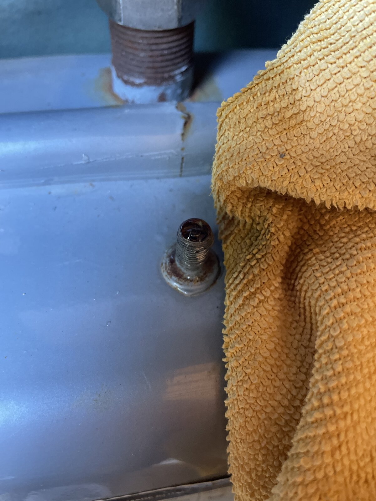

So I think it may be the expansion vessel - it’s a big grey 24L one , this shouldn’t be heavy as a concrete block should it?
I’ve pressed the valve in , and water cones out ?
Do I need to pop new one on.
Cheers
If water comes out for more than say 10 secs and no air then definitely requires renewing.
You will have to drain down the system unless there is a isolation valve on the outlet from the EV, before installing the new EV reduce/ensure the precharge air pressure as measured at the schrader valve with a tyre gauge is 0.7bar to 0.8bar, connect the outlet pipe then refill the system until the pressure boiler side pressure is 1.3bar and not higher, boiler ready to go.

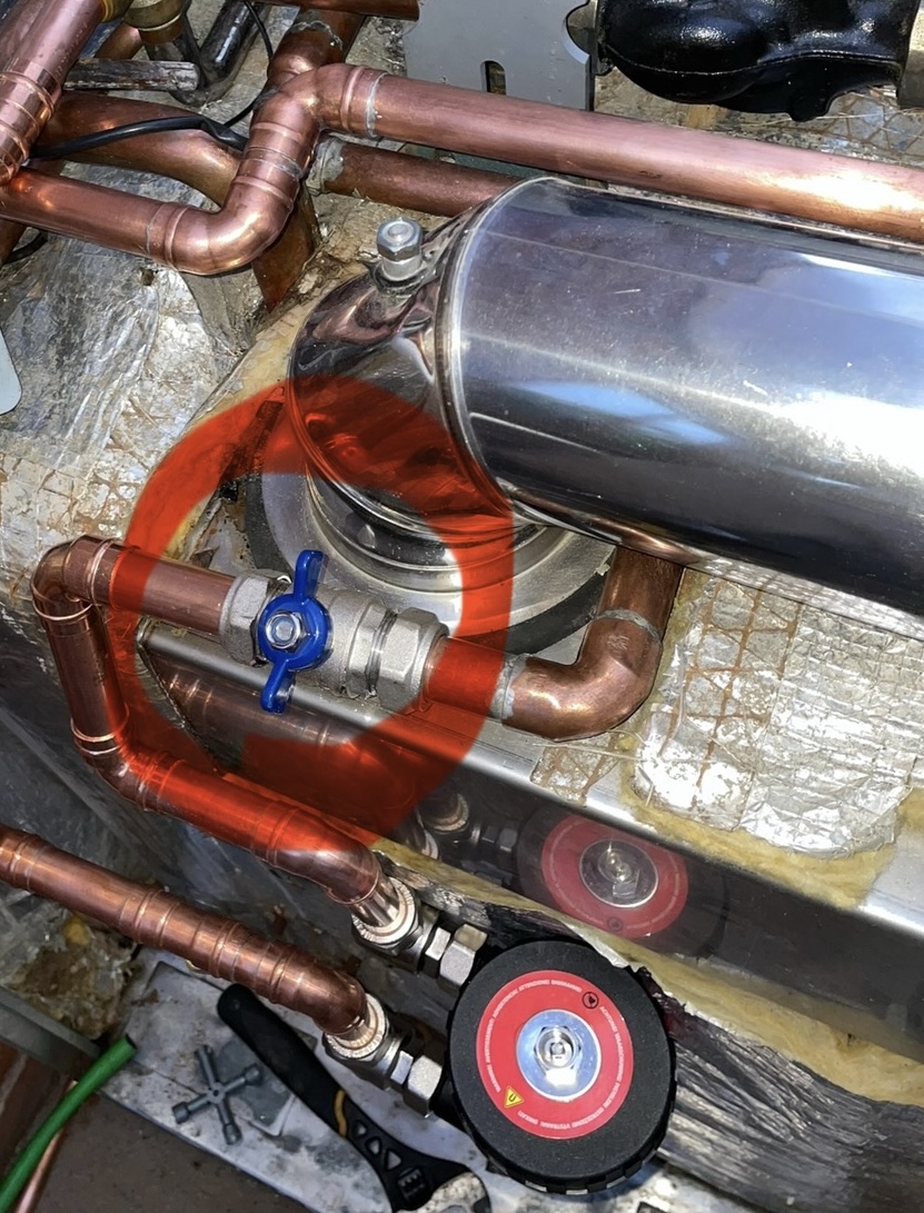

Hi exedon ,
The EV flexi pipe is brand new on this one, and the isolation valves I’m speaking of are in the top of boiler (brand new full bore butterfly valves sept 2024) - not the pump valves .
Also there’s full bore butterfly isolators internally - on pipe work before boiler - but that would involve taking plasterboard off wall . So not practical, unless we are changing boiler in future .
There’s another valve same as this on the flow pipe .

One of the pictures above, is that a crack where the flexi pipe connects?
View attachment 378308Am I right that the vessel shouldn’t be really heavy as in full of water heavy ?
