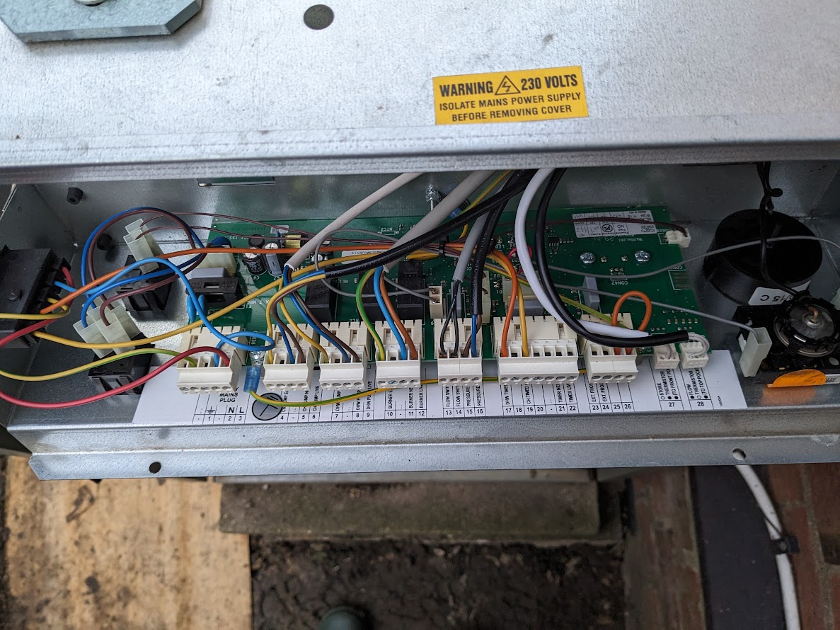

Some clear pictures of your board would be useful as there are several ways it can be wired.

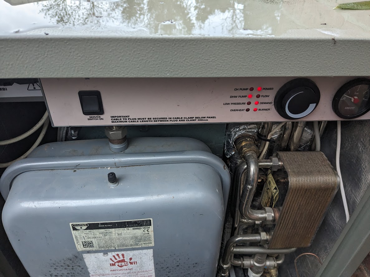

Exedon, Thank you for your reply. Please see below a picture of the PCB. Yes I understand that something is driving the demand for the hot water and hence the CH pump stops running. Of note is that demand for the DHW when the CH is heating is off is not apparent unless it just a quick blast to warm the store up, but if there CH demand the DHW is demanded much more (hope that makes sense!)
The second picture is showing when I have the CH heating demand on and the CH pump has stopped.
With regards to switches there is a Boiler ON/OFF and a service switch. The service switch is in the off position.

that picture shows that the boiler has the hot water tap on somewhere or the flow switch is on the way out. pull out the plug on connection 13/14 and see if demand light turns out. If so and your heating then works fine you have found the problem.
you would alos benefit raising the pressure up to 1.0 bar as it's close to the low pressure switch activating
