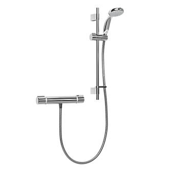

I have mentioned which pump it is, it is a Stuart Turner Showermate twin standard 1.8 bar. The shower mixer is a generic thermostatic mixer bar, no branding, like this:
Do these shed any light on the issue? The pipe runs look quite torturous which can't be helping
