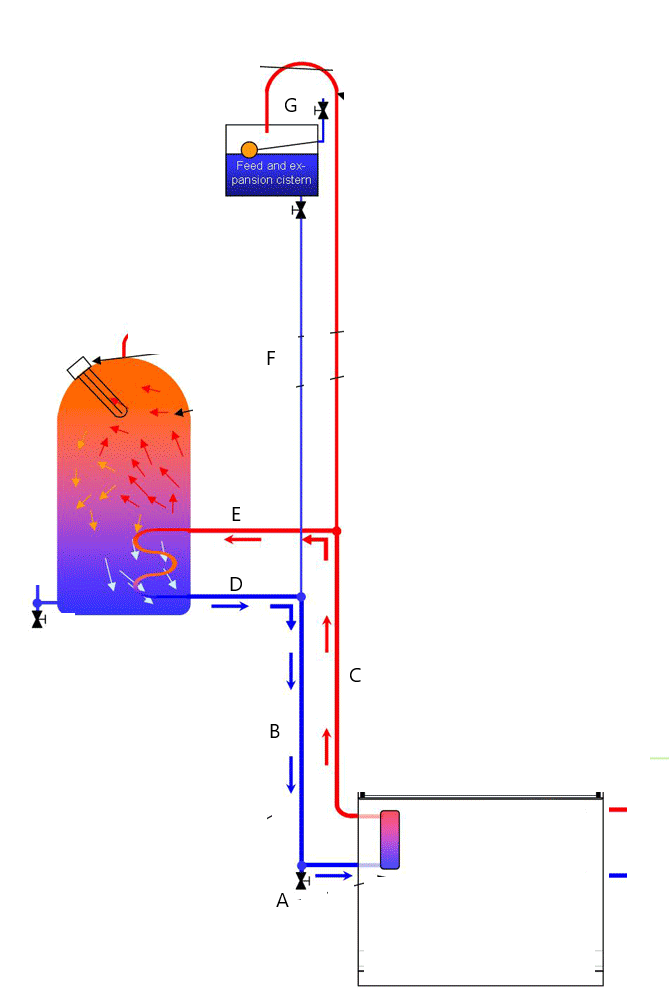

Had another go at this last night.
I can now say that the WATER circuit looks like this pic below. I have omitted the CENTRAL HEATING circuit on the right hand side of the boiler.
With hose pipe on draincock A (incidently this is not the Bolier draincock, that is a seprate one further down at Boiler base level) I allow slow water escape.
Can feel residual hot water from boiler, and its immediate surrounding pipes, leaving.
After a short while I notice that the escaping water is now cold. Flow pipe C is cold but Return pipe B is still warm to touch.
Bingo.... this must mean Feed F must have a blockage - but F&E Tank ballcock is running merrily replacing escaping water at draincock A, how is that reaching the boiler and why hasnt return pipe B gone cold?
Looking at the diagram it must be going into the Cylinder via pipe D then out of pipe E and down into the boiler via C.
Now convinced I have blockage in pipe B.
In order to achieve sure flush of pipe B, I decided to cut pipe D (the horizotal bit from the Cylinder) but then noticed I do not have much play in this pipe as the Return goes into the floor quickly and its quite hard bedded. OK, for the pupose of flushing I cut pipe E instead, (i did that last week). Pushed mains water hose into the Cylinder direction and blasted it (had one eye on F&E Tank just inacse it went up). Fairly quickly this water came out again from the other end of the cut on E. It was quite colourful to begin with but few buckets later clean water flowing. Then repeated in the oppsite direction.
Now convinced I shifted any blockage in pipe B. Infact pipe E, the Coil, D, B, the Boiler itself and pipe C cannot be blcoked. Soldered back E successfuly.
Re-filled using mains water fed via draincock A (assuming mains fill will overcome any air pockets).
Was this enough to solve HOT water isssue - sadly not. Boiler upto old tricks again, kettles off and doesnt send hot water up Flow pipe C. Left it running like this overnight assuming it needs time but still no change.
I am really lost now.
There must be a trick to 'encourage' water flow down pipes D and B, short of adding a pump in the circuit. These pipes are pretty close to floors and walls and cutting into 28mm pipes without being able to turn a pipe-cutter is going to be quite hard.
Any thoughts on what is going on here please. Determined to fix this having come this far.

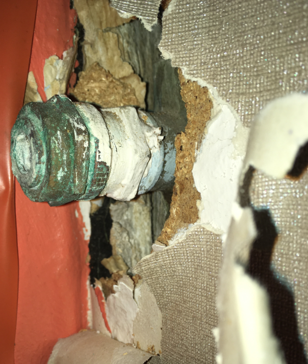

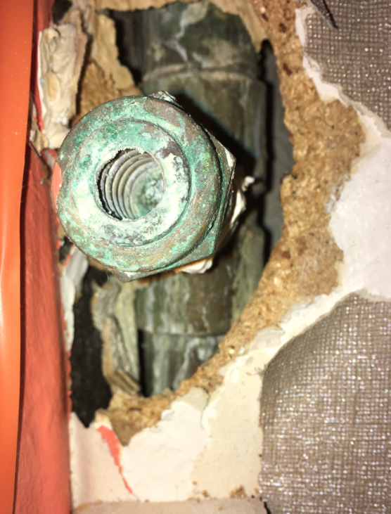

just dug out something that might be causing circulation issues for me. Its some kind of valve attched to the veritcal Flow pipe (pipe C in previous pic) and its half way up the wall from where the Boiler is.
Does anyone identify what this valve is please:
It appears to be an in-line contraption in that it does not chage the flow/direction of water.
It was burried in plywood boxing the pipework along the wall.
I havent tried to open it yet.
If this is blocking, all previous mains water flushes would not have been successful.
It's just a spring safety valve - leave alone, it doesn't interfere with the pipe diameter.

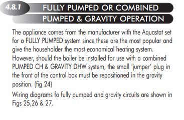

I had a similar set up to this and once had a problem similar to you describe, and it turned out there was a little jumper on the aquastat that could be set to GRAVITY HW or PUMPED HW. We had the aquastat replaced and the engineer who did that must have left it at the default of PUMPED HW.
Changed it to GRAVITY HW and all started working again.
That's from the manual. When it was set to FULLY PUMPED, the hot water wasn't coming out of the gravity hot water flow pipe and instead the return pipes were getting hot for a few inches.
But unless you've actually changed a part, then it wouldn't just happen out of the blue I guess..
