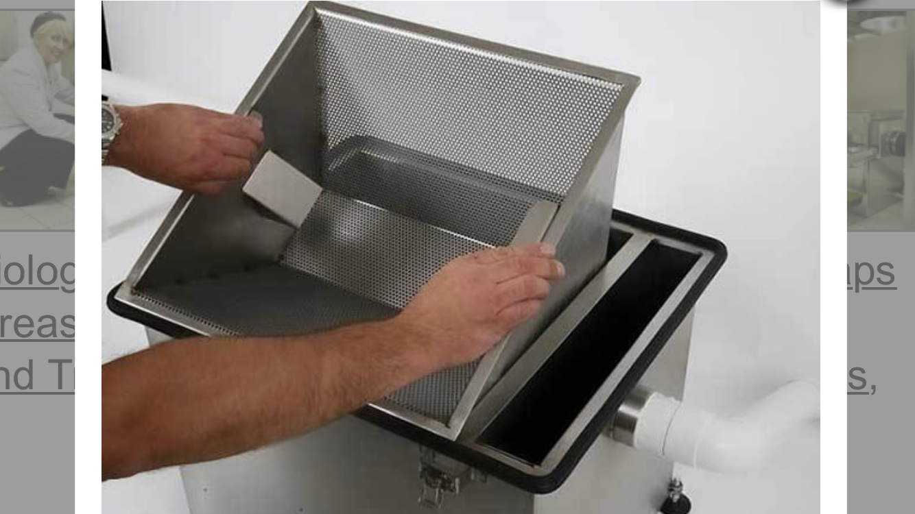

In my opinion the smaller ones are great and easy to maintain, the big ones are hard work and the internal ‘in the floor’ ones are just plain stupid.
I just got this off google, this design seemed to work the best with a big basket on the inlet:
