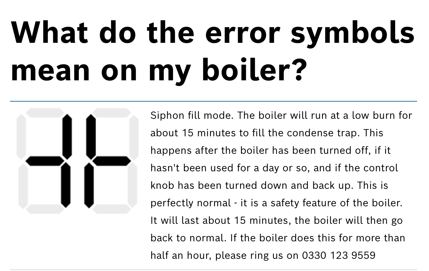

Symptoms changed - CH not firing up at all now even after an on/off cycle - Boiler detects demand for heat then flashes between symbol -11- and water temp. :( Haven't touched anything yet as the missus in no rush as weather is warming up. :)
If the symbol looks like x2 letter T’s placed on their sides, then this is the siphon fill mode and will stay in this for 15 minutes and nothing will override it.
