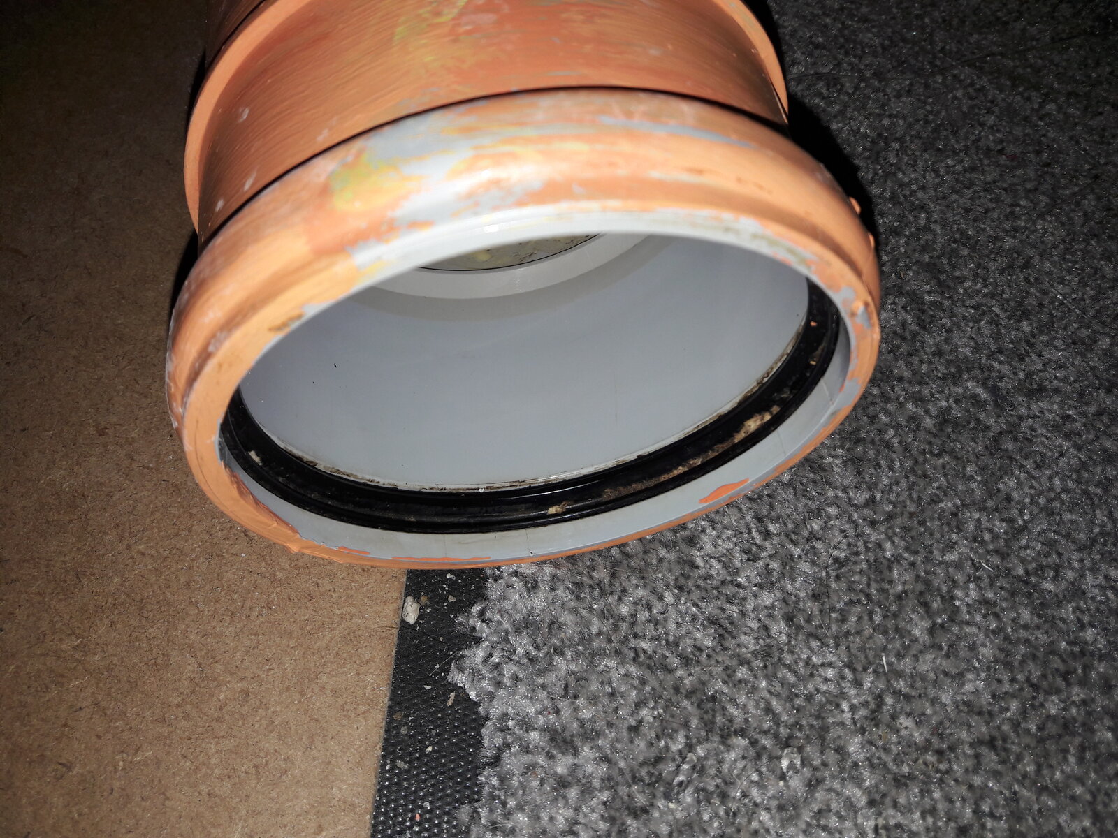

Hi all. Son just bought new house and need to adapt new toilet pan (upstairs bathroom) to old Bartol Grey waste pipe. Bartol is weld pipe approx 4.37" o/d-4.14" i/d (metric 112mm o/d -105mm 1/d) and would guess with this being a thicker pipe it's about 3.5-4mm wall thickness.
Have bought a McAlpine flexible pan adaptor see link https://www.screwfix.com/p/mcalpine-wc-f21r-flexible-wc-pan-connector-white-110mm/8145p but is fractionally too tight to go inside. If I just push the the rubber end (ribbed seal) it's a bad fit - pushes itself inside the pipe and will not allow the solid end of pipe to slide inside.
It's in a pig of a place inside the eves with a 20' run and a hard right angle in the middle. Pipe was sitting at 17degrees!!!! so need the flexi to drop down to get the angle back to 1/2deg. Got no other options here than to work with what we have.
Any suggestions or alternative fittings to mate these?

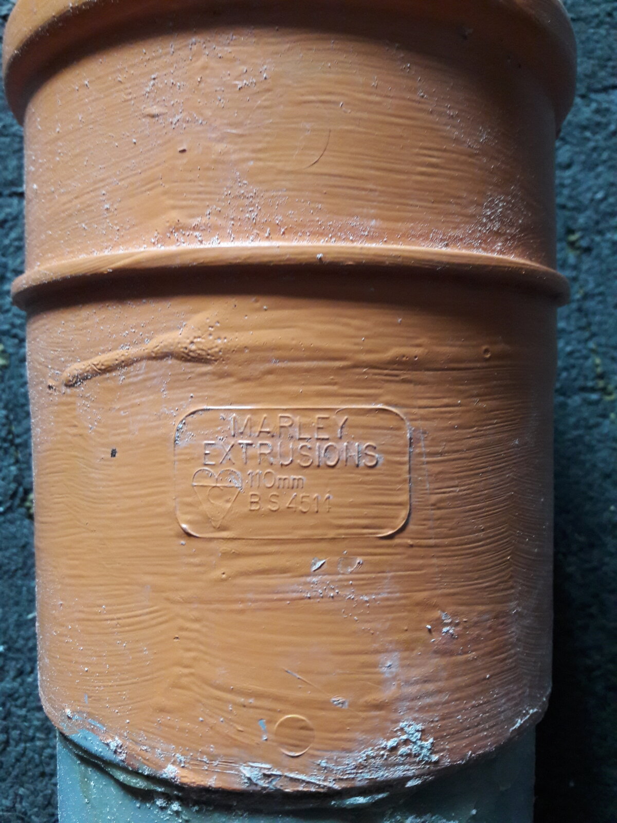

Neither photo shows soil connection, and is Marley, not Bartol. Is it the grey part with the rubber in? If so, you’ll need a piece of soil pipe to make a decent fit.

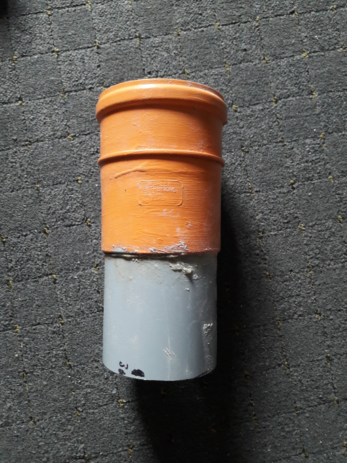

It's a *******ised set up. Grey pipe is stamped Bartol, orange painted fitting is Marley 110mm. As stated, but maybe not clearly, the inside of the Marley fitting has been ground out from 110 to 112mm to slide onto the Bartol pipe be approx 20mm then hot melt used for glue.
The set up we just removed was the one in the pic coming through the wall and the pan fitting into it.
The Bartol pipe is (sizes in original post but I'll stick to metric for this post) 112mm o/d and 105mm i/d with a wall thickness of 3.5mm.
I need a fitting to allow us a similar set up ie 110mm for the pan (I will be using as per pic a McAlpine flexi pan extention/connector from the inside of room through to the grey pipe in eves to connect to the 112mm o/d of the grey Bartol pipe.
So what I am asking, and there must be a few of you guys who have encountered this prob in your travels, is: "what did you do to sort it...?" Or am going to have to butcher an identical Heath Robinson set up again?

Thats a 10" section that went through from eves-bathroom and the pan connected to it but as stated the run was 17 degrees so the connection has to start obviously in the bathroom-through wall and then drop via flexi pipe and connect (somehow) from 110 to 105mm onto the grey soil in the eves thats being reset at 1-2degrees.
