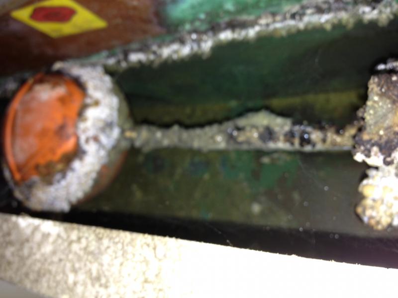

I need to smash the top panel of the door in - Will have to wait till weekend due to the time I get home from work. I managed to take a picture of the inside however. Not sure if this shows anything. Looks rank though.
Hi guys - I have managed to get the panel in that was blocking it and now have clear access to the tank. This is what I see at the moment - should the water be a concern as it is?
Do I still need to get into the other part of the tank to fix the overflow problem or can I fix this here?
cheers
It looks disgusting. You are bathing and washing up in that, possibly even cleaning your teeth in it.
I would at the very least drain and scrub it out, sponge it dry and wipe round with bleach, including the float, and fit a new valve.
If it did not already have a close-fitting plastic lid, buy or make one.
We are expecting that the valve is at fault, so fitting a new one should cure it.
Buy a Pegler Prestex Part 2. Note the white plastic bridge on the top which prevents contamination of the water.
