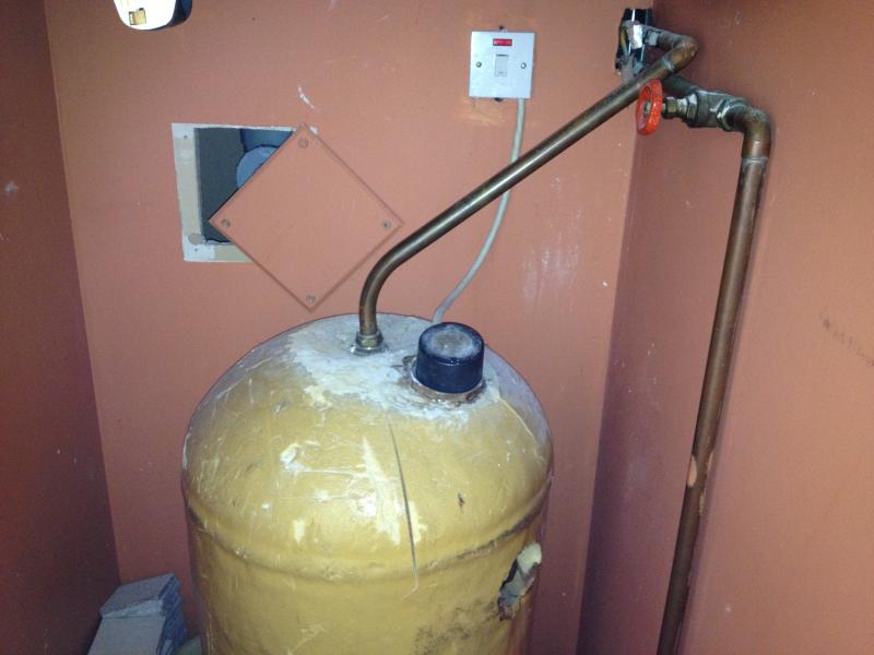

It is a vented cylinder so no help there.

Full apologies, I'm not sure what I was doing with the photos. I thought I had done the right thing by allowing general access to my photo album but obviously not. Anyway, you have said that the boiler is not vented so that's a dead end, and thanks for that.
The other flats should have the same boiler but I'll need to check.

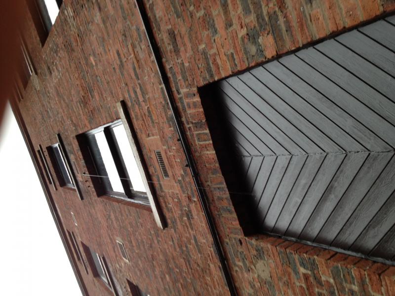

It's got to be an overflow from a WC or tank on the floor above how many flats on that floor?
There are 5 flats on second floor, 2 are discounted as the overflows exit above the next flats. You would have thought that it would be easy enough to trace but flat owners say they can't hear any water running when the overflow is leaking. Thanks for posting photos.

Just because YOU don't have an unvented cylinder does not mean that those above you don't! I am not quite sure the relevance of that picture. We would need pictures of each of the cylinders! Their location relative to the outlet would also be a very big clue too!

The log of WHEN it flows will perhaps be the most useful. I don't see why being a tenant makes any difference unless it is just that you are not wanting to go to the trouble! Sorry, I should have explained that I'm the landlord and this is a holiday let so a bit difficult with the log but yes, that would be best solution. Nevertheless, our guest at the moment says that the overflow goes when fewer people are in the block of flats. I took my plumber to the property last night and despite what the factors say he thinks there is a cold water tank in the roof space. The considered opinion is that when people are out of the block of flats (less use of water) the cold water tank fills up and overflows. This would explain the constant stream of water over the New Year period when people were away. My plumber managed to gain access to all the flats last night and he confirmed that the overflow leak was not coming from the flats as eg the overflow from the toilet was fed into the pan and then through the waste pipe. So, back to the factors as I'm not allowed to touch anything that is communal.
Just because YOU don't have an unvented cylinder does not mean that those above you don't! I am not quite sure the relevance of that picture. We would need pictures of each of the cylinders! Their location relative to the outlet would also be a very big clue too! All boilers are the same as mine.

No cold water tanks in each flat. We originally thought that all sources of water use were from a rising main but I'm told that it is unlikely for the feed to the copper hot water cylinders.
It is waste/soil pipes from the other flats behind the wall.
Hmm, it should have cold water tank in there somewhere, as that cylinder is vented, what about cold feed to bathroom? Where that come from?

I would be normal to have a cold tank on the loft/roof.
Your plumber could have looked at that as long as access is available.
But an overflow from a roof tank would never come out of the wall at first floor level.
