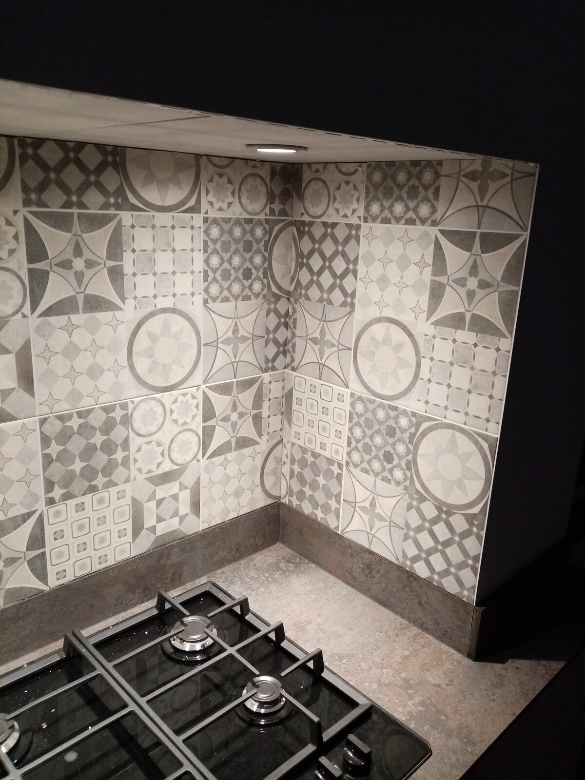

Do i grout or silicone the internal corners?
It's above hon so no water will be in contact, just steam obviously.
Grout imo.
Many tilers disagree but I never had grout cracking in corners.
I believe the trick is to mix it slightly ticker than normal and of course use a good quality one.
I understand that many do not agree but this has always worked for me.
Cracking not the issue getting grout free of grease is, soaks up the grease and discolours easily.
