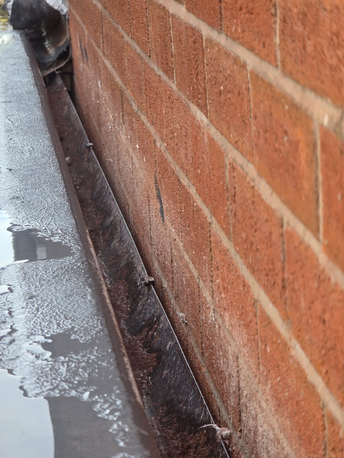

What's going on with that bonkers gap by the wall? It can't be where the water runs off, surely?
Yes that's where the builder puts the guttering for the water to run off. This is the picture of the guttering. Hope that's okay as I don't want another headache

OP,
As above, there's a few things wrong with the GRP, the flashing & the gutter.
There's a guy called "fixmyroof" on you tube - at least you would get a good example from his GRP video?
Whatever, check out your neighbour's pitched roof?

OP,
Ok thank you for the youtube channel, I'll check it out. The builder installed wall trims (and then covered it with lead flashing, not sure why) and the gutter trim on the gutter side to allow the water to flow down to the gutter.
