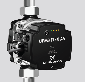

I installed this as part of an UFH Manifold circulator. Can press the button to change the speed between three speeds. But I see now that I can change the way it works and it should be in Constant Pressure mode for UFH and it isn't. After reading the manuals, it says to press the button for 2s to g to settings mode. That doesn't work. Nothing changes, just switches to the next speed.
I then found that there is a settings lock and tried holding the button down for 10-15s. But again, nothing changes. It seems that the pump is locked in a mode where I can change the speed and not the mode. Anyone else experienced this. The pump is 2 years old and not used much. Whatever I do, I seem unable to unlock it.

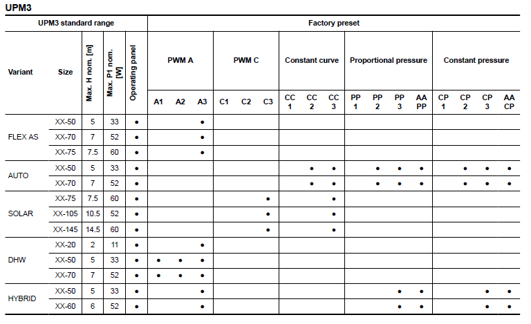

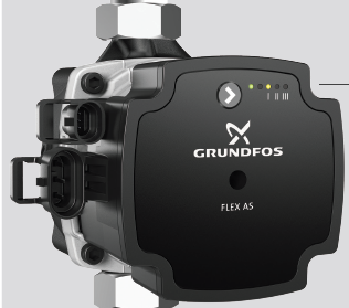

I think there are two different versions of UPM3 Flex with different instructions. Does your pump look like either of these.
Having said that, I think the following table shows Flex version doesn't have a Constant Pressure Mode.
mine is not actually identical to either of these but more like the top one.
I finally managed to speak to Grundfos!! Apparently all the UPM versions are what they call OEM and most are not programmable without the digital cable attached and are designed to be controlled fully by the heating control system using pulse modulation. Its just really annoying the way all the literature tells you they can be manually programmed.
I think mine has a constant pressure curve - which is actually PWM A so is designed for UFH but the control system will manage it. I haven't decided yet on what control system to use so have none. There seems to be nothing anywhere that explains the difference between the various pumps and pump families and if you want a fully manageable one then you buy the UPS3 which can be fully configured for whatever purpose.
Problem is that Grundfos still think that all UFH manifolds are sold as a complete solution with the control unit as well and don't seem to have realized that the world has moved on and there are many independent smart heating systems that people want to pair with their UFH manifold and thus need a bit more control and flexibility. In future I will only buy the UPS3 or equivalent.
