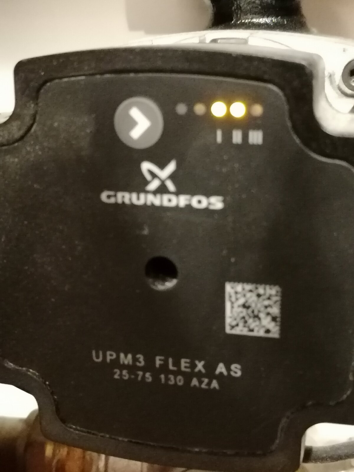

I have a Grundfos UPM3 Flex AS pump for my UFH system.
The lights on it are as follows:
LED 1: Flashing green maybe every second
LED 2: off
LED 3: Solid yellow
LED 4: Solid yellow
LED 5: off
I understand the yellow LED's indicate the speed/performance setting it is set to and I can change this by pressing the button on the pump. So it is currently set to medium performance.
What I don't understand is the flashing green LED, I believe this should be solid according to the manual.

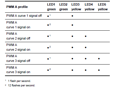

There are two versions of AS Flex, and the lights mean very different things.
Do you have a photo of yours? Or at least do you know when it was installed?
The change seems to have happened in mid 2020.

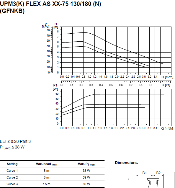

The newer version of the guide is below. If you have the newer model, the flashing once per second is totally normal, and simply means there is no external controller. The two yellow lights also mean your pump is set to curve 2. Because there is no external controller, the pump will run at the maximum speed for that curve. I can post the curve if you are interested!
Oh that's helpful thanks. I do not know exactly when it was installed. We moved in March 2022, hard to say exactly when the UFH was installed during development. Maybe sometime in 2021.
Definitely interested in seeing the curve. Do you have a link to the manual for the newer AS Flex model?

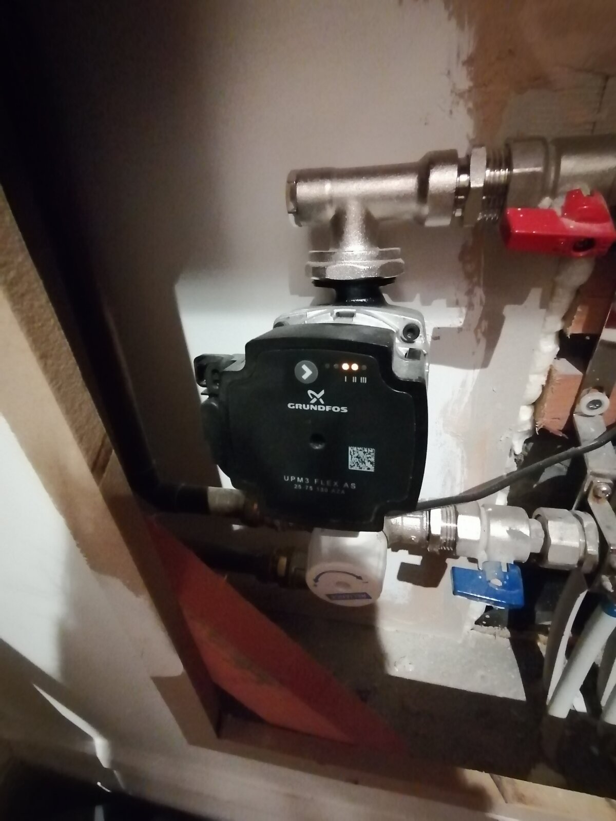

Here are a couple of pics:
Yours is definitely the newer model. Link to Grundfos documentation below. Go to page 2 and you probably want Data Booklet (current version), I&O instructions and Flex AS Quick Guide. The first two are generic to the whole UPM3 range. Page 1 has the earlier versions.

Curves below are taken from the manual.
