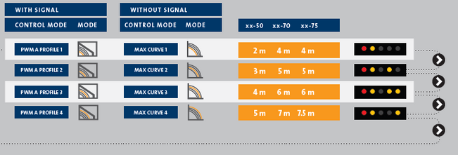

When I push the button I get:
Red, yellow, off, yellow, yellow.

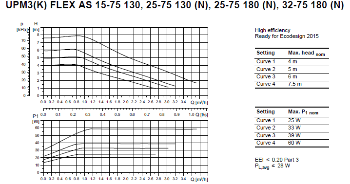

Something just popped into my head. Looking at the quick guide you posted, you get those same lights whether it has the external control or not. So I think it's safe to say that your pump is set to "Max Curve 3", which is 6 m head. When there is no external control to vary the speed, the pump runs at max speed for that curve, all the time. My best guess would be that the two yellow lights you normally see show it is running between 25% and 50% of the maximum power for the pump (60W), so somewhere between 15W and 30W. Knowing that isn't particularly helpful, though, but you can try and correlate it with the curves below.
When there is no external controller this pump works as a very basic pump with four fixed speeds. There are no other modes like Constant Pressure or Proportional Pressure, and no accurate way of displaying its output. So really, to go back to your original question, there is very little you can glean from the settings.
These are the curves. I don't know if you've seen them.
That's very interesting, thanks. I had seen the curves but not really studied them. The sight glasses seem to show the flow rate at 1.25 l/m, which is 0.02 l/s:
This seems very low! I've made contact with someone at Gundfos now, hopefully they can shed some light next week. I'll let you know what they come back with.

Its difficult to see exactly what pump you have got but it may be just a basic constant curve (CC) but these pumps operate in constant pressure (CP)
fashion up to ~ 0.8m3/hr (13.33LPM) so if the total of the flow meters is < 13.3LPM the pump is effectively operating in CP mode.
Logically?, then you might think that one green+oneyellow would be set to 4M, one green+two yellows= 5M, (your setting which seems reasonable) one green+three yellows=6M and one green+4 yellows=7.5M. but you don't seem to be able to select these options?.
Anyhow, for the moment note the flow meters and if erratic, maybe try another combination of the LEDs, flowrate/loop should be ~ 2 to 3.5LPM and are adjustable.

It looks like this pump was updated in mid 2020. The speed options and the meaning of the lights changed. So make sure they know you have the earlier version.
