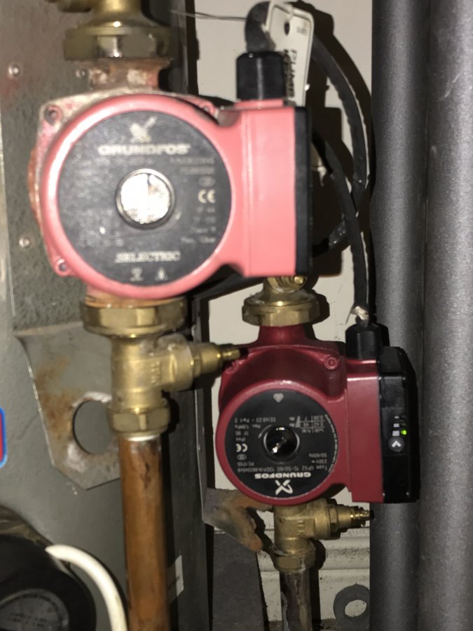

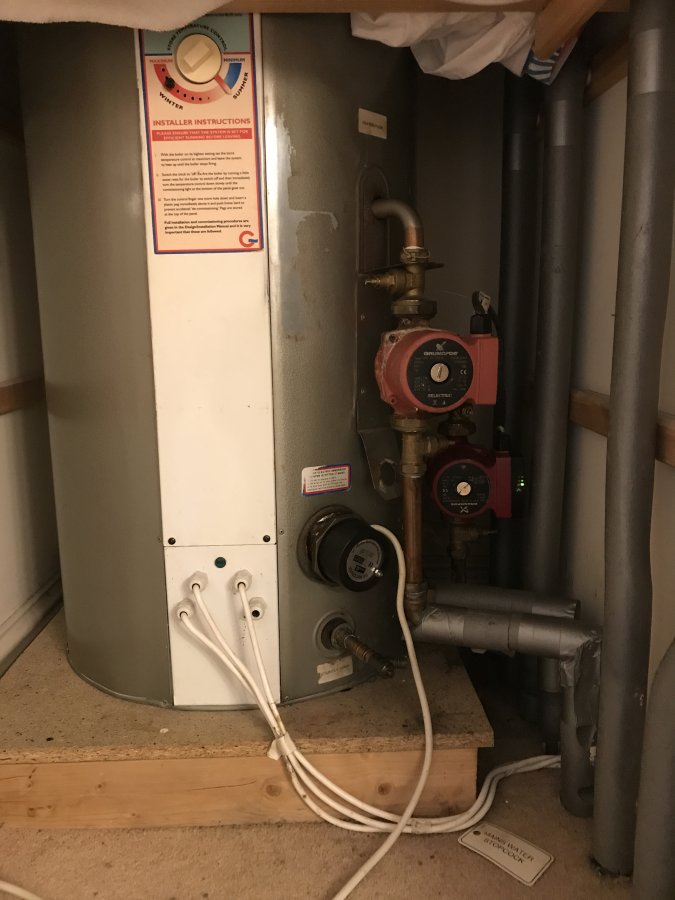

Ok, here you go.
Hot water pump is one at the back, the light was out when it wasn't working.
Boiler just goes into ceiling.

You have a thermal store! That can complicate matters.
You dont say under what conditions the boiler overheats?
Is it WHILE running? Or immediately it shuts off?
Normally a pump is wired to the boiler to provide an over run when it stops firing. With two pumps it may well need a relay to provide the over run.

The boiler pump is controlled by a delay timer in the boilermate, no neon light on the pump then it is either in a delay start or the store temperature has been reached.by switching the mains on/off the delay will be over ridden.
The delay timer could be intermittently defective,not always powering the boiler pump resulting in glowworm overheating .Although the boiler pump neon is illuminated this does not mean 230v is being supplied to the pump.
