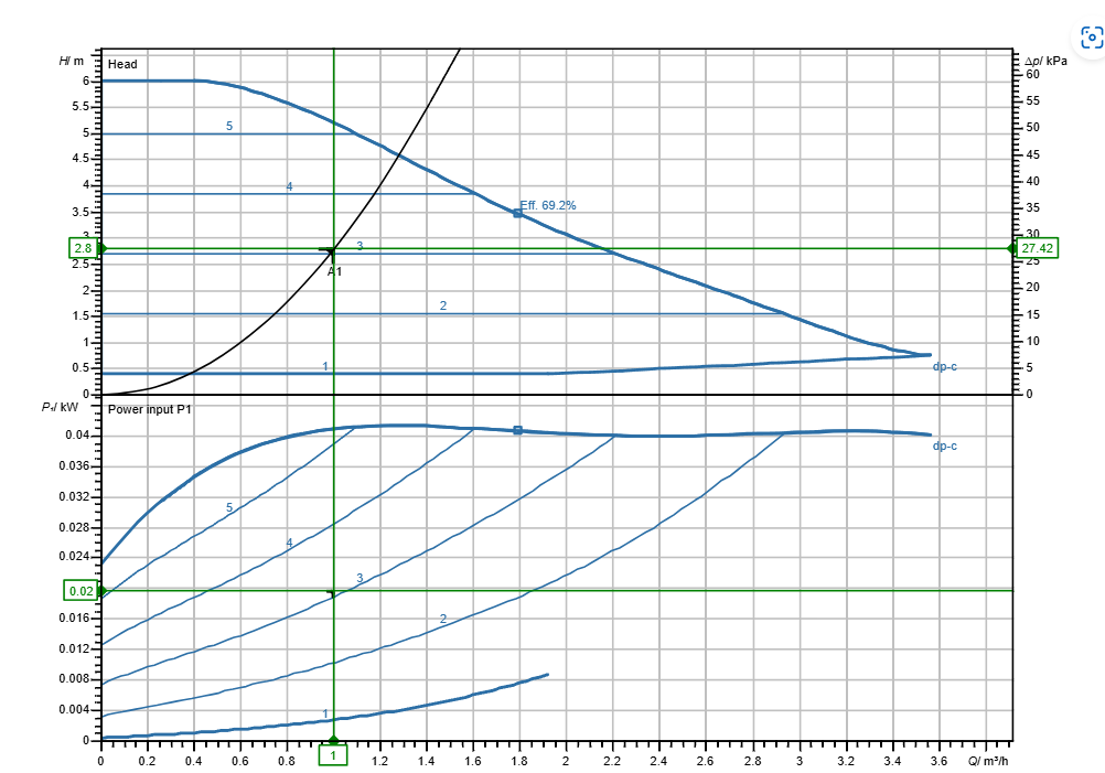

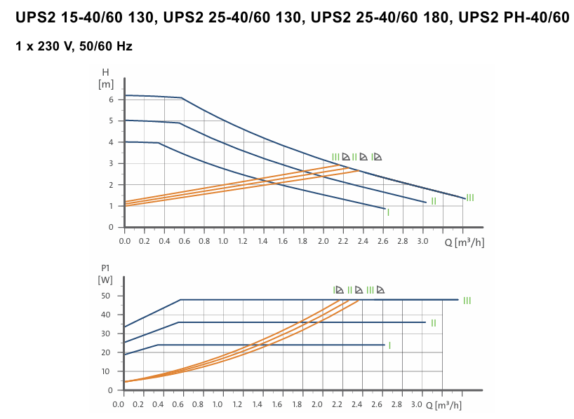

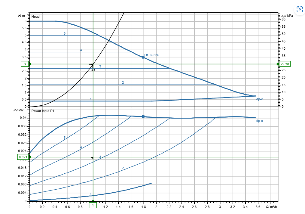

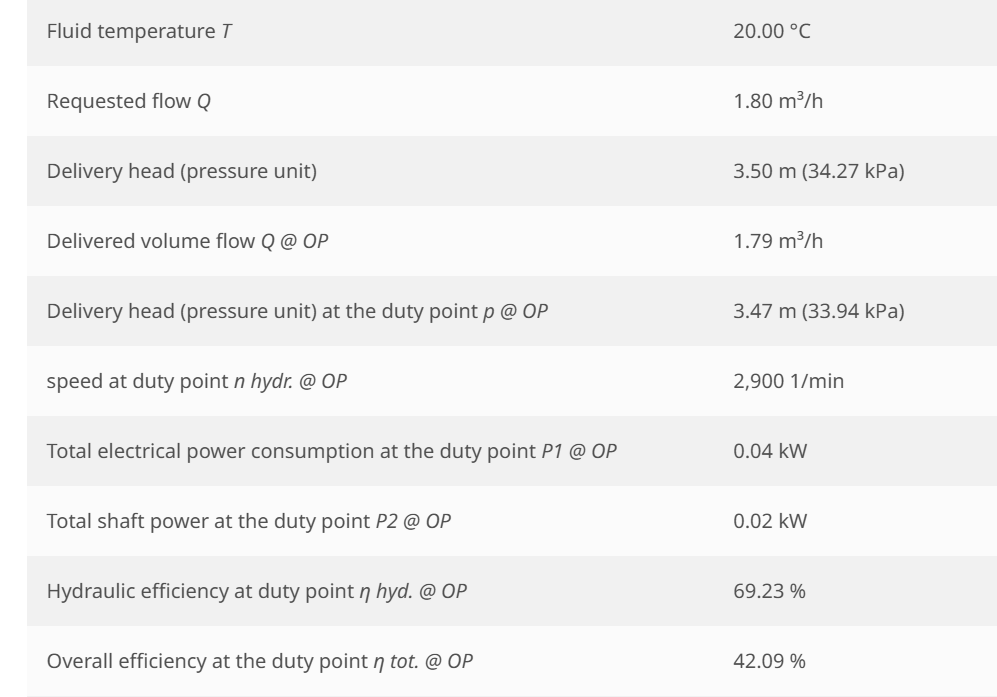

They all have the same/very similar efficiencies, the UPS3, above, on CP1 at 3.0M & 1ms/hr (16.7LPM) flow consumes 22W, my Wilo Yonos Pico 6M would consume 21W. Unfortunately, the UPS3 (& UPS2) do not display the power consumption, most, now, display the flow and the power consumption.
