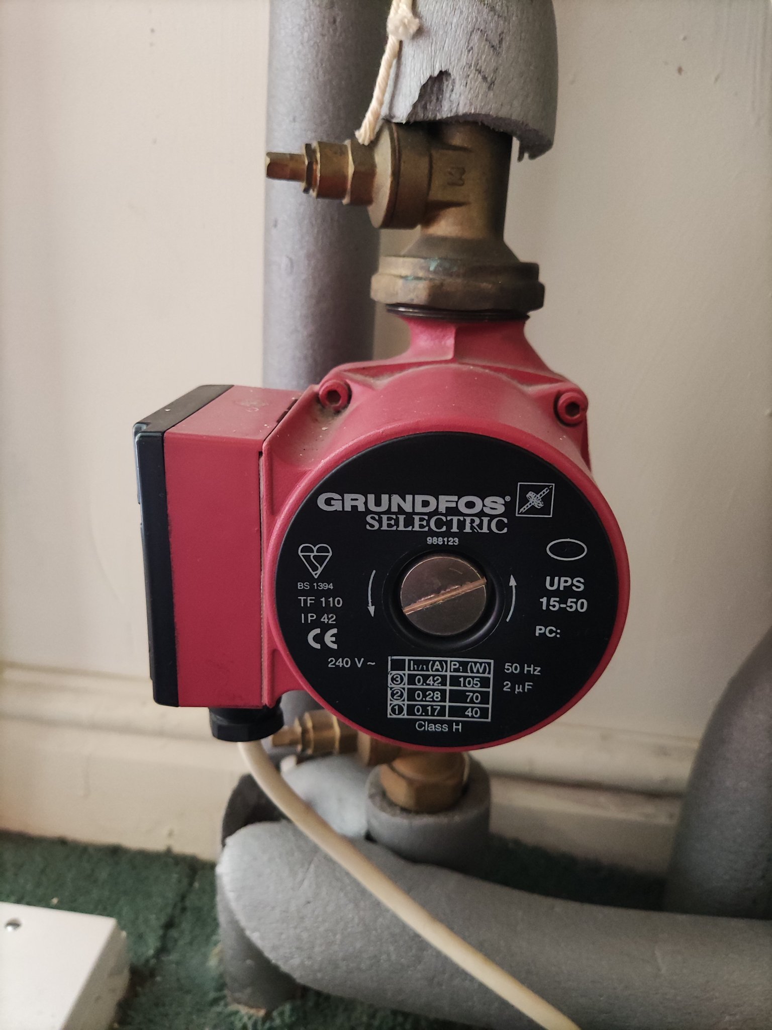

Hi,
I have an open-vented central heating system with a Grundfos Selectric UPS 15-50 circulation pump (photo attached).
The electrical supply intermittently trips when the pump is connected and running. Sometimes it runs normally for a while, but then the MCB trips and occasionally the RCD also trips.
I have checked by disconnecting other components and the problem appears to stop when the pump is disconnected, so I suspect the pump may be the cause.
The pump is not seized and appears to run. Could this be an internal electrical fault (motor/winding/insulation), and is this type of fault usually repairable or is replacement the better option?
If replacement is recommended, what modern equivalent would be suitable?
Thanks for any advice.
It’s a common enough issue with those pumps
Replacement usually needed
It'll probably show a low reading if you you IR test it
I had a Grundfos Selectric UPS 15-50 which failed a 2-3 years ago and I replaced it a Grundfos UPS2. It's been fine. There's now a UPS3, which I wouldn't go for, over-complicated and possibly unreliable. For years I swore by Grundfos, but I believe there are now plenty of good makes around. I'm a DIY-er but I've heard on here about, Wilo, DAB Evosta, among others. Maybe somebody can add to the list.

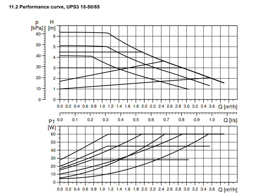

For anyone with a OV system, if installing a new circ pump, its well worth taking a photo or noting the original pump details and mode/settings as some systems are quite sensitive and can suffer from pump over/air ingress. I have seen more than one reference to the UPS3 which is supplied in constant curve mode at speed3 causing havoc with these systems, sometimes, like below, where the installer simply doesn't change the settings.
Good points. I don't remember seeing that thread at the time or I'd have stuck my oar in! Amazing the installers didn't try turning the pump speed down. My rule is use lowest speed at which the system works. Confirms my suspicion of the USP3.
The UPS3 is a giant of a pump, 60W vs ~ 35/45W for other 6M pumps, also, its constant curves are, in effect, constant pressure curves so will still maintain a 6.2M head at over 19LPM but changing to CC1 will give a more reasonable setting at 4.2M or CP2 will maintain 3.0M, so not really the pumps fault.
I believe the UPS3 has high efficiency, perhaps at the expense of lower reliability. I would prefer a cheaper pump and to spend a few ££ more a year on electric, as most of the extra electric power ends up in the water anyway.
