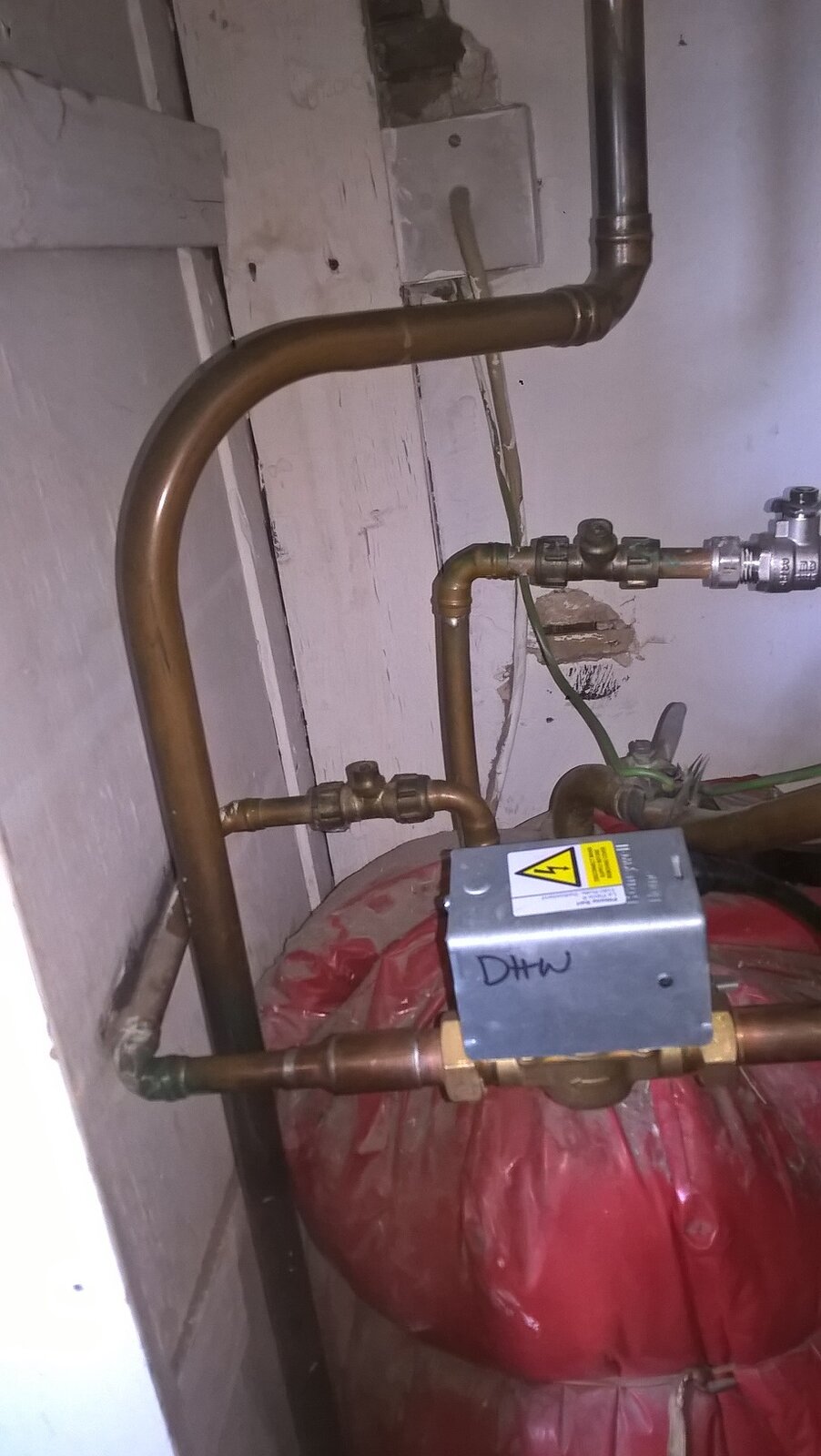

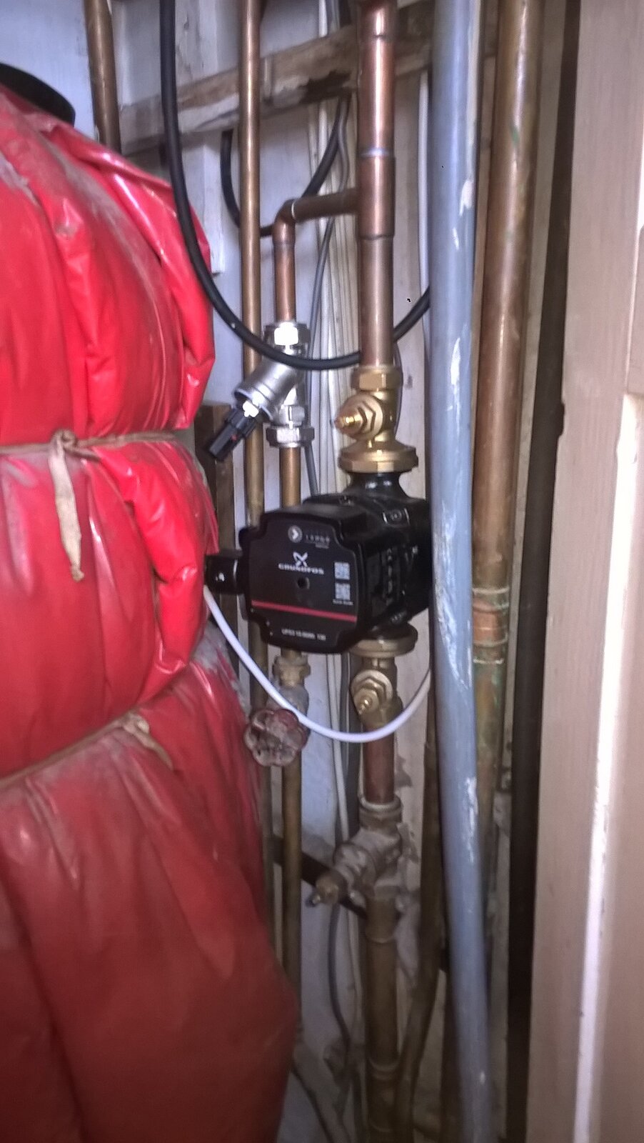

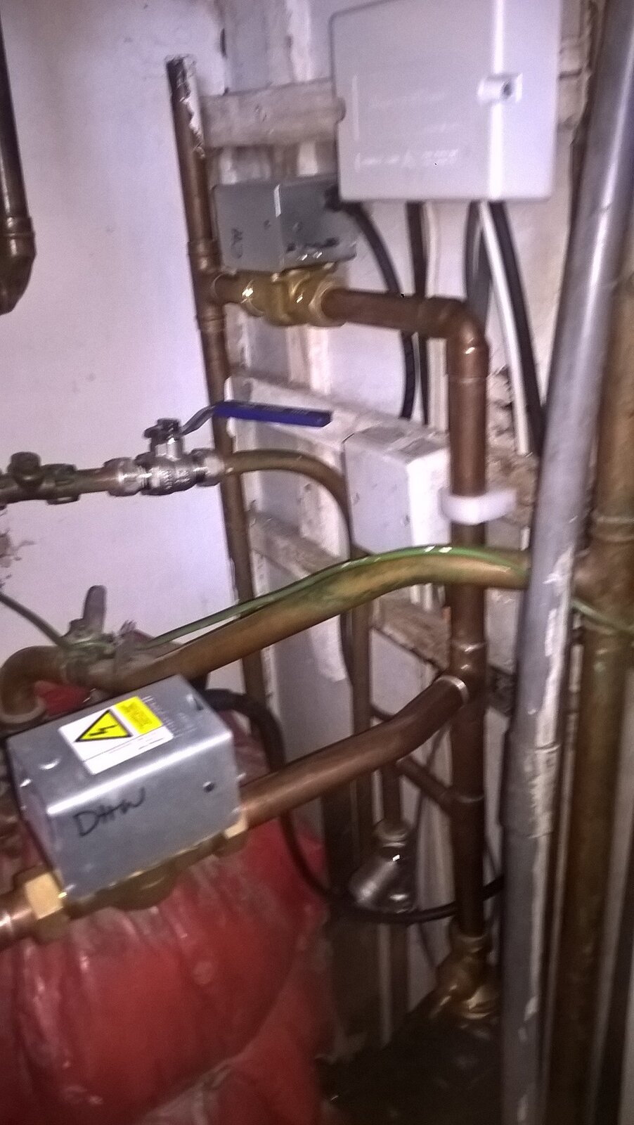

Can I take pictures of pipework ?
Don`t know if this helps but if I have 3 rads open, if I can get boiler to stay on, the system runs hot and quiet. If i open a 4th rad, the pipe above the pump starts making a cyclical `whooshing noise: 4-5 seconds whoosh, 4-5 secs quiet, repeat. Turn rad off, quiet again.
Just good will would have been decent of them to get you working.
However looking at the pictures. There are two air nipples teed in. Thus suggests to me thst air may have been an historic problem with this system. You say that the system worked with old boiler.
This is a common problem and story ive heard many a time and dealt with.
I think its an air lock and Id have a guess thst they didn't clean the system very well.
Once air has been purged 100% then it will work. A problem that your old boiler would have also had.
Thats my theory....
