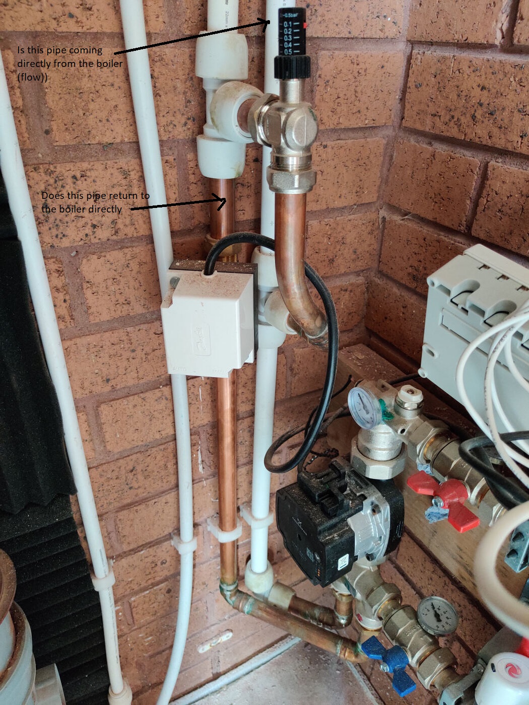

Glad you're sorted more or less now, there's another item that you might have a look at.
All gas boilers have a ABV(automatic bypass valve), its internal if the boilere is a system one but external if, like yours, a heat only boiler with a externally mounted pump, its purpose is to circulate water around the boiler and through the heat exchanger for a few minutes to cool/prevent it from overheating after the zone valve(s) close and the burner shuts down. It should look something like the one at the top of the photo and will have a numbered index which represents the presssure that it opens at, the idea is that it will partially open when the pump pressure rises slightly after the zone valves close, check its setting, if its set to < 0.35/0.4, check the pipework at either side, it should be cool, then with all zone rad valves open and the boiler firing, keep turning the setting knob very slowly clockwise until you just feel the pipe getting hot, stop then and maybe just turn it back antclockwise say a 1/16th of a turn or so.
Ignore the txt in the attachment, I wrote that when assisting someone with a ABV problem

All gas boilers have a ABV (automatic bypass valve), its internal if the boiler is a system one but external if, like yours, a heat only boiler with a externally mounted pump, its purpose is to circulate water around the boiler and through the heat exchanger for a few minutes to cool/prevent it from overheating after the zone valve(s) close and the burner shuts down. It should look something like the one at the top of the photo and will have a numbered index which represents the pressure that it opens at, the idea is that it will partially open when the pump pressure rises slightly after the zone valves close, check its setting, if its set to < 0.35/0.4, check the pipework at either side, it should be cool, then with all rad valves open and the boiler firing, keep turning the setting knob very slowly clockwise until you just feel the pipe getting hot, stop then and maybe just turn it back anticlockwise say a 1/16th of a turn or so.
Was the UPS3 a new pump that was installed by these people.?

You have an ABV, it is the silver item just behind the pump on your third photo in post number 11. Take @Johntheo5's advice but start with the ABV adjusted fully clockwise and the heating ON (perhaps not today!). Feel the pipe just below the ABV and turn it anti-clockwise until the pipe starts to get hot, then clockwise a quarter turn as he suggests....just a typo from him I suggest.
