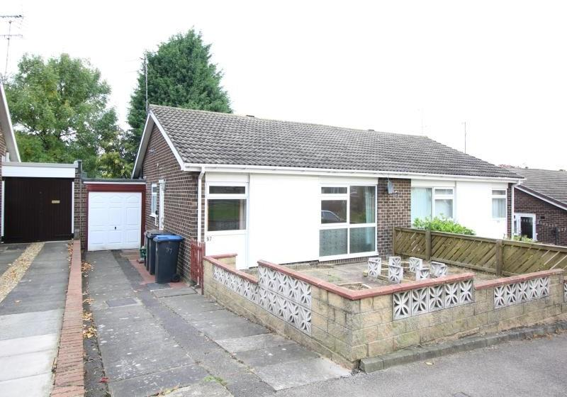

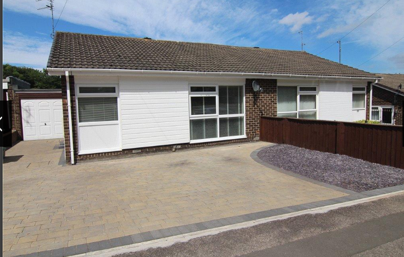

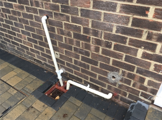

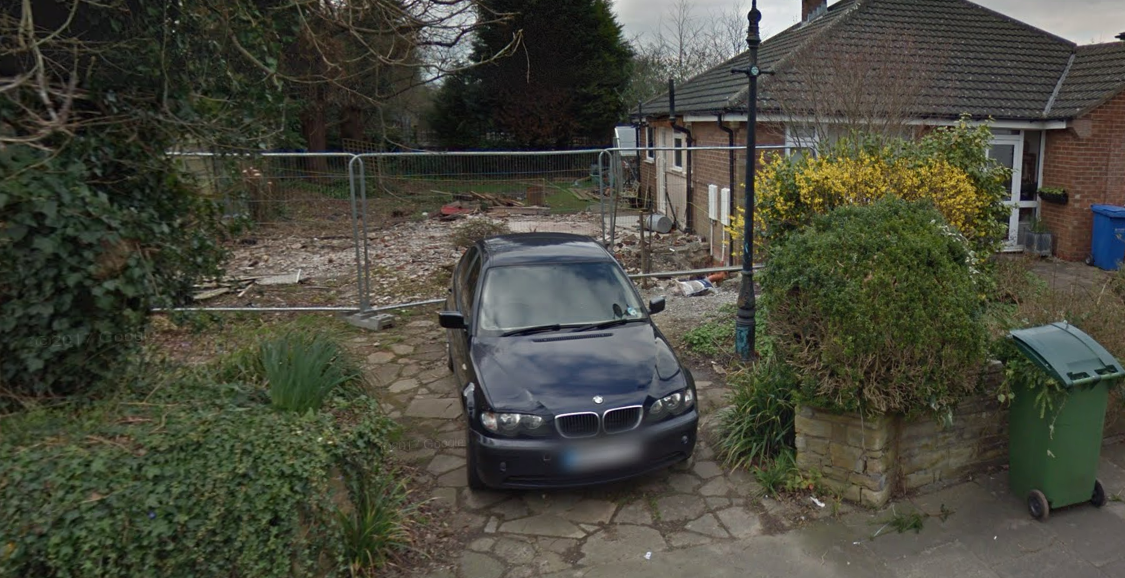

Sorry- I didn't appreciate this. I've attached photos. The down pipe/drain is up the side of the house and it appears that the block paving is sloped in that direction. The last photo is from 2016
Try the planning forum here - I'm pretty sure that PP would not have been needed, as it wasn't a case of paving over a new area, it was replacing/repairing/renovating existing paving.

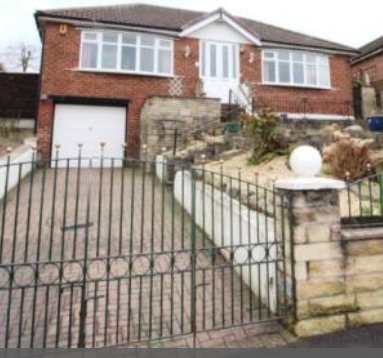

https://www.rightmove.co.uk/property-for-sale/property-60374167.html
This one needs "a little updating", also not finished off outside. But even worse, some of its land has been sold off so the "developer" could put a new-build slap up against it.

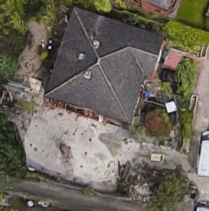

Here's a sat shot and streetview when the build was just beginning:
So, by comparison, if you buy this house you have bugger all garden or driveway, a house inches from yours, you need to renovate and it costs more than it used to before "development"....
