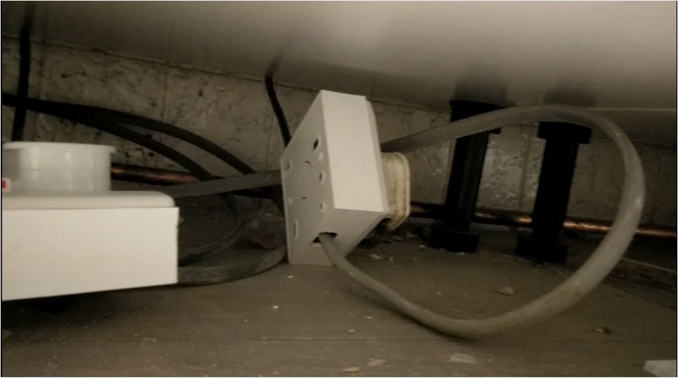

But if he is really a member of NICEIC, and he has really done this:
then they really should really chuck him out with no delay and no appeal.
[SAFETY]Breath-holding not advised.[/ADVICE]
Oh - and for the avoidance of any doubt - yes, I do state that any EIC he issued was fraudulent, because yes, I do state that that did not constitute good workmanship.
Oh boo, ENTER key is sticking. Lets see what it does now. And try again....
Quite agree- the workmanship shown is not acceptable from anyone who is being paid as an electrician. BUT (playing devils advocate here)
The cabling really shouldn't be flapping about in the breeze but it is in a location where it is unlikely to cause a hazard or get damaged.
The sockets should be fixed to something but again they are in a location where accidental damage of any sort is unlikely to occur.
So in terms of how bad is the job- it is utterly rubbish but not particularly dangerous or life-threatening. I'm sure there are many worse bodges hidden under and behind kitchen units up and down the country- at least he has used a plug and socket rather than a lump of terminal block wrapped in a carrier bag :).
I'm not trying to defend this character's work, by the way- just pointing out that due to the location it is rubbish work rather than dangerous work.
