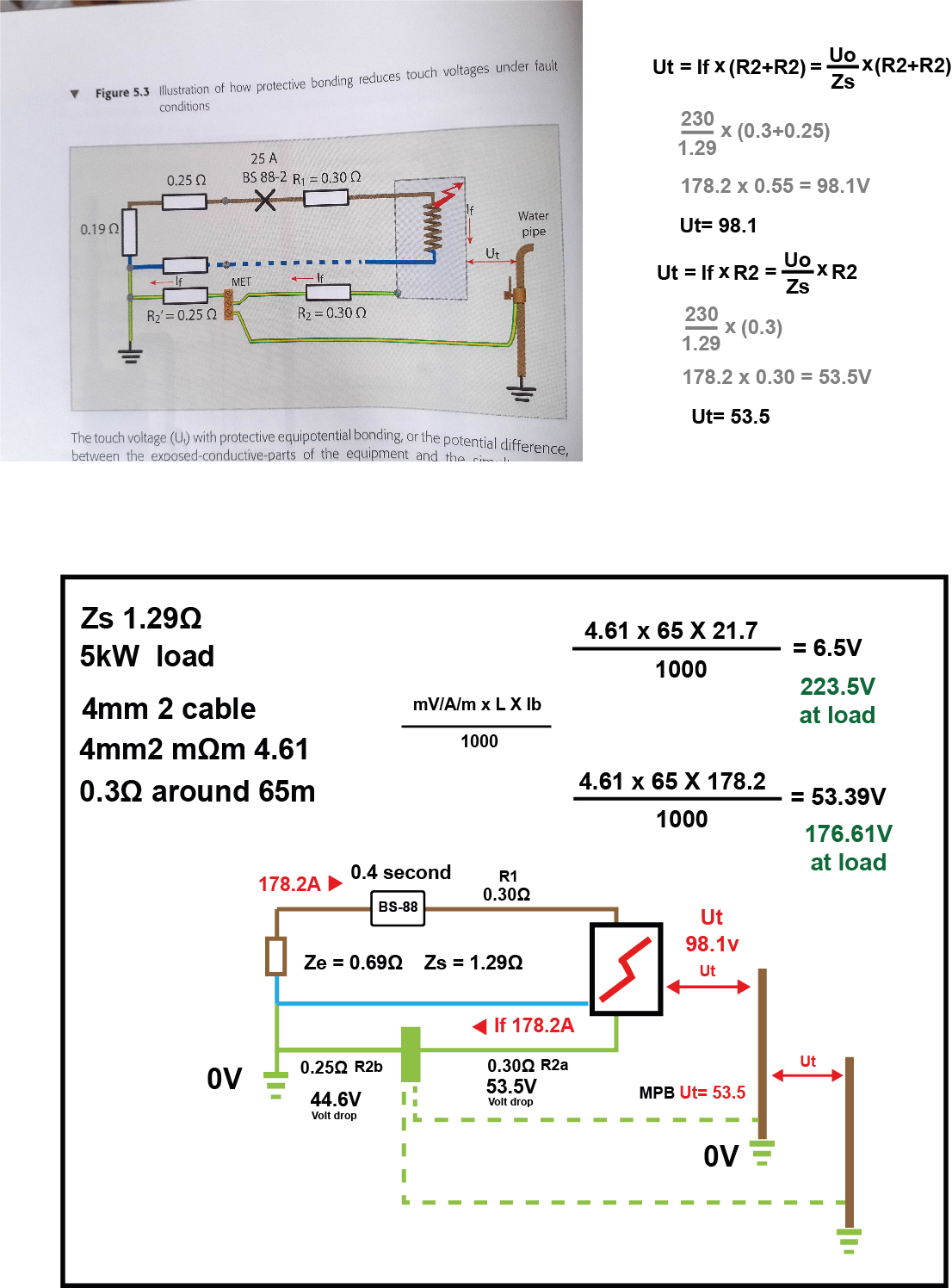

Guidance note 8 - Section 5 Protective equipotential bonding
Im getting a bit lost here.....
I have attached an image from the book, and my own version of the same image.... This section is about touch voltage and how that changes, if you add Protective equipotential bonding.
The basic premise is that, without bonding the touch voltage would be 98.1V, and with bonding it would be 53.5 V
So without bonding you are calculating the R2 of the CPC and the R2 of the means of earthing.
In this case 0.30Ω and 0.25Ω
With Bonding you are only calculating the CPC 0.30Ω
It seems to suggest that the impedance of the earthing conductor is no longer counted, as we have a additional 0V connection via the water pipe??
Im getting a bit lost here. A potential difference is between 2 point, so what voltage is the Exposed conductive part, and what voltage is the Extraneous conductive part.
Also It is seems to be saying the voltage dropped is the voltage that is appearing on the exposed and extraneous conductive parts as touch voltage.
But I understand voltage drop to be voltage 'lost' by the impedance of the circuit. So if you had a volt drop of 98.1 V you would have a voltage of 131.9V.
Any help in understanding this would be appreciated. Thanks
(I have guesstimated the cable size going of the R1+R2 readings)

The picture from the book is showing the earth fault loop path. The Zs is 1.29Ω The Ze being 0.69Ω. There is an earth fault on a resistive load (5kW) Which is sending a fault current down the CPC (0.30Ω) and down the means of earthing (0.25Ω) The figures next to the photo are the equations from the book which give the touch voltage (Ut) when no bonding is in place (98.1v) and the Touch voltage when it is ( 53.5Ω) The equations from the book seem to suggest that the means of earthing resistance (0.25Ω) is not needed in the equation when bonding is connected. I presume because a lower resistance earth path has been added

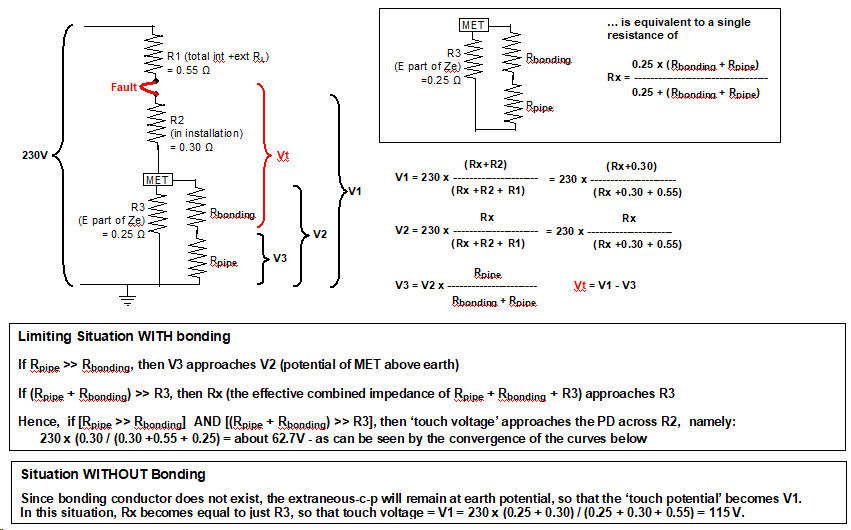

OK, first for the 'no bonding' situation ...
It is only because of their ('confusing') 0.19Ω 'internal resistance of source' that they get the touch voltage (without bonding) of 98.1V. If one ignores that 0.19Ω, then, on the basis of their (probably unrealistic for TN-S) assumption that the impedances of the L and E components of the 'external parts of the loop are equal (=0.25Ω) and their (definitely unrealistic, other than for 1mm lighting circuits) assumption that R1=R2 (=0.30Ω) within the installation, the 'touch voltage (potential of the exposed-c-p above true earth, the potential of the extraneous-c-p when no current was flowing through it) would be exactly half of the supply voltage, namely 115V. [note that I am, at least for now, ignoring the 5kW load]
In practice, that touch voltage would be greater than 115V because, for nearly all circuits R2 is greater than R1.
Kind Regards, John
Right, now to the 'with bonding' situation ... .

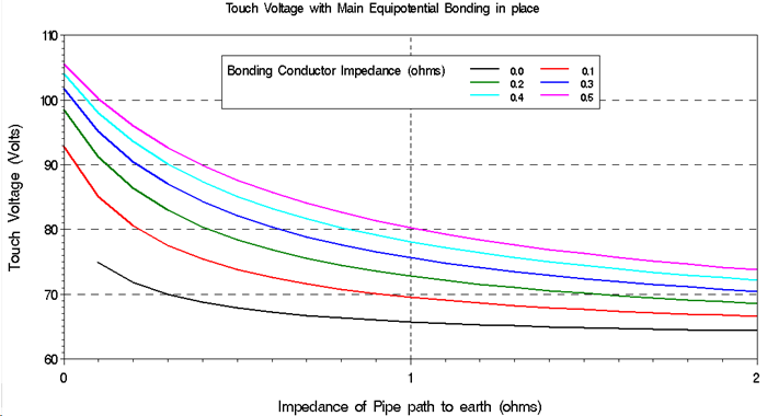

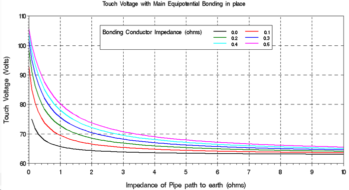

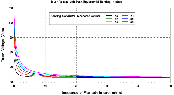

For any given assumptions regarding the "R1 and R2" both in the supply network (i.e. "Ze") and within the installation (Zs minus Ze), the touch voltage only depends on two things, the impedance of path to earth from the extraneous-c-p and the impedance of the bonding conductor - ironically two things which the calculations in GN8 do not appear to have considered !!
Again ignoring the 'confusing' "0.19Ω" and the (essentially irrelevant) 5kW load in GN8, if I've got it right the diagram below shows what the fault loop boils down to and how the calculations work out. Although it looks complicated, I've done my best to make it clear, and the maths is really extremely simple, even if it doesn't look as if it is - however, please just shout if you need help in understanding my scribblings!
The 'box' at the bottom of my diagram explains the 'limiting condition' which one approaches as the impedance of the extraneous-c-p to earth becomes increasingly large relative to the impedance of the earth component of the Ze. Following that are three graphs, showing this graphically (the first for extraneous-c-p impedances to earth up to 2Ω . the second up to 10Ω, and the third up to 50Ω.
Moving back to the without bonding situation, the very bottom 'box' in my diagram re-asserts that, without bonding, and using the (probably unrealistic) GN8 assumptions, the 'touch voltage would be 115 V -although, as I said, in practice more than 115 V, since R2 will nearly always be higher than R1.
Assuming I've got this all right, the bottom line therefore seems to be that, using GN8s (probably unrealistic) assumptions about R1 and R2 in the network and installation, main bonding will appreciably reduce touch voltage appreciably, down from 115+ V to a minimum of about 62.7 V (closer to {but never below} that figure as impedance {to earth} of the extraneous-c-p increases), but much less reduction in touch voltage if the impedance of the extraneous-c-p (to earth) is very low - say if it is much below about 0.5Ω.
I hope that makes sense and is all roughly correct. However, what I haven't yet had time to do is to look at GN8's calculations to see why they differ a bit from mine (their "0.19Ω", and maybe the 5kW load may well have a lot to do with it!).
