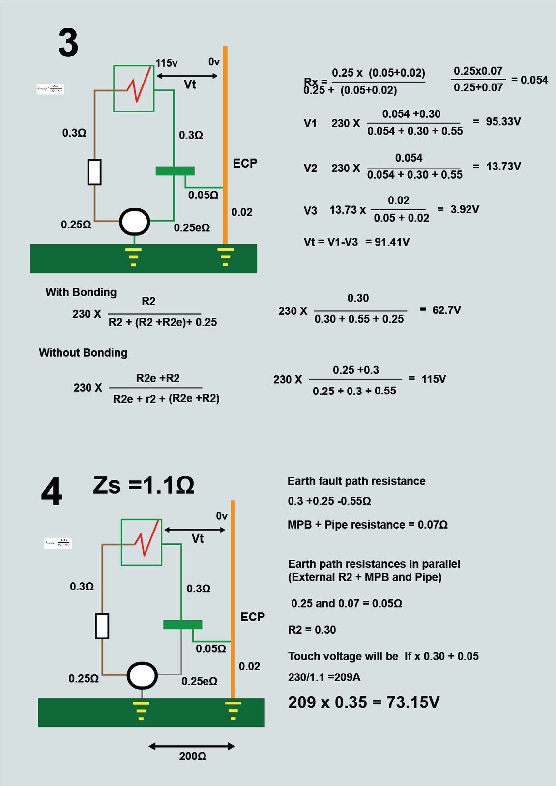

Rx is simply enough, it's just the effective resistance of (Rpipe + Rbonding in series) in parallel with R3.
The resistance/impedance of (Rpipe + Rbonding in series) is obviously just Rpipe + Rbonding - let's call that Ry.
We therefore have Ry and R3 in parallel. The 'long' way to calculated that is:
... but I think it simpler to use
Does that help?
Kind Regards, John

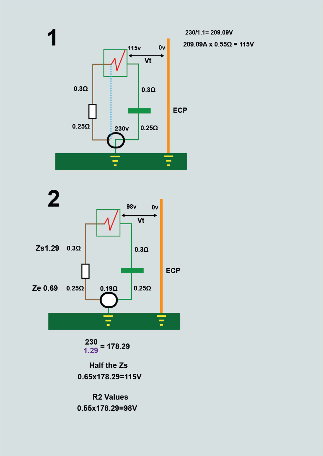

1 is just the very basic 115V at the point of a fault as all the resistances are the same. Edit 230/1.1 = 202.09A (not 202.09V)
2 is the calculation using half the Zs ( As we would do in the real world?), and also the values from GN8
3 is you values with some values for Rx
4 is with bonding added - Im trying to understand why the 0.25 external R2 is removed from the equation - Im was thinking it is a lower resistance path for the fault
But then you would have a high resistance return path to the transformer via the mass of earth.

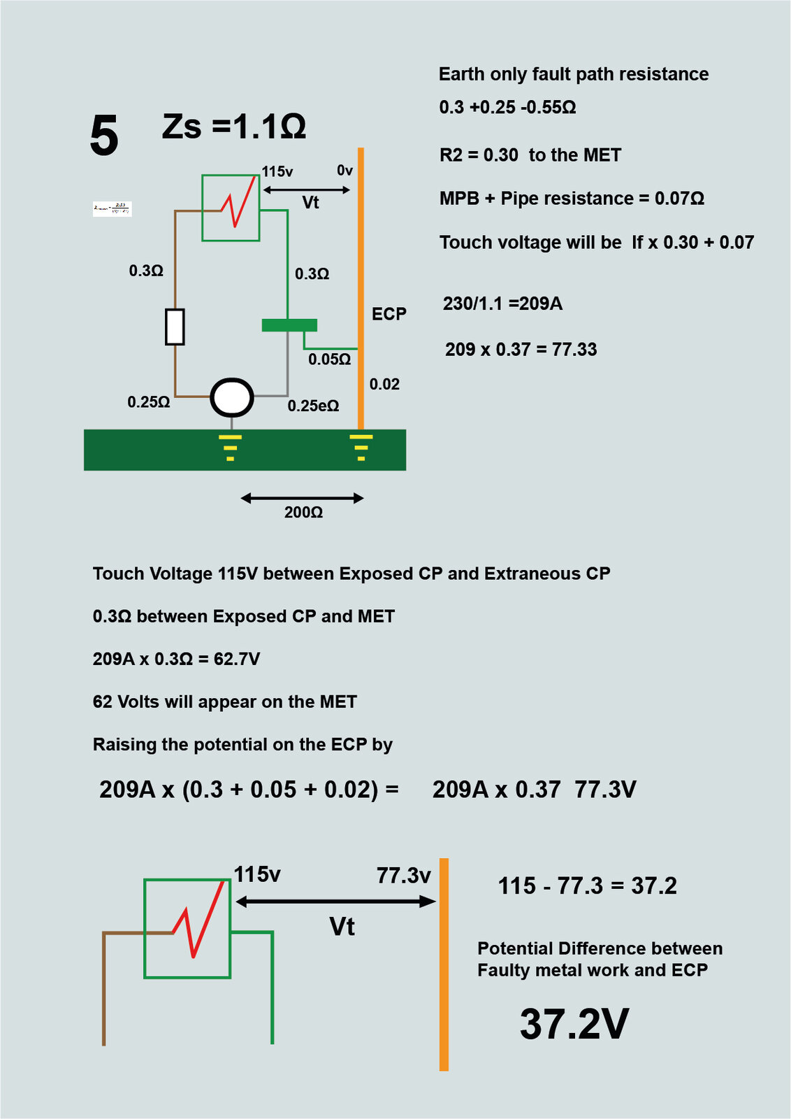

5. But all of these calculations have the Extraneous CP at 0 V, when it would actually (with bonding attached) rise to the potential of the MET,
So the touch voltage would be as shown.

OK, I'm going to take this is easy stages, first with your two simple ones ...
Yep, once the typo is corrected, that's all correct. You don't really need to work out the current and multiply that current by the resistance between fault and earth - since the resistances on both sides of the fault (0.55) are the same, the voltage at the fault will obviously be half the total supply voltage.
You have, perhaps unwittingly, raised an interesting point, which I (and probably many others) haven't really thought about much in the past - in that I am starting to understand the relevance of GN8's "0.19Ω".
Zs (or Ze) is the total impedance of the relevant 'loop' and we (at least, I !!) do not often think about the fact that the two 'arms' of that loop' (relative to where they join, at the 'truth earth' point) may not (indeed, usually will not) both have the same impedance (to earth).
Taking the example of the GN8 figures, as you have said, the total Zs is 1.29Ω and the total Ze is 0.69Ω. However, because the 0.19Ω (the 'internal impedance' of the source) is entirely in the leg of the loop which goes via the L conductor (which is not really apparent from the way you have drawn your diagram), that leg contributes 0.74Ω to the total Zs and 0.44Ω to the total Ze, whereas the other ('earth') leg contributes only 0.55Ω to Zs and 0.25Ω to Ze.
Thinking only of the total Zs or Ze is fine for calculating fault currents etc. but, as GN8 and you are saying, it is not enough in relation to calculation of touch voltages.
So, as you (and GN8) have discovered, assuming that the two arms of the loop have equal impedance, hence calculating touch voltages on the basis of "half of Zs" is not correct (but your/their calculation is). In other words, using the GN8 figures, the ~98V touch voltage would be correct.
[ of course, in practice, the two arms of the loop will each be closer to "half the Zs" than the GN8 figures suggest since, although the 0.19Ω is only in the L side, other than for circuits wired in 1.0mm² T+E, the within-installation "R2" (CPC) (in the other, 'earth' side of the loop) will be greater than the within-installation "R1" (L conductor) - so that the "half the Zs" approach to calculating touch voltages may, in practice, not be too far off. ]
Having got that straight in my mind, and thereby having de-mystified the 0.19", I will subsequently (hopefully soon!) move on to the rest of your scenarios!
Kind Regards, John

As I said, because I did not at the time understand what the "0.19Ω" was all about, I simply ignored it - but, as I recently wrote, I now understand it's importance/relevance. That means that your diagrams (hence calculations) for scenarios 3, 4 and 5 are all incorrect, because none of them include the 0.19Ω.
I'm afraid that means that you need to re-do 3, 4 & 5, with a 0.19Ω resistance/impedance included in the 'left-hand'("L", brown) arm of the fault loop in every case. Zs will then be 1.29Ω, and Ze 0.69Ω in all cases.
Again, my apologies.
Kind Regards, John

I think the problem (for me and, I suspect, many/most others) is that GN8 is almost being 'too clever' by introducing theoretical issues which are probably virtually never usable in practical real-world situations (other than by guesswork).
I think that the reason why I (and, I suspect, most others!) haven't really given much thought to the "0.19Ω" component of Ze that GN8 uses in its diagrams and calculations is that, in practice, we will never know what it is, and so will never be able to do calculations like theirs which involves that component of Ze.
In reality, all we ever know is the total Ze (or Zs), so all we can really do is to assume (actually incorrectly) that the impedances of the two 'legs' of it are equal (even though we know that the 'earth' side will actually have a lower impedance than the 'L' side, to the tune of GN8's 0.19Ω, or whatever) .
In other words, as you said at one point, 'the best we can usually do' is to assume (actually incorrectly) that the impedance of the 'earth side' of the Zs is "half of Zs". That will take us back to the situation in which we estimate touch voltage as 115V if R1=R2 within the installation (only true for 1.0mm² T+E) or, with any T+E larger than 1.0mm², >115V (e.g. 143.55V with 2.5/1.5mm² cable).
The only way one could do it strictly correctly would be if we could measure the loop resistance actually at the DNO's transformer (thereby measuring that 0.19Ω, or whatever) - but that is never going to be feasible.
Therefore, unless I'm still missing something, I would suggest that it's probably not very worthwhile (only of theoretical, but no real practical, value) for you to spend too much time worrying about calculations which involve a component of Ze like GN8's 0.19Ω, since you're never going to be able to do such calculations in real-world situations (unless you simply guess a value for that component of Ze !).
Kind Regards, John
Are you saying that although this 0.19Ω should be included for Ze and Zs, it should not be included in R1 for the Volt-drop calculations?
More-or-less. As I've said, it is part of Ze and Zs (and therefore is implicitly used for any calculations involving Ze or Zs), but not a part that one can measure separately (one can only measure the total).
'Voltage drop calculations' as usually done, relate only to voltage drop within an installation (i.e. from the 'origin' of the installation), and therefore would certainly not involve the "0.19Ω" part of Ze, any more than it would involve the part of Ze (0.50Ω in the GN8 example) attributable to the supply cables upstream of the installation. VD within an installation (which is what one usually measures/estimates" is entirely due to the "R1+R2" within the installation, and does not involve any components of Ze.
