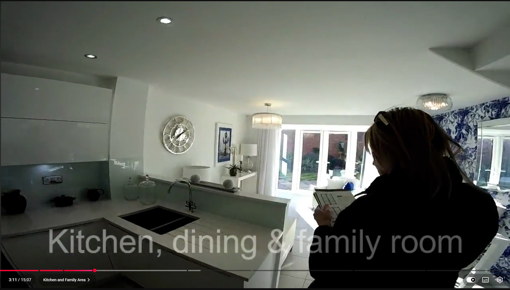

Scenario: We're looking to install a new kitchen, and change the kitchen layout. Our current unit has the sink unit come out from the property side wall at 90 degrees into the room. The water main comes through the block and beam floor directly under the sink, at a position approx 1.2m from the wall of the property.
We want to get rid of this sink arrangement, and run the units down the full length of the room. This would leave the existing cold water main and stop top poking up right in the middle of the floor.
Our floor construction is block and beam, with 150mm insulation and then 50-75mm screed on top.

For anyone else looking at this, to give you an idea of my situation, this is a capture from a YouTube video review of our exact property.
https://youtu.be/9tCgbnBoO4k?si=N3XtF8iRoXs5h2Gc&t=191
You can see the sink unit comes out from the side wall at 90 degrees. The water main comes up through the block and beam floor essentially directly under the tap location.
The kitchen is very small, for a 4 bed house. So we're going to run base units the full length of that wall, with either a peninsular at the far end, or an island towards the french door end.
But you can see how the water main location would be right in the middle of the floor. I want to relocate it to the left hand wall, next to that boxed section you can see, which is the soil stack. We will have a unit there, and the stop tap can be located inside that new unit.
