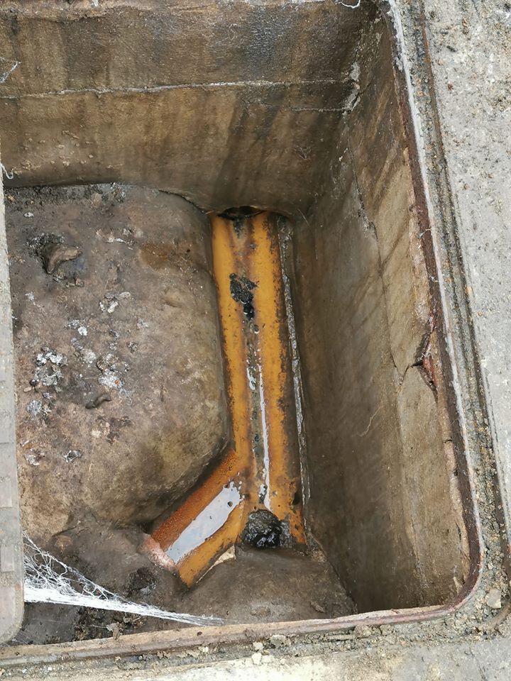

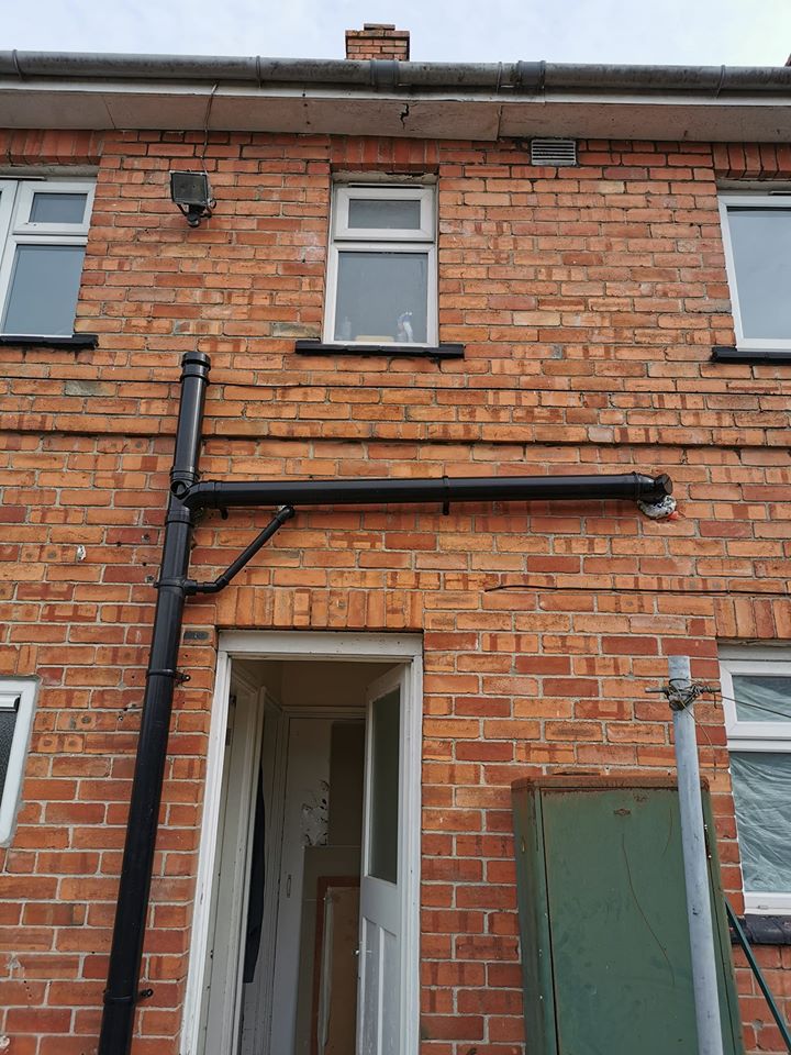

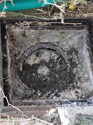

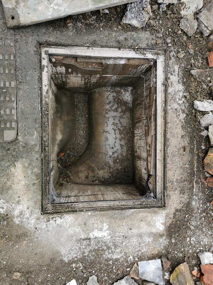

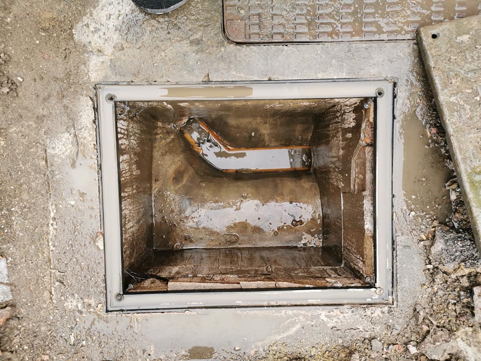

Manholes are not blocked i have ran a hose pipe down both of them and the water goes away it doesn't block, could it be a faulty Air vent valve ? thanks

Get someone to flush the toilet with you looking into the manhole.
Andy

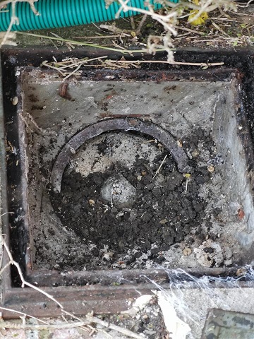

We can't find a drain that shows that happening i have put pictures of all the drains we have in front and back garden, we are starting to think that the other drain has been covered somewhere else and we don't know where to look, there are no visible signs of any other drains, anywhere thanks Andy
Put a hose pipe down the soil stack and turn the water on, if the bath fills up then you have a blockage, otherwise you should see water flowing into a manhole.

Hi Andy, i just spoke to my next door neighbour, she said that the drains are in a neighbours house next to her, so just went around there and they are, i pulled my flush with tissue paper in it ans by the time i ran around there, he said that they flowed through that drain, and he herd a gurgling sound too, the drain if fine no blockage at all, what do you think ?? thanks
Get the neighbour to flush their toilet while you are at their manhole and see if there are any noises.
