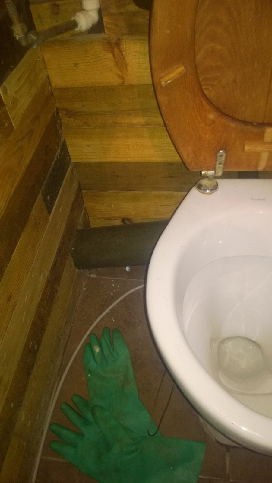

The toilet is on the ground floor and just turns at the back of the toilet (no S bend)and the pipe simply goes into the wall and seems to disappear under concrete outside and thats the problem. I am told it connects to the main sewer in the garden somewhere.
I think it would be easy to take out as it was a cowboy who put it in.

The toilet is on the ground floor and just turns at the back of the toilet (no S bend)and the pipe simply goes into the wall and seems to disappear under concrete outside .
You need to dig and uncover the pipe after it goes through the wall, next to the wall. then follow it along and dig a hole along the line - that should lead you to a manhole. You'll pay £100 for a clean and £?? for a cctv. Dig a couple of holes and post us the pictures;)
