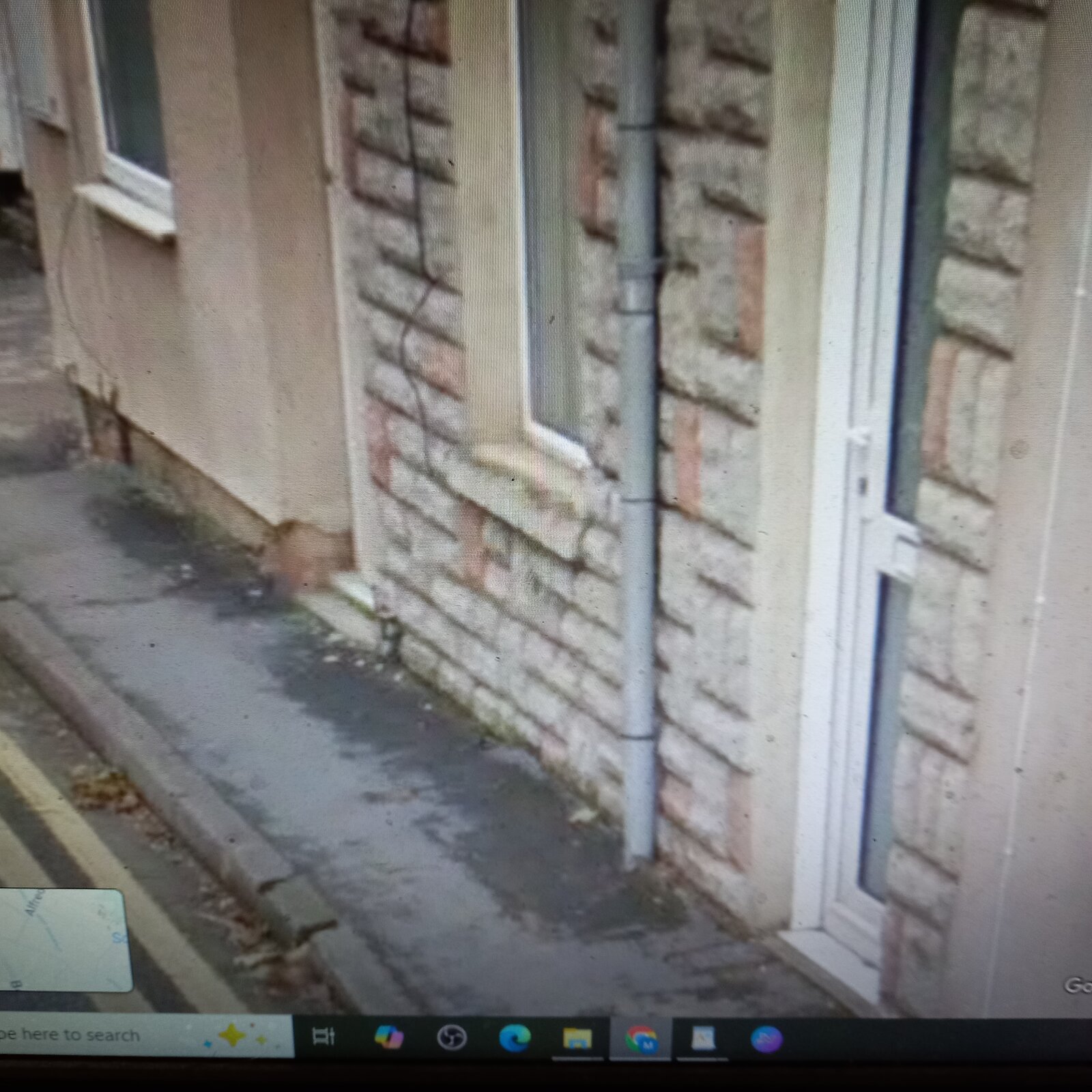

Hi I have a property where the gutter downpipe runs into the pavement and discharges somewhere underneath the pavement adjacent to the house front wall. I am suspecting theres a problem with where the water is going as front room has rot and damp in the floor by the front wall. In order to explore whats going on and fix it, I need a ticket from the council in order to get the pavement dup up at cost of around £1500 just for the ticket. My questions is what trade do I get in to do this?

Why not post a pic of the down pipe, & the outside pavement as it abuts the house - and a pic showing the damp/rot inside the house.
If possible annotate the outside pics to show where the FFL is, and the DPC.

see attached pipe. Its shows the PVC downpipe running down the front wall of the house. There are slight gaps in the kerb making me think thats an outlet but I'm unsure as they are almost blocked with tarmac residue. Behind the wall the pipe runs down is a front downstairs room, wooden floorboards with cavity beneath. The leading edge of the floor board closest to the wall is rotten and damp as is the corner of the skirtings in that area. I'm guessing the downpipe is somehow emptying into the foundations of the house causing the damp rather than flowing out onto the road beneath the pavement but I'm not sure how it all works. Other similar properties have similar downpipes but they exit in a gulley with a metal grille on top that runs to the road from the house wall.

it serves 3 roofs inc ours. Water company told me its our responsibility having seen a pic of it etc
Tell them it's a drain, shared between 3 properties and it's outside your boundary. Tell them you'll complain to offwat.
What you going to do if that pipe runs to the main sewer 20 feet down in the middle of the road and it's collapsed right at the end? Major civil engineering works!

The gaps in the kerb caught my eye - given other houses discharge at the kerb then it seems that your down pipe originally did the same - you could lift the short kerb stone, & attempt to rod it out from the gaps area?
However, the pipe may have perished?
You are on a slope & ground water could be moving downhill, and causing your inside damp issues?
Your front step is very low suggesting the FFL might be very low, & vulnerable to penetrating damp?
Is the wall solid - can you see the DPC - is it a stone build or do you have false stone effects glued on?
Always be cautious how you deal with your utility - they can cause you endless nuisance by, for instance, digging holes & leaving them unattended for weeks. They are well experienced in dealing with/brushing off complaints.
unsure about the construction and cant see any DPC. I've now got a company coming out with CCTV who have told me the same about the gaps. They will put the camera in from the kerb and down the PVC pipe so see if they can see whats going on
Sorry, didn't notice the exit at the kerb - it will just be a bit of pipe under the tarmac and should be easily rodable.
