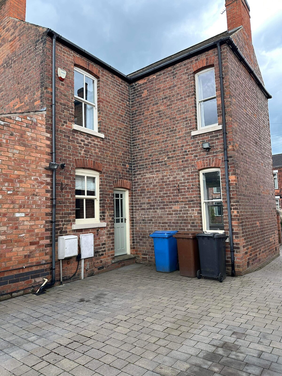

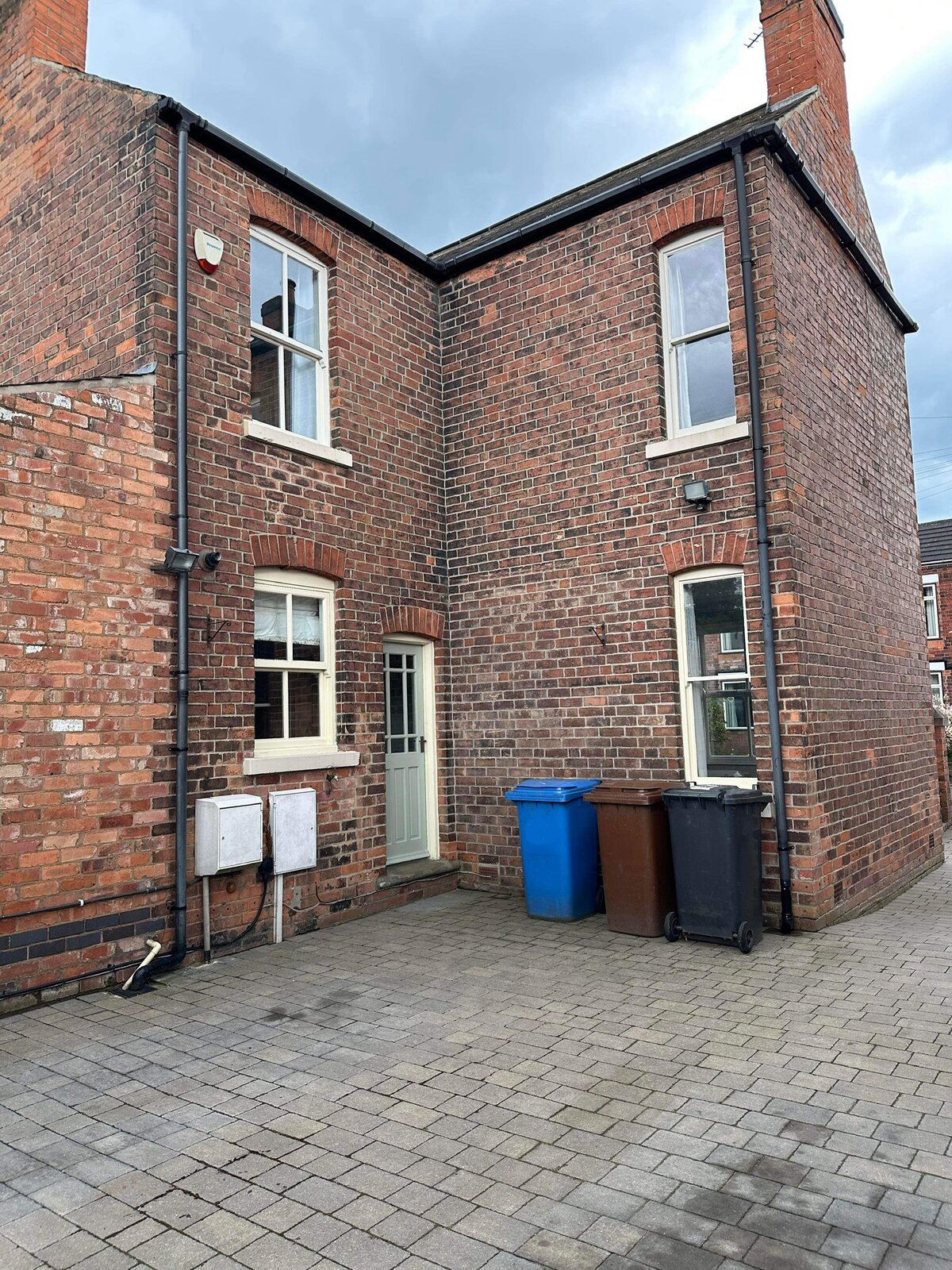

Hi all, haven’t posted on here in a while. Now live in an older house (1906) with problems, but all from poor maintenance under previous owners.
The first problem I want to tackle is the guttering and the right hand side downpipe on the attached picture. The guttering is blocked up in the corner (above the door) which is leading to problems inside, but I can sort that by just getting up there, clearing it out and keeping an eye on.
The problem I can’t find a reasonable solution to is this downpipe. As you can see, it has a 90 degree elbow on the bottom and simply discharges onto the driveway. It takes water from the guttering at the front of the house as well, so the volume of water is fairly high. The left hand downpipe goes into a private sewer (we pay for this service).
What could I do to ensure this second downpipe discharges water into the drain as well?

Could you just remove it and adjust the falls to the left one?
Could possibly be too much water depending on roof size
A quick fix, would be to pipe it under that window adjacent to it, sloping down into the corner, then over the door and the lower left window, then discharging into a new hopper in the existing fall pipe on the left. I have no idea whether that would meet regulations, though.
I considered that but wondered about having enough room to create the fall on the pipe. Rather than the hopper, I was going to get one of those T-piece sections.
Think it’ll be too much water sadly. There are four roof ‘faces’ which I think would overwhelm it.
Most of the flow down fall pipes, follows the perimeter of the pipes, so there is lots of airspace, that's to prevent them becoming easily blocked.
Just a suggestion, do as Harry suggests in #3, but use 80mm pipe below the new hopper.
Doubtless there are other suppliers of such pipe, but one is:

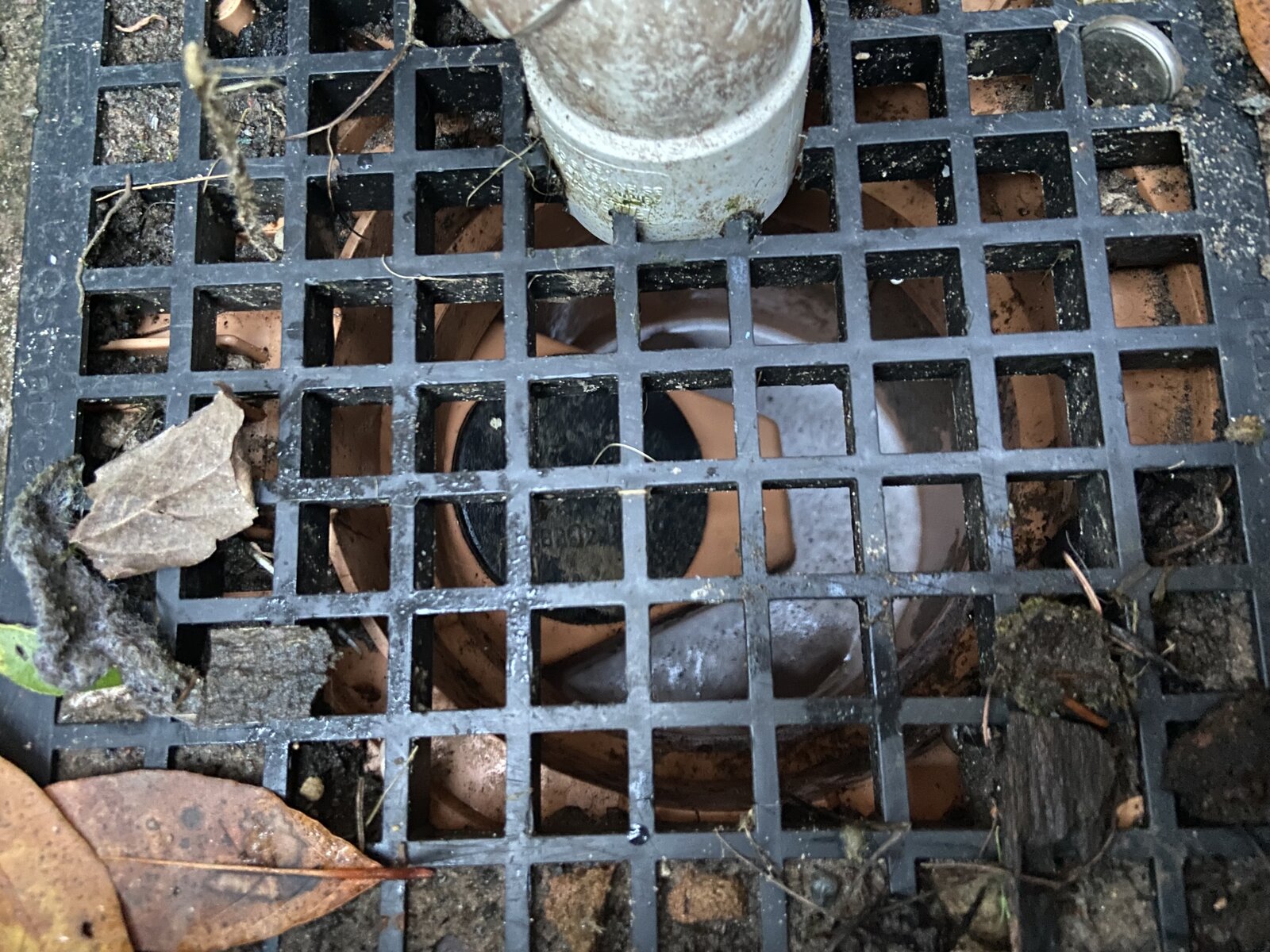

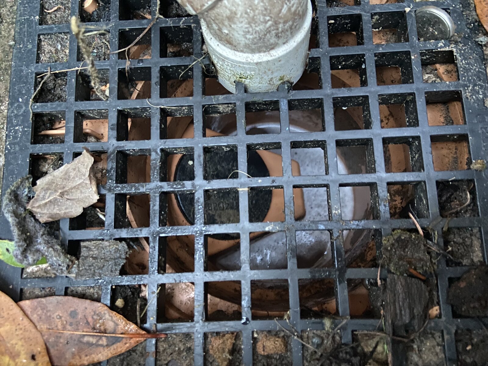

As per standard UK weather it’s peed it down over the weekend, and it was a good opportunity to see how the downpipe going into a ground hopper coped with the volume. It seemed to do absolutely fine making me wonder whether or not I could do away with the second problematic downpipe and adjust the falls on the guttering.
It goes into a hopper which has a constant water level (maybe a trap?). This is one at the back of the house (for the kitchen waste and rear extension roof water).
Can anybody identify this type? I’ve tried searching for it but none of my search engine terms are finding a match. Yes mine needs cleaning up from debris.
