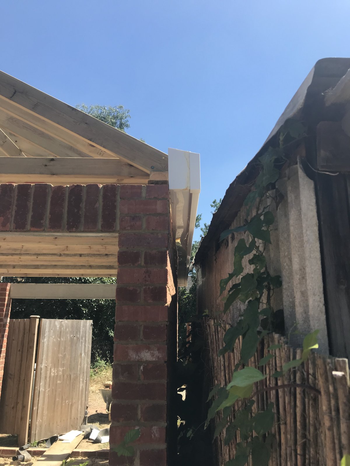

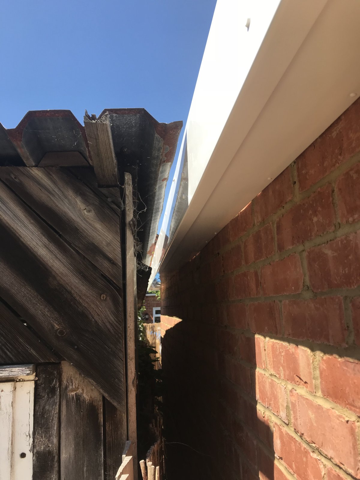

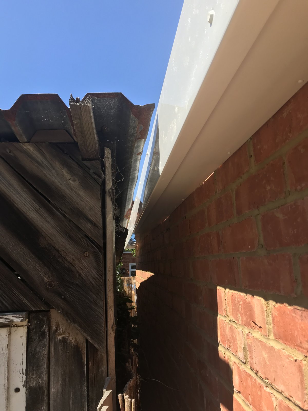

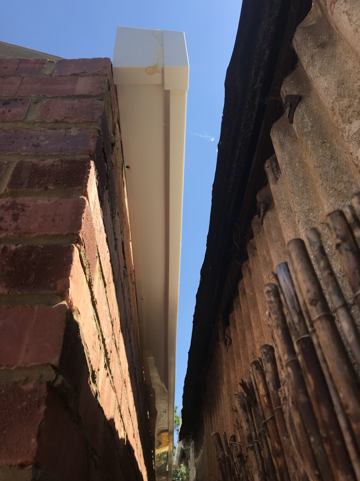

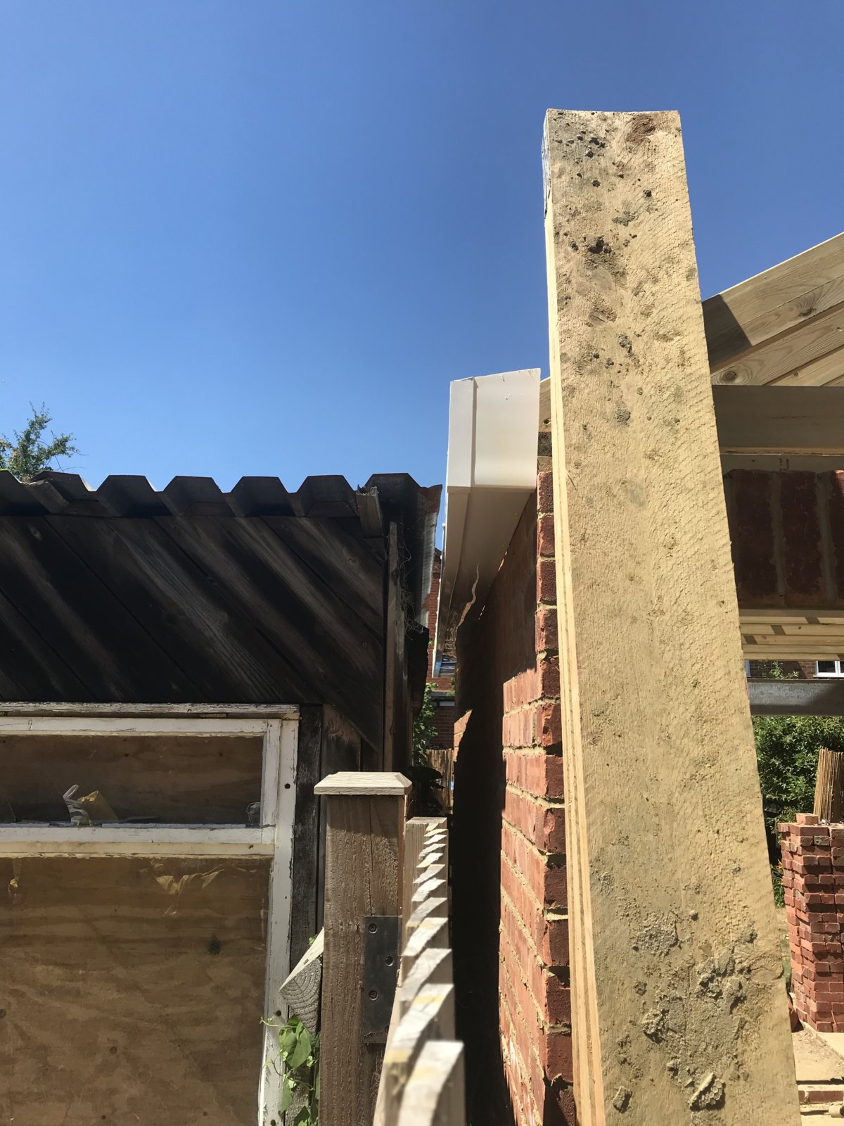

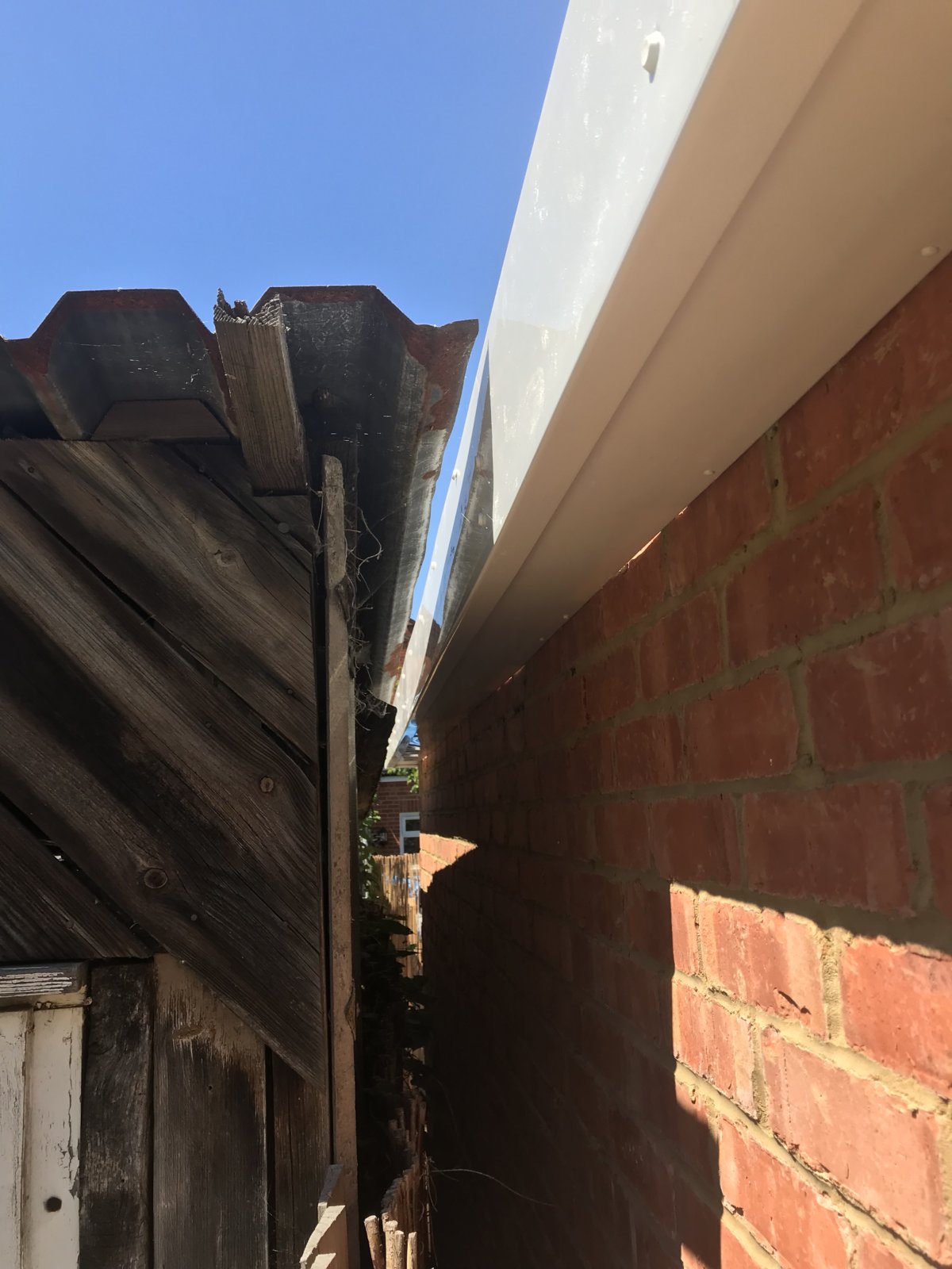

Hi everyon - first time poster here.
My friend and I have built a garage/workshop but have naively forgotten spacing for guttering. We've built it right up to the border and my neighbours tin shed/garage which actually overhangs into my side is now in the way.
Next doors tin garage is sloped, so I can fit a gutter about half way, but won't be able to finish it the entire length of the building as it meets my eves - theres about 1-2 inches.
Does anyone have any ideas on how I can overcome this?
My initial thoughts are half the bulding with a gutter in the right place and the other half with the gutter at the bottom of the fascia board?
Or do I just leave it...
Here are pics

Gotta be what Ian says or the gutter will trespass on neighbour's side
Yeah, cut the rafters back to the wall, flush fascia and fit gutter. It's not a big deal and a couple of hours work, but is way better and easier than any alternative.
Thanks everyone. I will have a look if this is an option and report back. My gut feeling is that there isnt enough overhang on the rafters to cut them down and fit a gutter - but fingers crossed!
