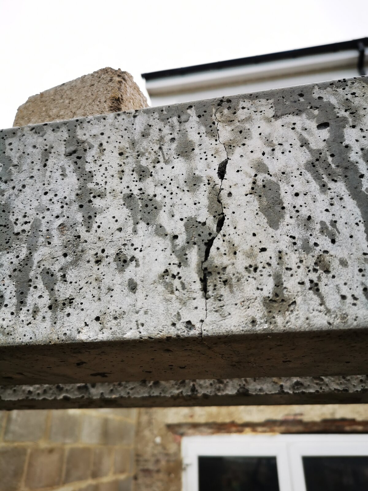

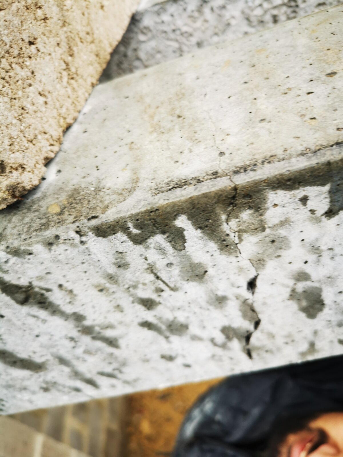

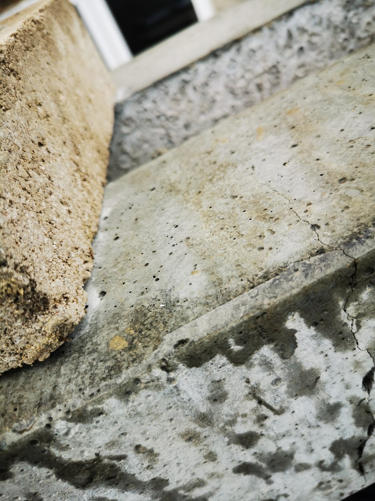

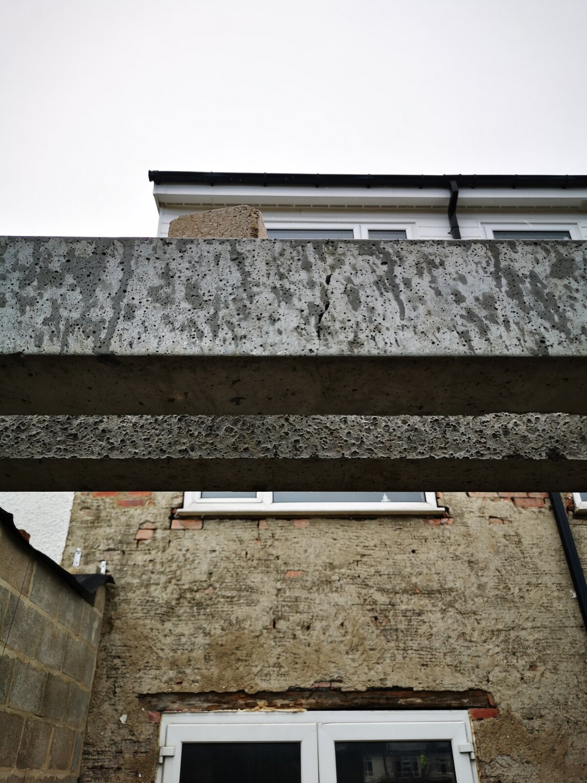

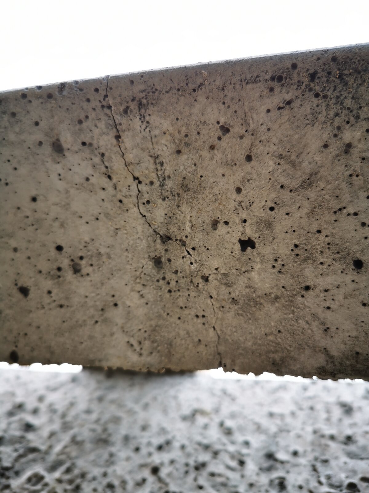

    I've put lintel up few days ago. Realised the front one has vertical crack in centre.
    Won't be supporting anything. Would it be OK or do I need to change it.
    IMG_20201214_133522.jpg IMG_20201214_133529.jpg IMG_20201214_133531.jpg IMG_20201214_133446.jpg IMG_20201214_133450.jpg IMG_20201214_133508.jpg

    It likely will be ok, but I would change it while you can
  4. the crack is right through it, it’ll bow under its own weight. it has to be replaced.
