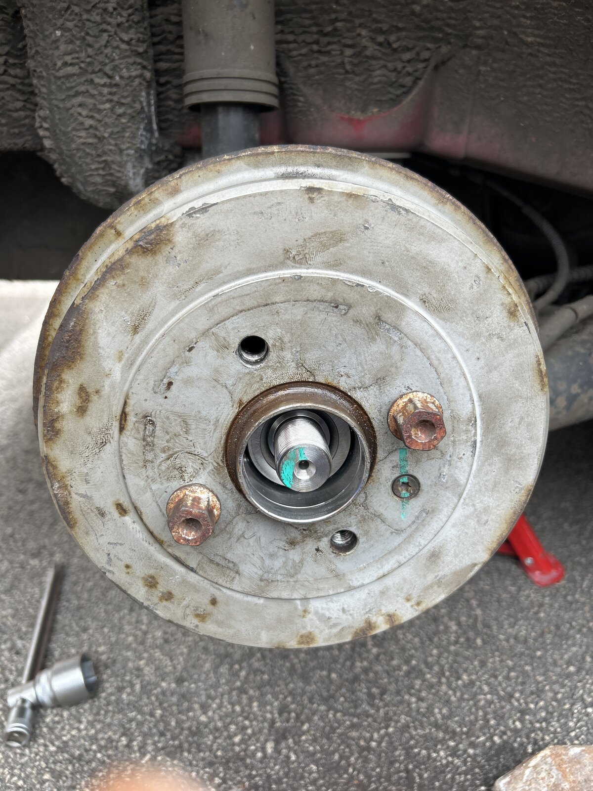

Any suggestions how to get the drum off???? I’ve done what I thought was the hard part of getting the hub nut off but the drum won’t come off now. I’ve tapped it with a hammer. I tried with the wheel bolts all out and the tamper proof out too and it seems to be stuck … it won’t come off completely… any suggestions??

I flood the area with a penetrating oil to get between the hub and drum.
A few whacks with a hammer ( turning the drum too) usually shifts things.
Application of heat around the area where the drum grips the hub may help.
If it’s really stuck, it’s out with the slide hammer.
You may find a rust lip on the drum inside when you do get it off and it’s best to remove this.....I use a die grinder for this.

He says so.....even if the drum is stuck, removing the hub nut should give some movement.
I’m wondering if the drum has shifted at all.....if so, it’s a rusty drum lip I guess that’s the issue.
