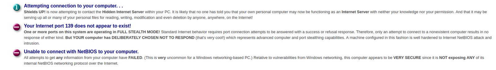

some odd results it would seem. This was from shields-up scan
Not at all, just normal operation.
The text on the GRC site about various ports and particularly 139 is severely outdated.
There was a time when certain Windows operating systems accepted incoming connections from pretty much everything. However that was in the days of Windows 98 and individual dial-up internet access.
NetBIOS over TCP/IP is disabled by default, has been for a couple of decades, and the options to change it are hidden away where most users will never find it.
Even if they somehow did enable it, pretty much any cheapo router including those supplied for free by ISPs will block that and everything else by default.

so there are no threats of anyone being able to get into your network even if you run windows...this machine is not running windows but it tells a scan that it is.....and millions of people are using an outdated site for checking their devices...so this cyber things is bluff then...actually, its called an Industry so it means it is wealth extracting.
There are plenty of threats, but they don't come via port 139 or generally from unsolicited incoming connections.
Far more likely is the use of a compromised IOT device within the home network.
They are. That GRC Shields Up site is 25 years old.
25 years ago the problem it describes was valid.
Today it is not. Windows 98 and other DOS based variants of Windows are ancient history,
