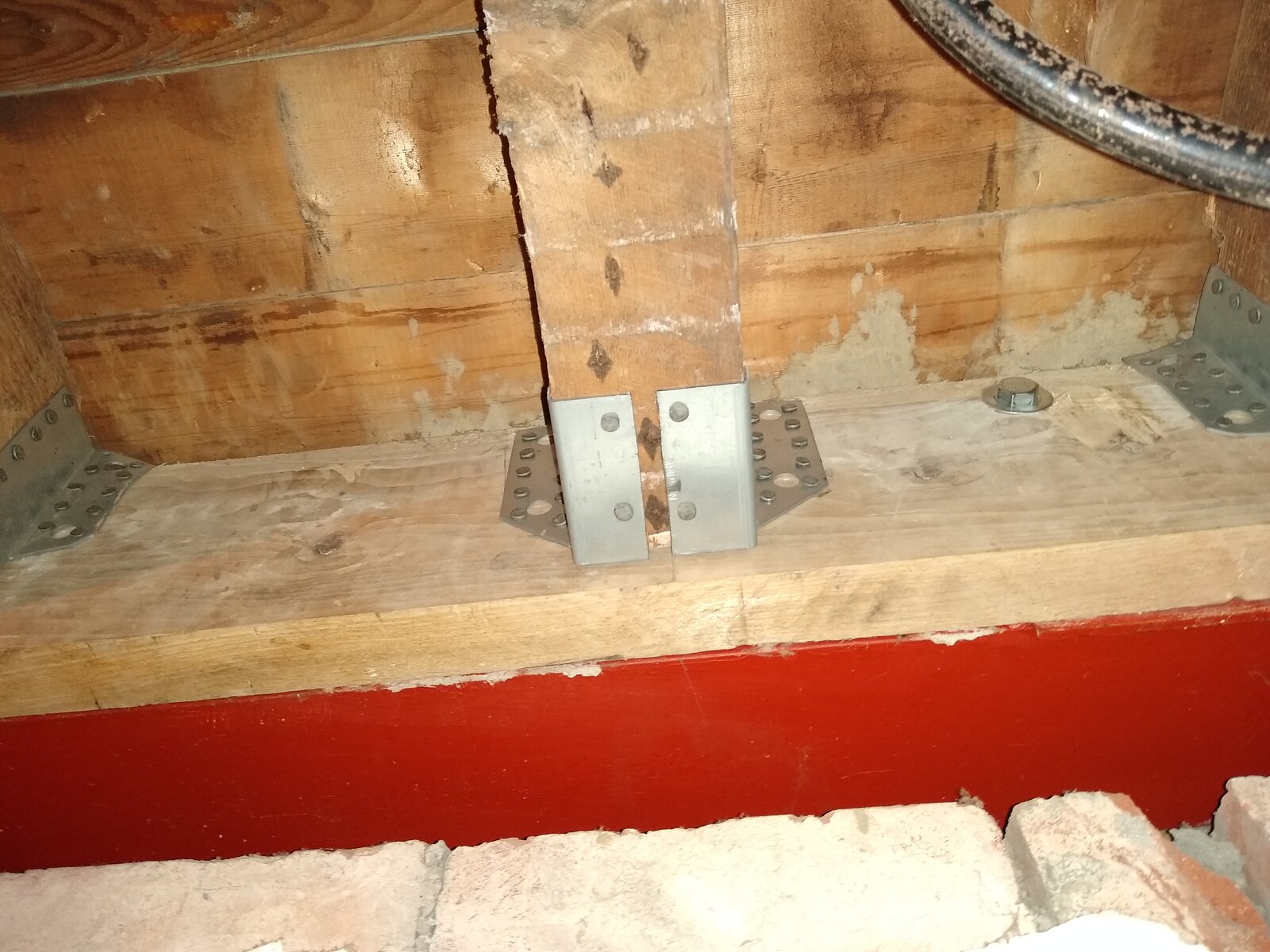

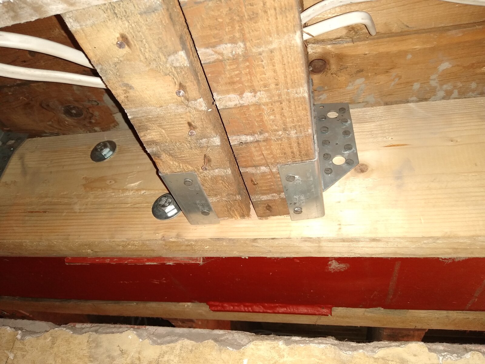

When I did mine I vaguely remember reading that the maximum packing allowable was about 5mm (can't remember where I read it or whether that was per side or in total). I suppose it starts to affect the penetration depth of your twist nails. If you want the "right" sizes try "metro fixings", they have a good range in steps of a few mm. They even sell a 2 part hanger that fits anything:
And before you ask, they do actually make such a thing, it's not just one cut in half.
Although this is one cut in half (I think it was about £2 cheaper than buying the two halves) :
