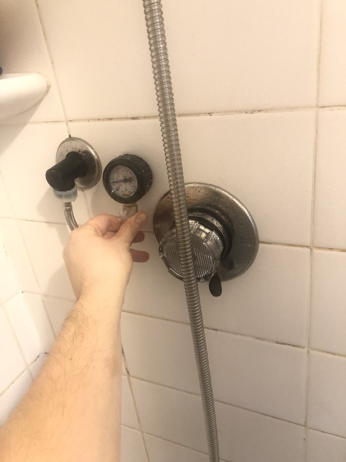

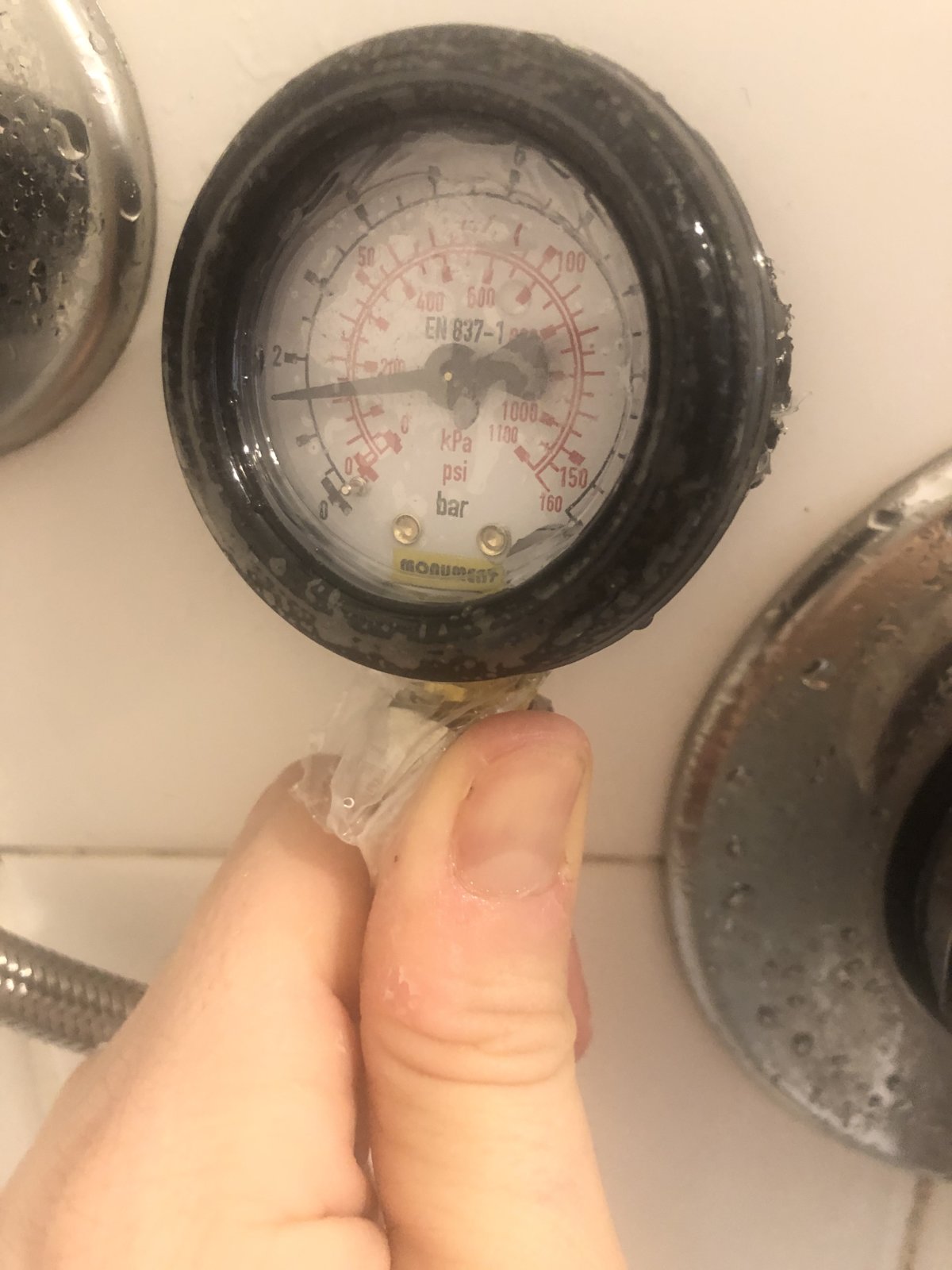

Managed to be able to test the current shower (see pics) output with the old mixer: pressure = 1.5 bar flow = 12l/min at shower temp.

Your flow at the shower will be restricted to the output that the mixer of the shower will deliver, if that makes sense. Mixer showers will always reduce the flow a little as the ratio of hot to cold will dictate that, output temp dependent.
If you are testing pressure you need more than one outlet open at a time as the dynamic pressure reading is the working pressure you want to know. Unfortunately your mains supply may be a bit of a bottleneck as far as flow is concerned.

OK so if I open the kitchen tap (which is on the same 'leg' as the outside tap) at the same time the pressure drops from 1.9 (dropped since earlier I guess due to usage of other people) to 1.4.
I'm guessing thats bad?
I don't understand why there is a difference in flow between the hot and cold at the bath. The PRV is on the mains feed to the UVC and both feeds to the bath are 22m and balanced from after the PRV.
I wouldn't say it's bad but it's not the best as there will be an even larger differential if more are opened.
Ideally to run an unvented properly you want 2.5 > 3 bar dynamic with a flow rate of >20L/min.
That being said, 10L/Min hot should be plenty to deliver a proper shower, it won't be skin tingling or anything like that with your pressure as it is but you shouldn't be dancing in the shower to try and catch the water drops either ;)
