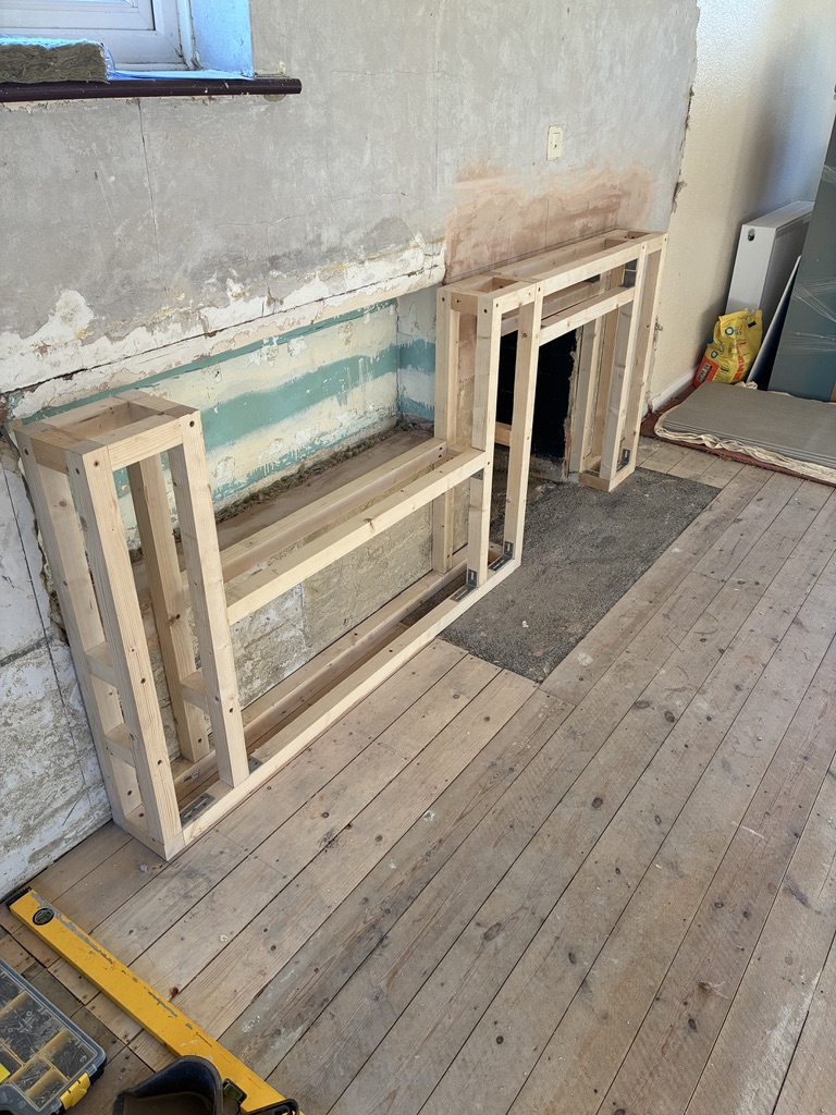

Hi all,
Bit of an unusual tiling situation. I am laying floor tiles in front of a fireplace surround (which I am also cladding with tiles) and part of the subfloor is floorboards, and the other is concrete as you can see from the photo. The concrete part is the hearth which I have repaired and levelled, more or less. The wooden frame I have just constructed is what I am boarding out and then tiling.

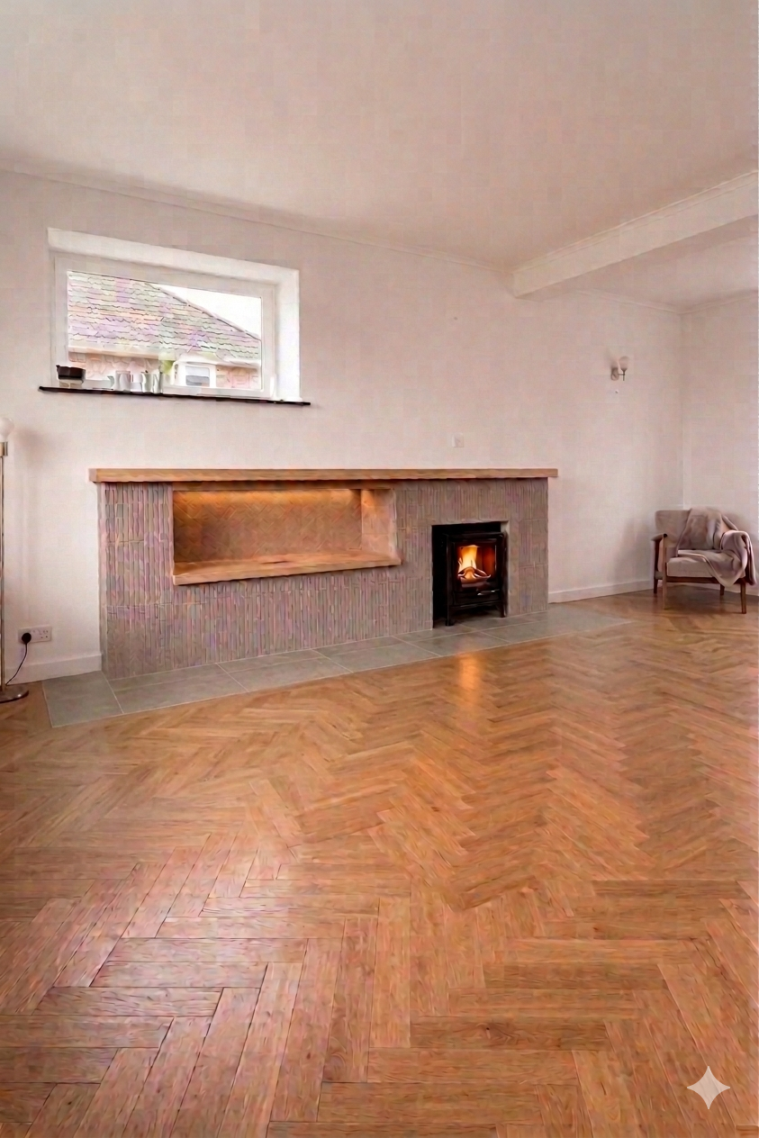

This is the final look I am going for:
My question is I have 6mm hardiebacker to put down which is obviously needed for the floorboards but I need to have this level. I am guessing I just use the same technique of using tile adhesive underneath the board in the concrete section, and was potentially going to also use masonry screws to secure it at appropriate intervals. Any other ideas or suggestions (or just confirmation that this isn't a terrible idea) welcome. I guess my only other option is to do away with the hardiebacker for the concrete subfloor part but then I'll be building up my adhesive layer much more to try and keep it level which seems a bad idea.
Incidentally I have already got a method sorted for the transition to the wood flooring, which will be the same level.
How uneven is it? Looks fine to me. Small inconsistencies in level will be taken out with the notches in the tile adhesive being compressed when you bed the tile.
If the concrete section is lower, fill it in with tile adhesive (let set prior to tiling) or a bag of screed, or use a thicker Hardie board.
@Deluks it is more or less level. That part is fine- that wasn't my question specifically. Perhaps I didn't explain it very well. It just says not to backer board over concrete subfloors but in my case I need to overboard this small section otherwise the only way of levelling the tiles is to have a much thicker bed of adhesive in that section where the concrete is.
Whilst you don't need to use tilebacker board on concrete, as the substrate is already fine for tiling onto, it still has a use for building up the depth, just full bed it down on tile adhesive, or use a cartridge based glue to fix it down. OB1 heatprotect or vitcas board adhesive if a stove is going on top.
