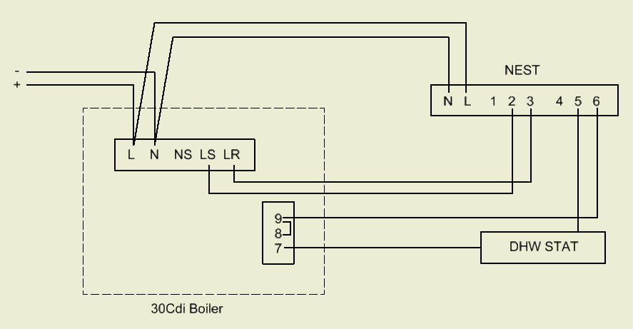

Just to clarify before this happens, is the attached diagram correct for the set up discussed earlier this week?
Please advise if it's not.
Thanks again Picasso, top man! When it's done I will post the result for the benefit of others with the same query in future.
Update - so in conclusion, yes; you can successfully install a Nest hot-water function to 30cdi classic boiler as well as central heating function!
In brief this is how we did it. (**disclaimer** The following should be performed by a qualified engineer and all power to the system must be isolated!)
First the temperature sensor on the hot water tank was replaced with a thermostat, followed by a factory reset on the boiler so that it would reconfigure itself to use the stat.
Next, the central heating thermostat was disconnected from the boiler terminals and the Nest heat link was installed and connected to the attached diagram (with the hot water tank thermostat wired in series to the heatlink);
upload_2020-9-25_14-3-27-png.205883
Nest fired up and all updates installed. Boiler switched on and all worked as expected.

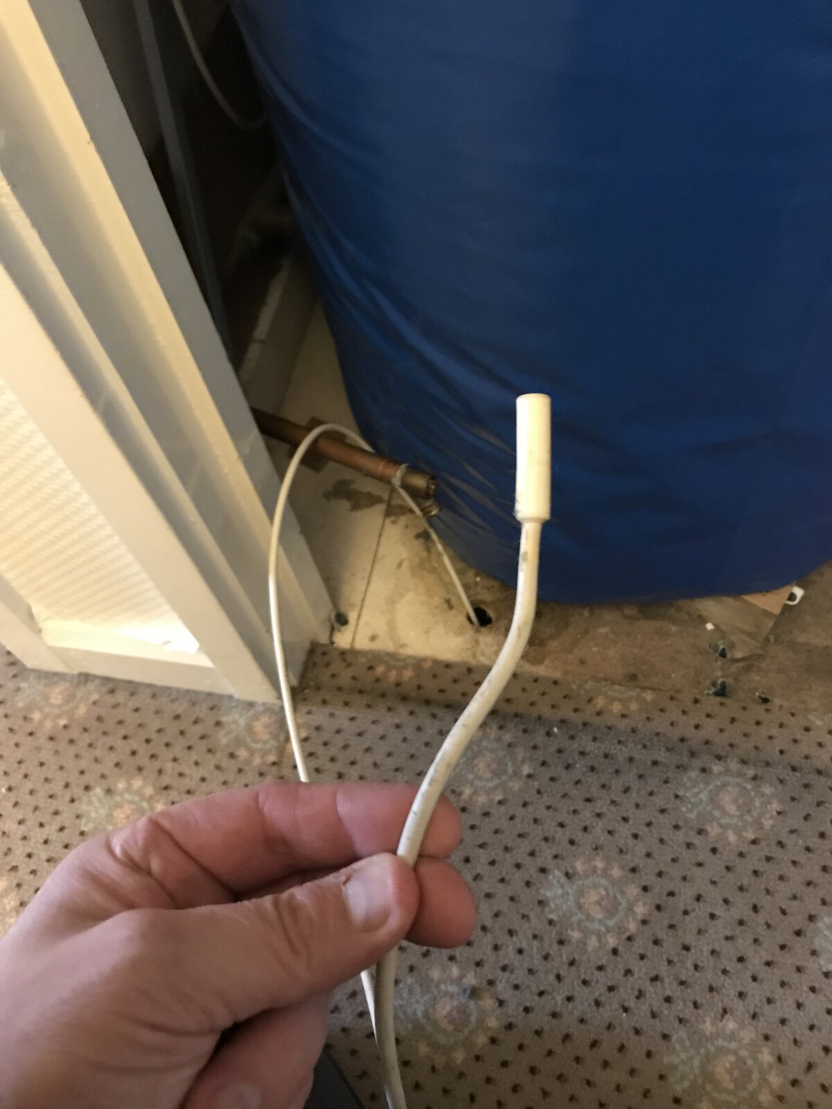

Hi Andrew,
I have the exact same boiler as you and I belive I also have a temperature sensor on the hot water tank.
Could you please share the thermostat you used to replace it?
Cheers
James
