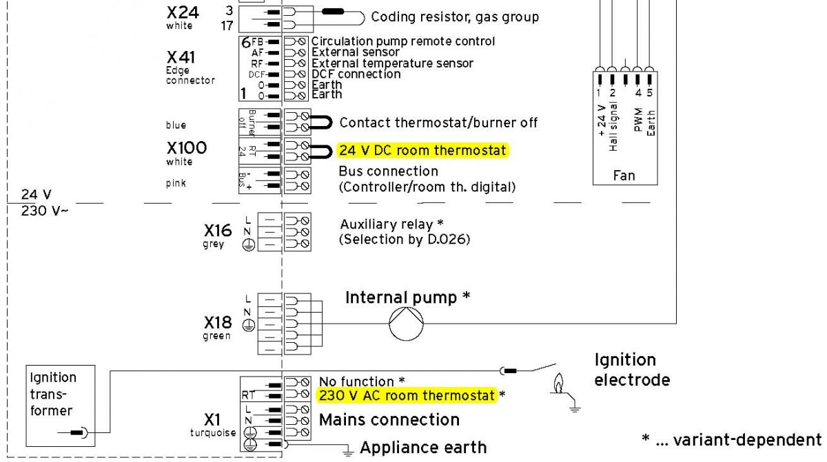

I have found this circuit for an EcoTEC. If it corresponds to your version it will enable you to identify if your Danfoss thermostat was switching 230v or 24v by the terminals it was connected to.
