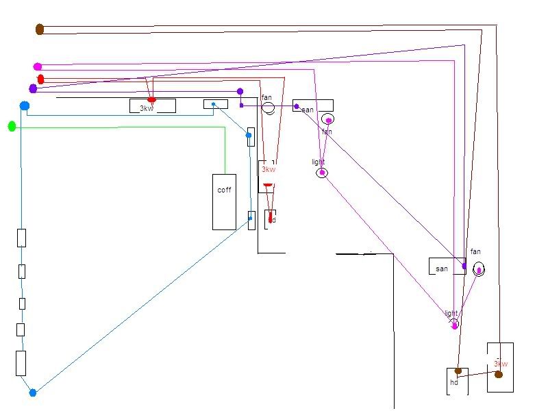

Does SAN indicate Saniflo pumped sewage system and if so are there only two toilets both wth Saniflos ? If so I would NOT put them both on the same circuit just in case you lost power to both and repair was going to be some time.
good thinking batman, will redo that bit then , and as for the drawing it was somthing I done in 2 minutes, but will redo in autocad when I get the chance.
