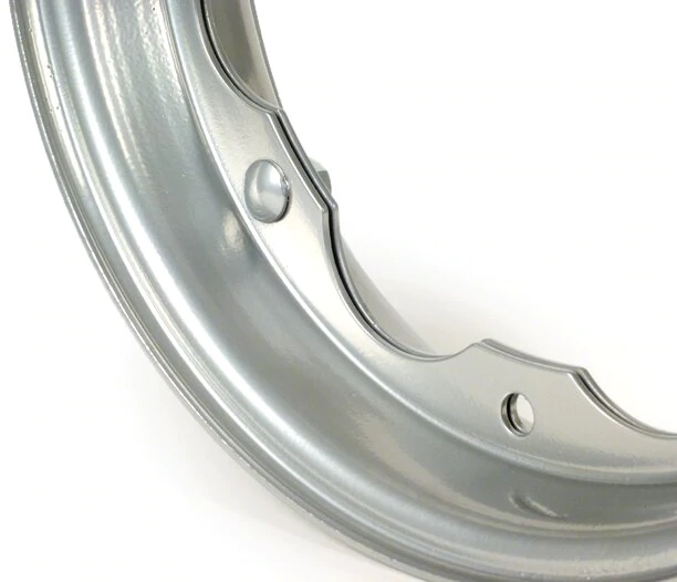

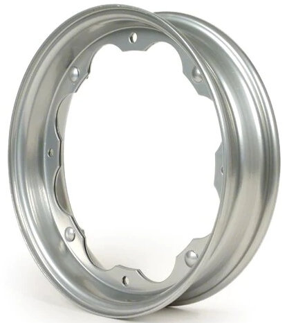

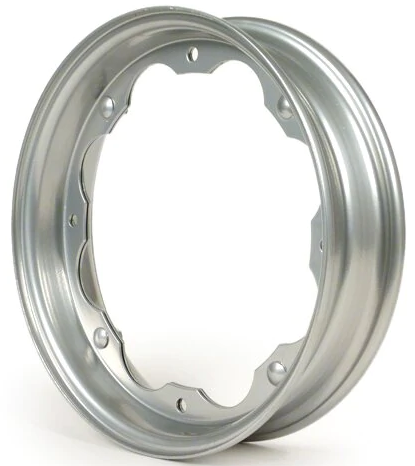

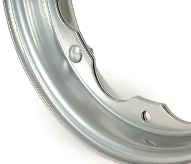

upload_2022-4-19_8-48-42.png upload_2022-4-19_8-49-53.png They are about the easiest tyre to change, no tyre leavers required, simply split the rim. Lambretta, and both Vesta's were the same, I only had a British Douglas Vesta myself, and Lambretta, but both had split rims.
