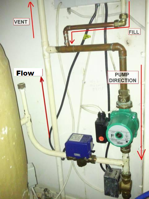

Can you see what type of vent & cold feed arrangement you have, you don't say whether oil or gas fired with external circ pump?, your system may look something like the attached (close coupled) where from the boiler flow, you have the Vent then the Cold feed (no more than 150mm from the vent) and then the circ pump, also post make/model/setting of the circ pump.

Gas boiler, and close coupled as above.

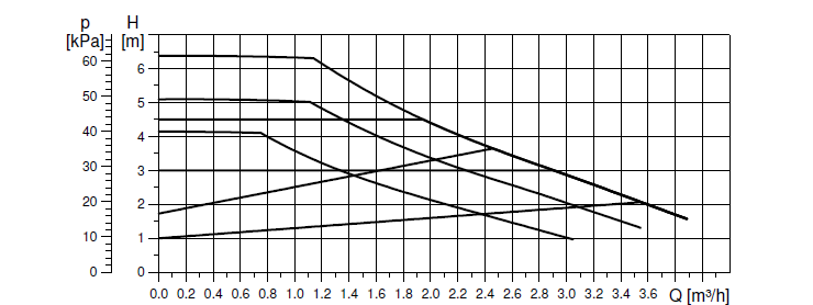

it's a Grunfoss UPS3 set a speed 1.

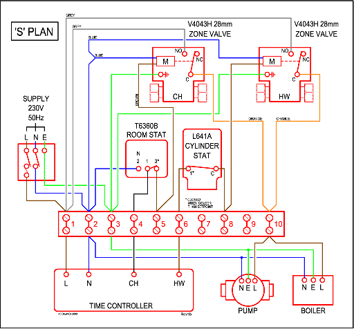

The boiler is an Ideal heat 24. I have noticed it only happens if the boiler is on and the timer turns off. The pump stops, as far as I can see from the wiring diagram. There is no way the pump can run, as it takes its feed from the orange wires on the 2 zone valves.

Secondly, you might change the pump speed to CP1, (constant pressure), which means the pump will run with a 3.0M head vs 4.2M and see does it make any difference, 3.0M should probably still be OK to circulate your system but see what happens anyway if you do those tests.

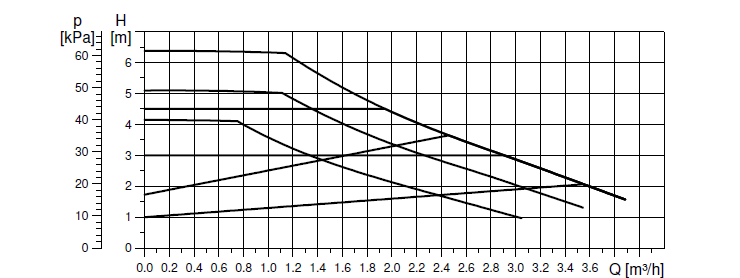

Was that UPS3 installed with the original system ~ 7 years ago?, if so, and has been running on speed 3 since, then its simply incredible that you havn't had all sorts of pump over/air ingress problems in your OV system as this is a very powerful pump and will still run at a 6.4M head at 1.15m3/hr, over 19LPM. (see link below to a whole company that never seems to have realised this). I'm still not clear as to whether the F&E cistern is actually overflowing with no vent pumpover or pumpover with no overflow or both. Obviously though if still getting problems on speed 1 or (constant pressure) CP1 then possibe restriction as suggested in post #9

If you mean that "the room stat turns if OFF the boiler" and the pump continues to run continuously then something wrong if wired like you say it is, see schematic below, my oil fired boiler (no pump overrun) is wired similarly, then when the roostat is satisfied or programmed off, the zone valve is de enrgised and closes, its end switch opens and switces off the 230V supply on the orange wire to both the boiler and the pump, both then stop.

No the pump stops after about a minute, when the stat turns off the boiler.
Spoke to Ideal who confirmed that there's no over run when the programmer shuts of the boiler. They do sell an over run kit though.

Well. Something must be telling the pump to run on for a minute, if the cylinder heating is on and the cylinder stat is satisfied what does the pump do?
