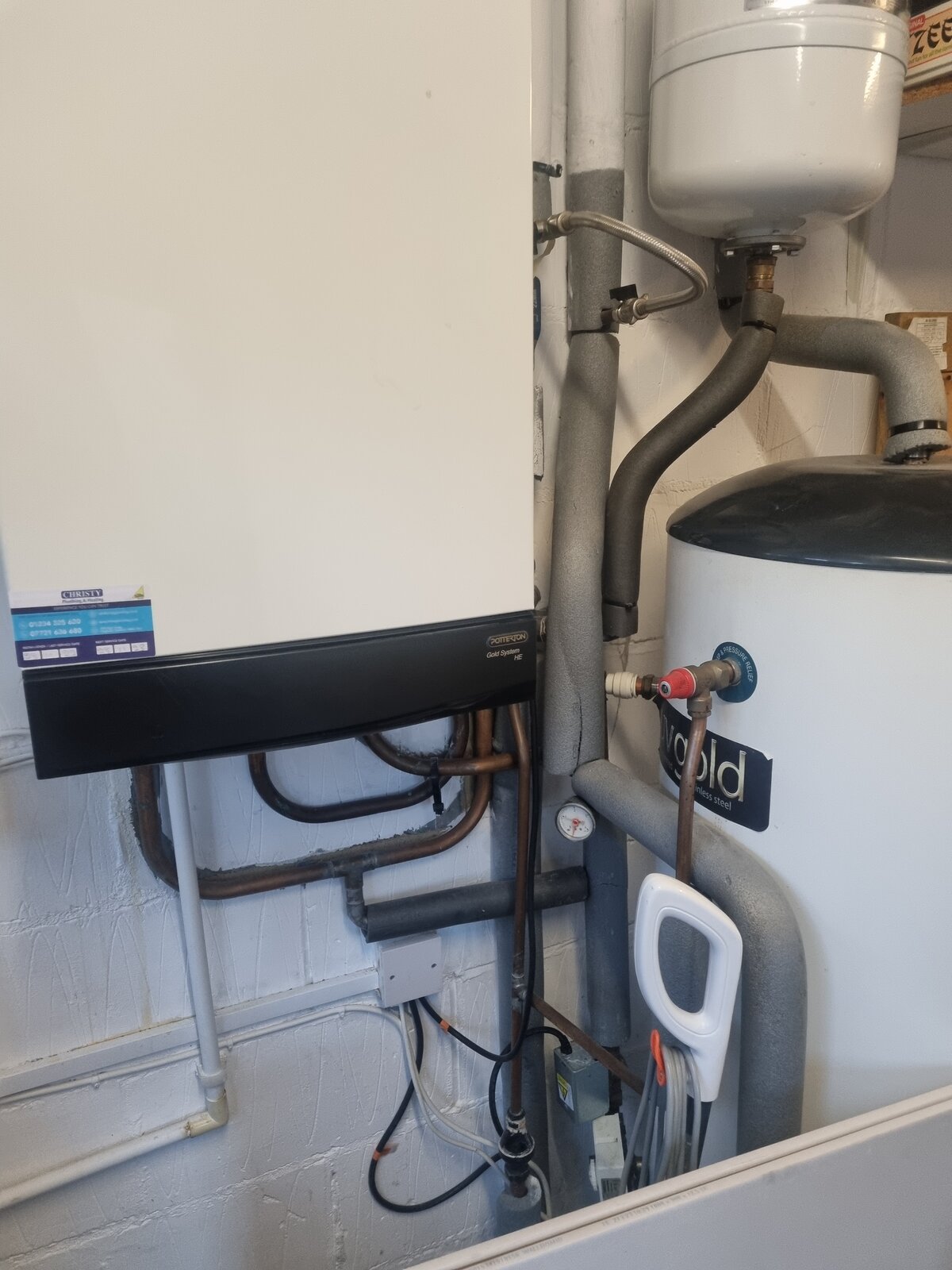

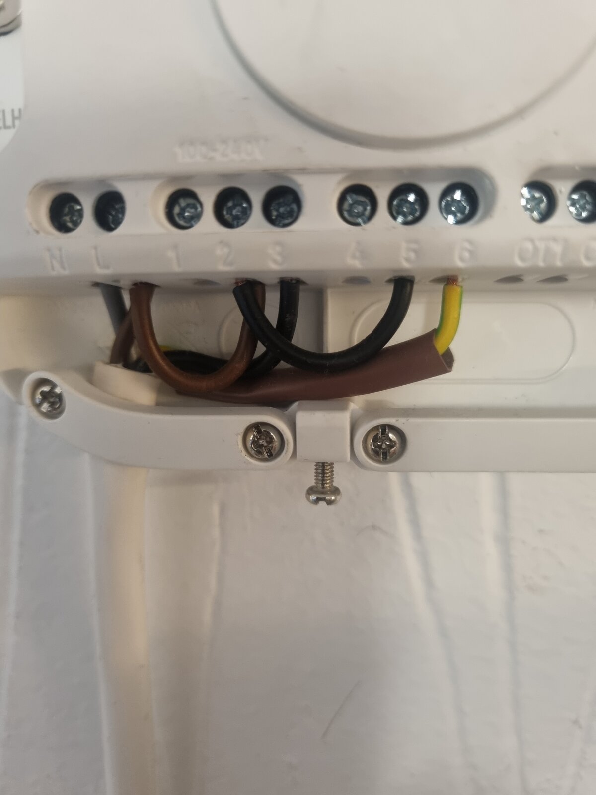

Good morning
Our heatlink is not working. It is going to be replaced free of charge but its lost in the FedEx Express system.
There is power to it.
We are desperate for some heat in the house as we have a two month old baby and a 3 year old.
I have read on this forum that I can swap some cables over in the heat link to fire up the boiler.
We don't need hot water as we can use the immersion on the hot water tank.
Please can anyone let me know which connections to change.
Thank you.

You can try moving the black wire in terminal 3 to terminal 1 for heating and the green/yellow wire from terminal 6 to terminal 4 for H/W
And then use the controls on your boiler to set timings.
if that doesn't work (we don't know how decent the relay contacts are), move the brown wire in terminal 2, to terminal 3, for heating.
please shut the power off to your system first and make sure the heat link switches off before playing with any wires as there's 240v running through that!! If you have a circuit tester make sure the connection is dead.

Thank you guys, for all your help and advice.
Yes, I did isolate the supply before looking.
The children are now getting warmer.
We have an old house and the temperature had dropped to 9 degrees. I managed to send them out this morning.
This has also brought the nest thermostat back on. This means i can use this as the on off switch to the boiler
Once again a massive thank you.
If you've moved the wire as suggested, I'm afraid the thermostat won't turn the boiler on and off, as we've basically bypassed the control.
