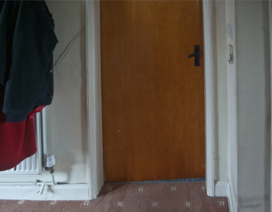

If a thermostat is not used to control room temp why is it adjustable ? why not just have a big red switch saying ON/OFF ?
It is so it can be matched to the TRV in the same room.

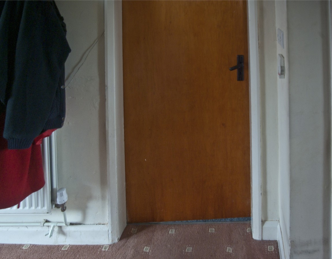

To the right is the wall thermostat, when the temperature outside is high this will switch off the boiler stopping the boiler from cycling, bottom left is the TRV that controls the room temperature in this case the hall. The wall thermostat is with a modern boiler a cheap way to stop the boiler cycling and also give a degree of frost protection. I turn the thermostat down to the stop in the summer, so should I forget in the winter the boiler will still fire up to stop anything freezing, and in the winter it is turned up to the stop, which is set to 19°C. The TRV in the same room is set so in heart of winter the wall thermostat never gets warm enough to switch off, however as spring arrives the TRV does not switch, but gradually turns off, so a point is reached when the thermostat does get warm enough to switch off the boiler.
First year fitted it took slowly opening the TRV when it was a warm day, until room got warm enough to switch the wall thermostat, once set, it is left well alone.

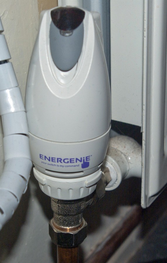

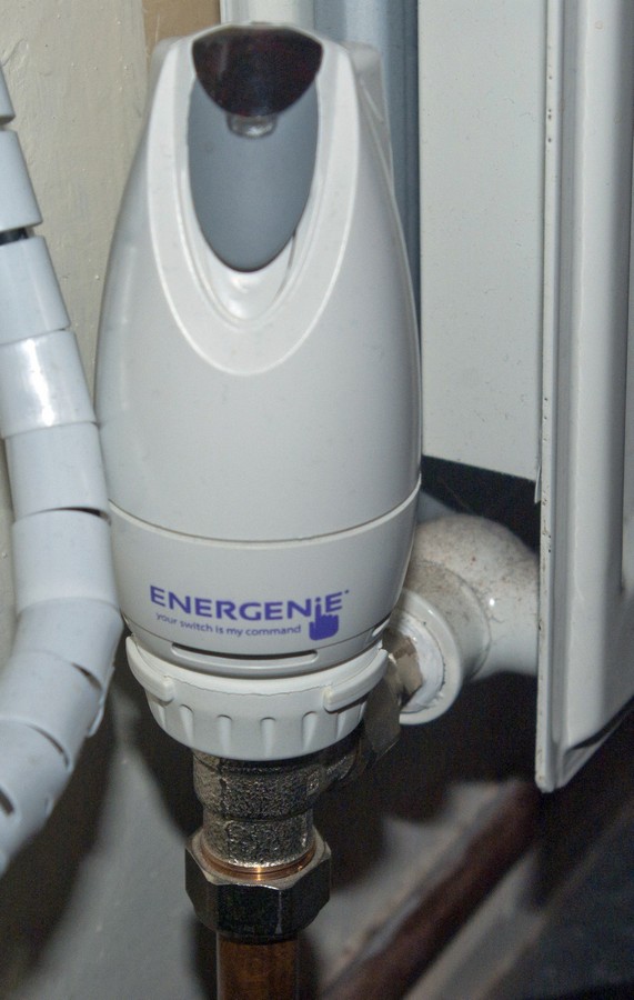

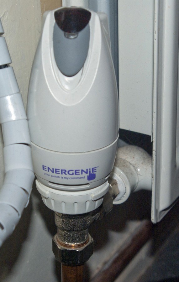

In the other downstairs rooms a better quality TRV head is used, IMGP8035.jpg these eTRV heads can be programmed to different temperatures through the day, and like the simpler TRV they also turn slowly giving more or less water flow, they do not switch. The modern boiler is the same, it does not simply switch on/off but the flame height alters to keep the return water at a pre-set temperature. Only when it can't turn down any more, does it start switching on and off, the anti-cycle software monitors after a set time allowed for the water to circulate if the return water is still too hot, or if it is cold, and the off time is adjusted longer if it returns too hot and shorter if too cold.

It is so it can be matched to the TRV in the same room. View attachment 122465To the right is the wall thermostat, when the temperature outside is high this will switch off the boiler stopping the boiler from cycling, bottom left is the TRV that controls the room temperature in this case the hall. The wall thermostat is with a modern boiler a cheap way to stop the boiler cycling and also give a degree of frost protection. I turn the thermostat down to the stop in the summer, so should I forget in the winter the boiler will still fire up to stop anything freezing, and in the winter it is turned up to the stop, which is set to 19°C. The TRV in the same room is set so in heart of winter the wall thermostat never gets warm enough to switch off, however as spring arrives the TRV does not switch, but gradually turns off, so a point is reached when the thermostat does get warm enough to switch off the boiler.
In the other downstairs rooms a better quality TRV head is used, View attachment 122474 these eTRV heads can be programmed to different temperatures through the day, and like the simpler TRV they also turn slowly giving more or less water flow, they do not switch. The modern boiler is the same, it does not simply switch on/off but the flame height alters to keep the return water at a pre-set temperature. Only when it can't turn down any more, does it start switching on and off, the anti-cycle software monitors after a set time allowed for the water to circulate if the return water is still too hot, or if it is cold, and the off time is adjusted longer if it returns too hot and shorter if too cold.

I will agree it took some time to trim the TRV and thermostat to complement each other, and that a heating engineers time would likely make it cheaper to use some thing like EvoHome where it is quick to set up and then they can walk away.
However it works, so for DIY and this is a DIY forum it is a viable option.
Eh..........you don't fit a TRV on a radiator if there's a Room thermostat in the same room mate!! Too much writing & not enough listening fella!!
