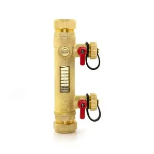

I am responsible for an office ASHP heating system, and this morning when it's 2 degrees C outside, the outdoor unit is continually icing up. For 20 minutes of each hour it produces no internal heat as it it busy defrosting its outdoor coils. Even though the building is well insulated and has been Environmentally Certified as BREEAM Excellent; once the outside temperature drops to low single figures it can only maintain 20 degrees internally with the ASHP running 24/7.
Because ASHP's work like a fridge in reverse, the indoor coils get warm, and the outdoor coils get cold, so even when it's 5 degrees C outside the outdoor coils will still ice up as the coils themselves fall below 0 degrees C, and the damp British air passing over them turns to ice.
When it's 10 degrees or above outside it produces vast amounts of heat and warms the building very quickly, but as the temperature falls into single figures and more heat is required, efficiency drops and it produces much less heat, and then when we get down to 5 degrees the dreaded defrosting starts.
So in summary, at the point when you need more heat, the ASHP heat output drops dramatically.......

@stem What model is the HP ?
It sounds like the HP might be undersized ? Is the building temp comfortable ?

The HP in the office is a Mitsubishi City Multi. But as I said it's a good few years old, so maybe the technology is better now. Working well today though.
come across this problem a lot with systems that were fitted without flow limiters. if the system can pump around more than the design flow rate then at low outside temps it will reguarly frost up. It's not a big job to fit a flow limiter
