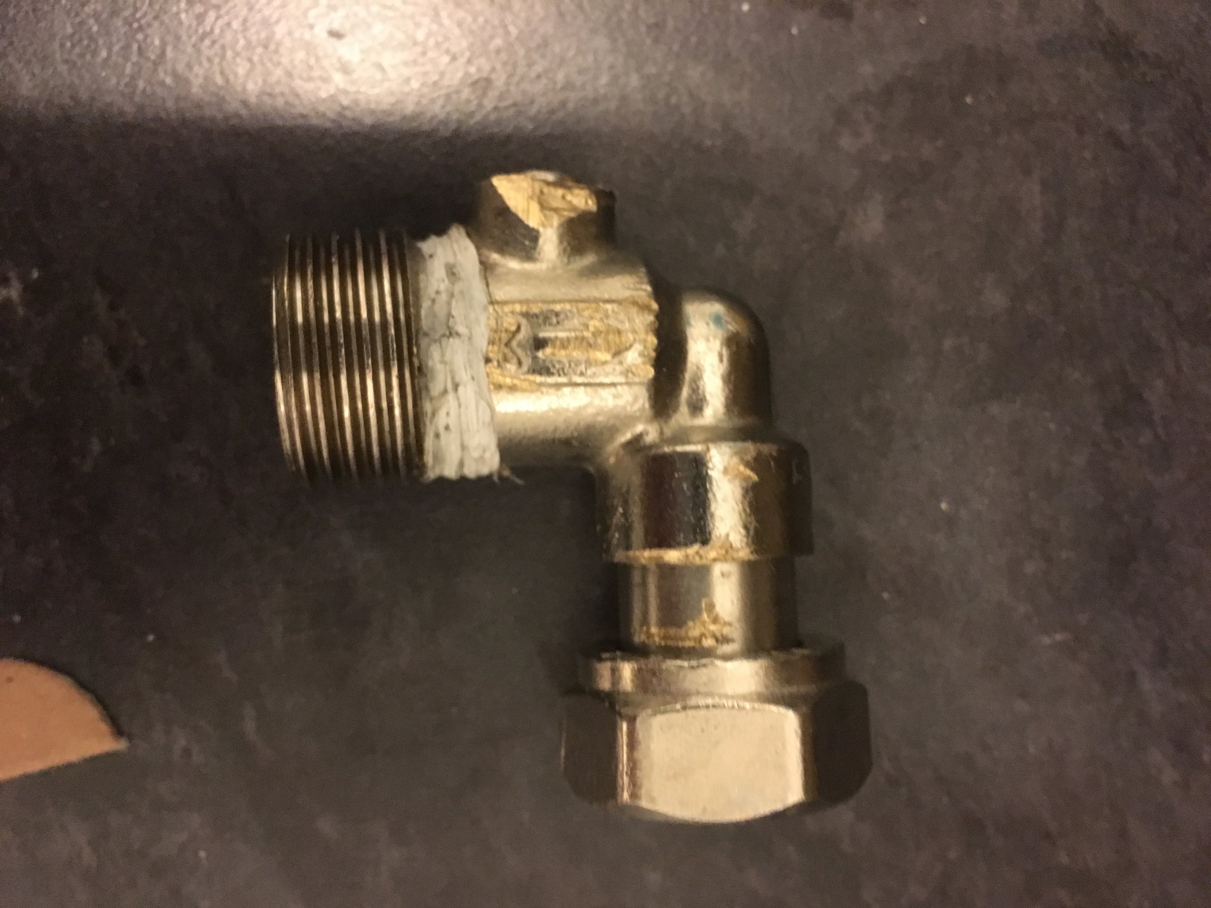

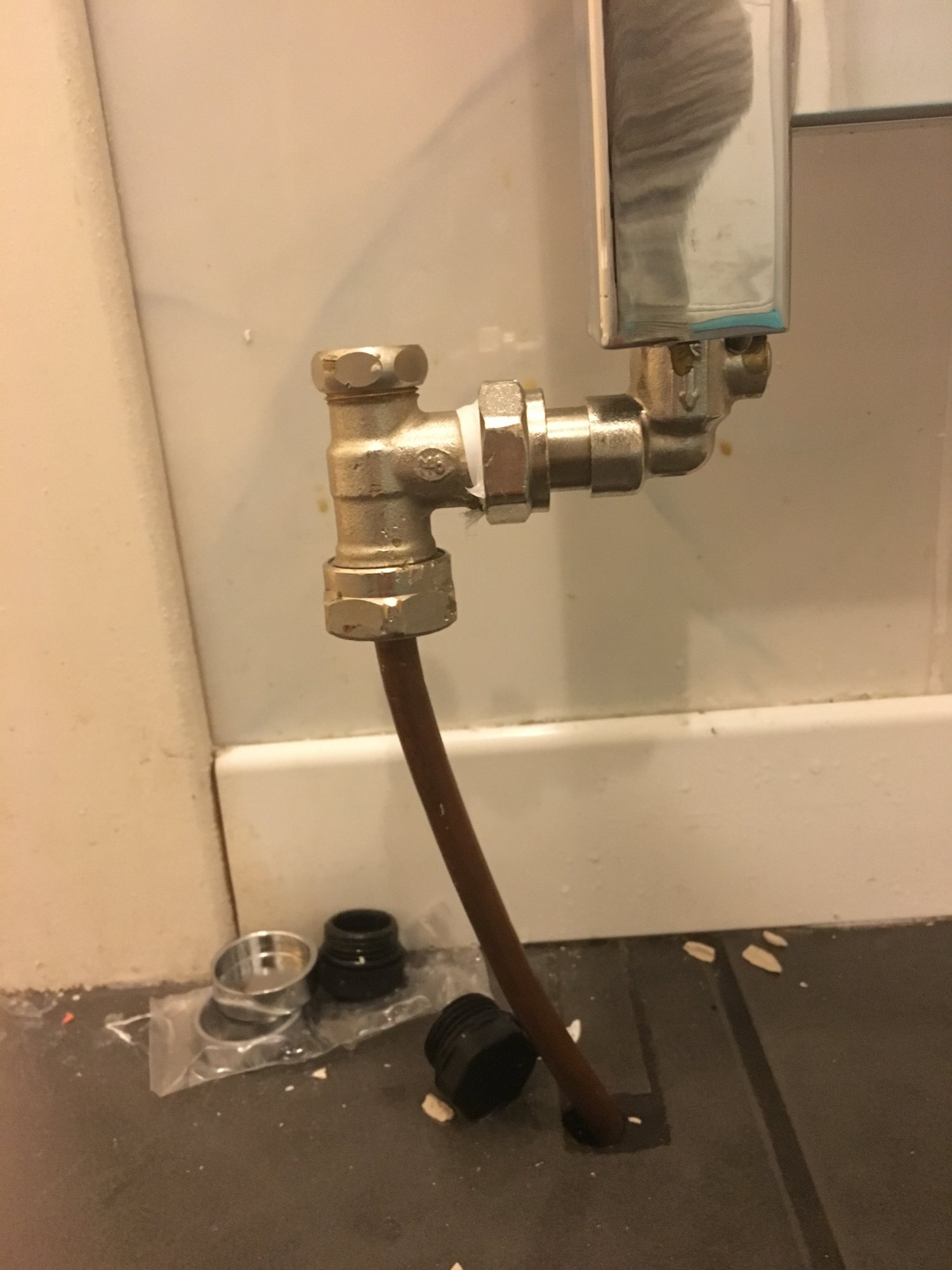

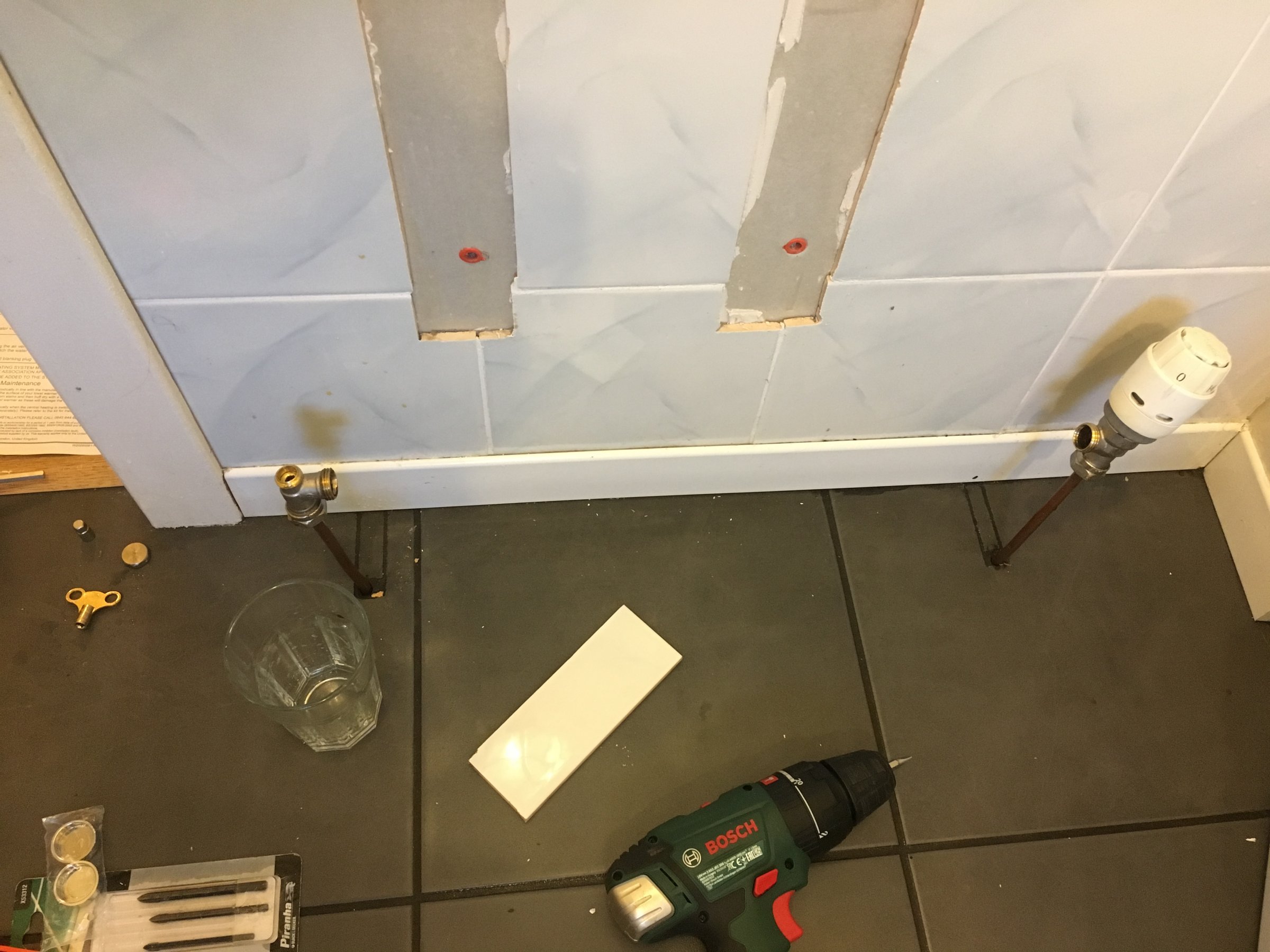

I've been trying to replace my bathroom radiator with a heated towel rail. Every time I connect the rose it leaks. Thought I'd cross threaded so bought another which did exactly the same thing with PTFE and careful tightening. What have I done wrong? See pics below

The fittings your using are not suitable for what you are trying to do and it looks a bodge call a pro.

Cheers for the tips guys. The only reason I used that setup is because I didn't want to have to bleed the system to remove the existing valves from the pipe work. I've now bled the system and put on nice looking straight valves and it all works a treat. The room is warm enough so I'm not fussed about losing a radiator - it was more to add a place for my wife and I to hang our towels rather than continue getting the back of our bedroom door damp.
