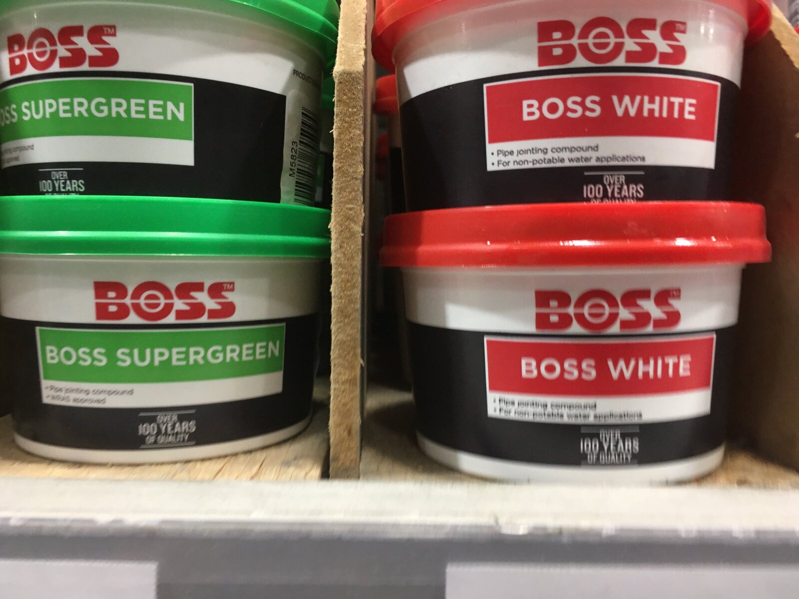

I’m just in b and q is jointing compound the same as boss white joint compound or boss green jointing compound please

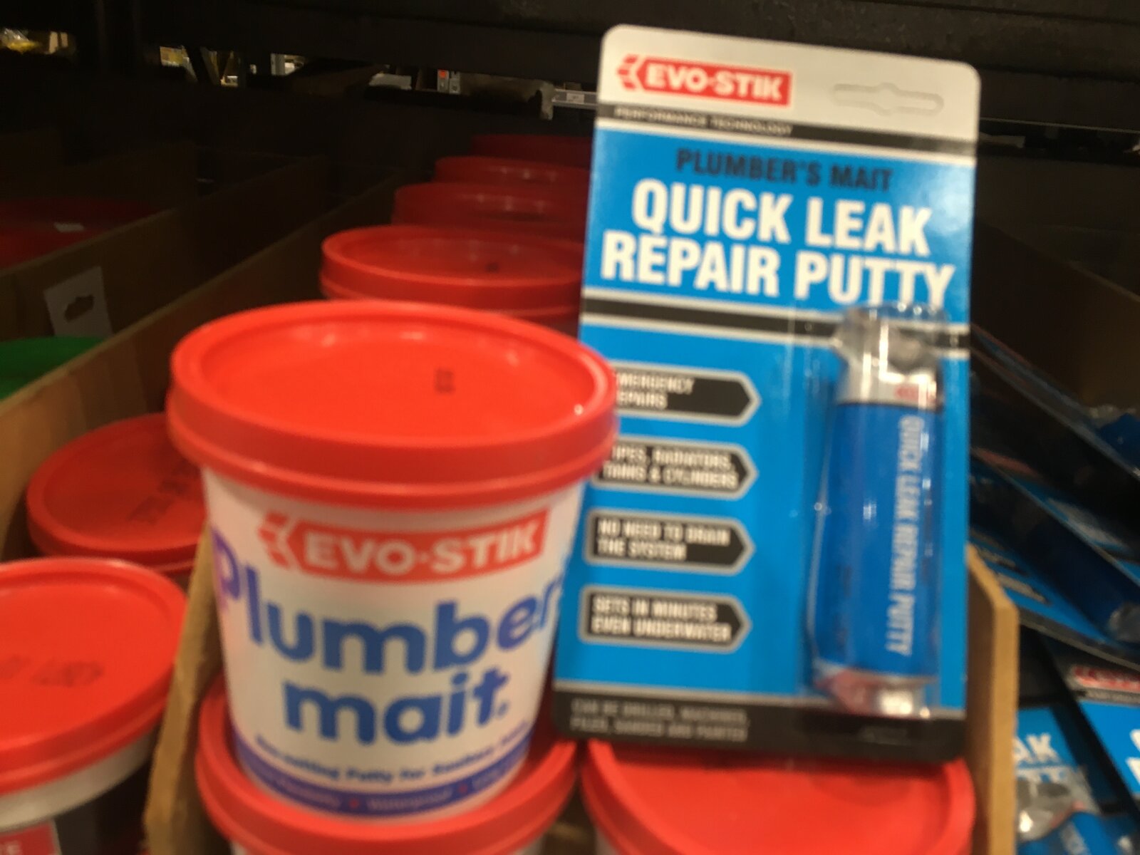

Or there are these ?
