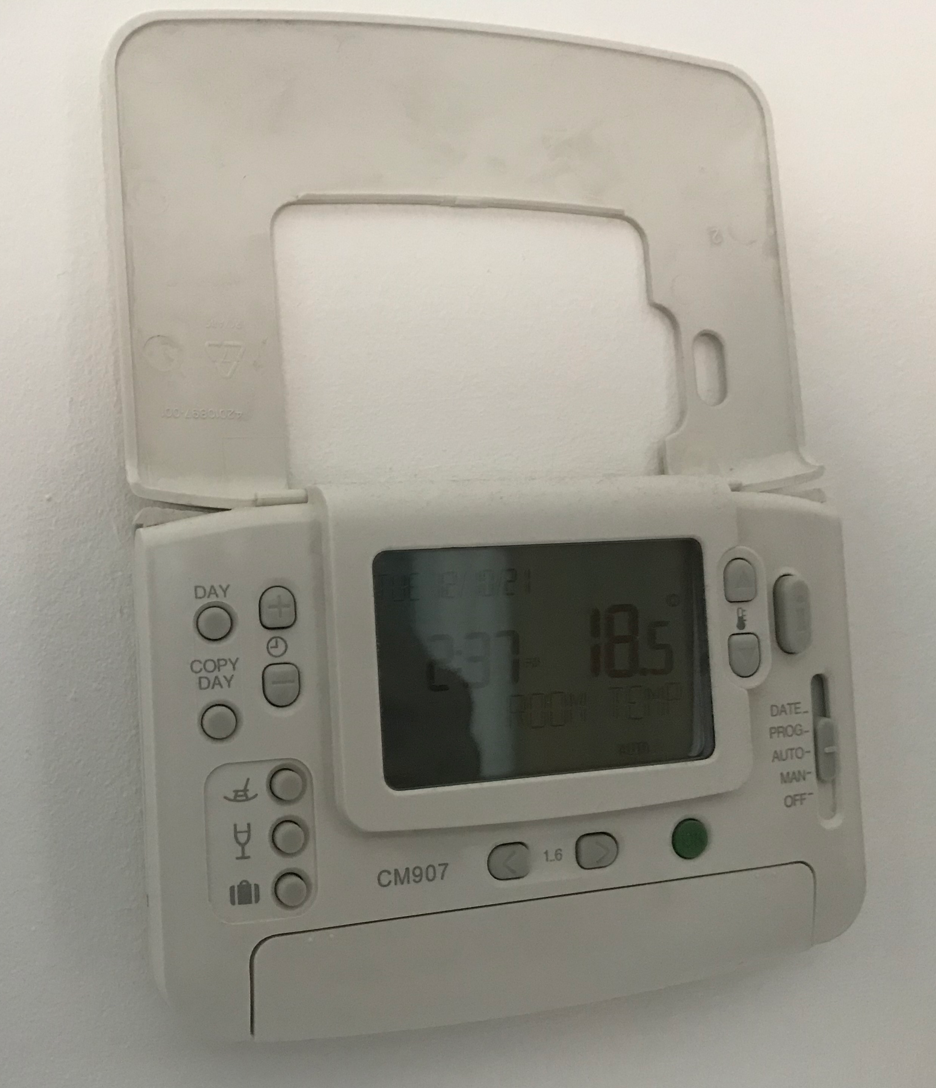

This is my current thermostat/programmer

I thought there was something in an earlier response which suggested that the room stat is still significant and there may be benefits in having this in my office? Apparently it triggers the boiler cut-off.
If you have a wireless room stat then (without going to the trouble of fitting new TRVs and new controller- don't know about others but Wiser valves will only talk to Wiser controller) yes you can use that to control heat in the radiator zone- office TRV wide open, landing TRV on a bit if you want, other bedroom TRVs off.
That is correct - best place for the thermostat is where a space is heated.
