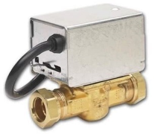

Hi
I think there's an issue with my heating
Zone 1 - Upstairs bedroom - Danfoss TP5000
Zone 2 - Downstairs - Kitchen - Danfoss TP9000
When the heating is switched on in zone 1 all radiators in the house heat up, I'm sure it used to be only the bedroom would heat up.
Any tips on what could be the issue?
The living and sleeping zones should be controllable independently. This is a requirement of the building regulations for new builds.
Each thermostat will be connected to a motorised valve that looks something like below (other makes are available ;))
The TP9000 will open and close one valve (living areas) and the TP5000 will open and close the valve feeding the radiators in the the other zone (sleeping areas)
For all of the radiators to come on' both valves must be open. So if all the house radiators are heating up when the upstairs zone is 'on' and the downstairs zone is 'off', this will either be because of incorrect wiring, which is unlikely if it used to work correctly and nothing has been changed. Or the downstairs valve is stuck permanently in the open position and allows water to pass through it when the upstairs heating is on.

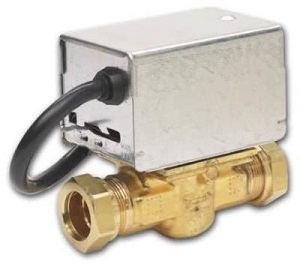

Thanks STEM, makes sense, I remember i used to hear a whirring noise sometimes when the heating was switched on, have not heard the same noise for a while.
