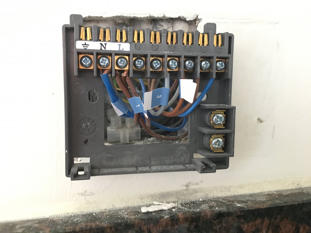

Hi, sorry I completely forgot to reply until I got a notification last night.
I don't have a photo of my completed wiring for the Tado extension, but was pretty much identical to the TP9000 with the exception of the two wires which went to the TS2 sensor in my downstairs hallway.
On my setup, the two wires in terminals 5&6 relayed to the TS2 sensor in my downstairs hallway. These are not required in my setup.
There were two wires into terminals 3&4 which related to the TP4000 in my master bedroom. I connected these to the Tado thermostat as the wired unit.
For reference on my existing system, terminals 1&2 did not have anything in them.
There were three neutral, three live and four earth wires in my existing setup. An absolute nightmare to wire up.
After that, the Tado installation software would not let me proceed further, I had to speak to a Tado support a few times for them to understand that my second Thermostat ( in same location at the old TS2) was going to be working wirelessly and battery operated. They did some work on my account and I was then able to connect the second thermostat.
It works exactly as you would expect. I had a Nest thermostat in my last house and apart from the Geek factor of having the fancy display and remote control it didn't save me any money.
I prefer the simple nature of the thermostat, and the fact that the downstairs unit is battery powered, and I have noticed a saving.
I hope this helps, it's a great system!

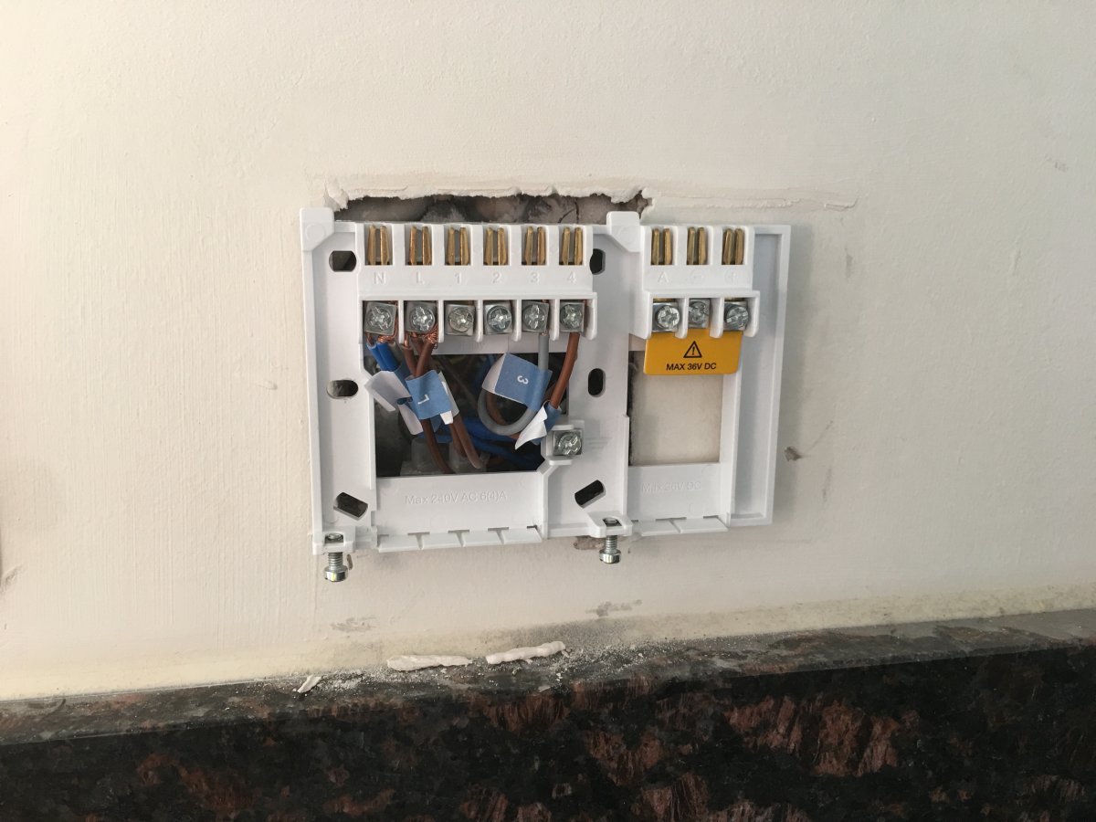

So I finally got around to setting this up today. A lot easier than I thought it would be. For me once I looked at the TP9000 wiring it became a lot clearer. Before and after are attached.
The wires on pins 5 and 6 were to the TS2 external heat sensor in my hallway so I parked these off as they weren't needed. In place of the TS2 is one of the tado smart Thermostats connected wireless. Interestingly their support told me you can only connect one Thermostat by wireless.
The TP4000 had to wires only and they went in the 2nd smart Thermostat. I have the pics of that as well if it helps.
What confused me to start with was I thought the TP4000 must connect to the TP9000 downstairs but I think this just goes off to the airing cupboard where the tank is to controls the cable for the 2nd floor and calls for heat.
Everything seems to be working as expected!
