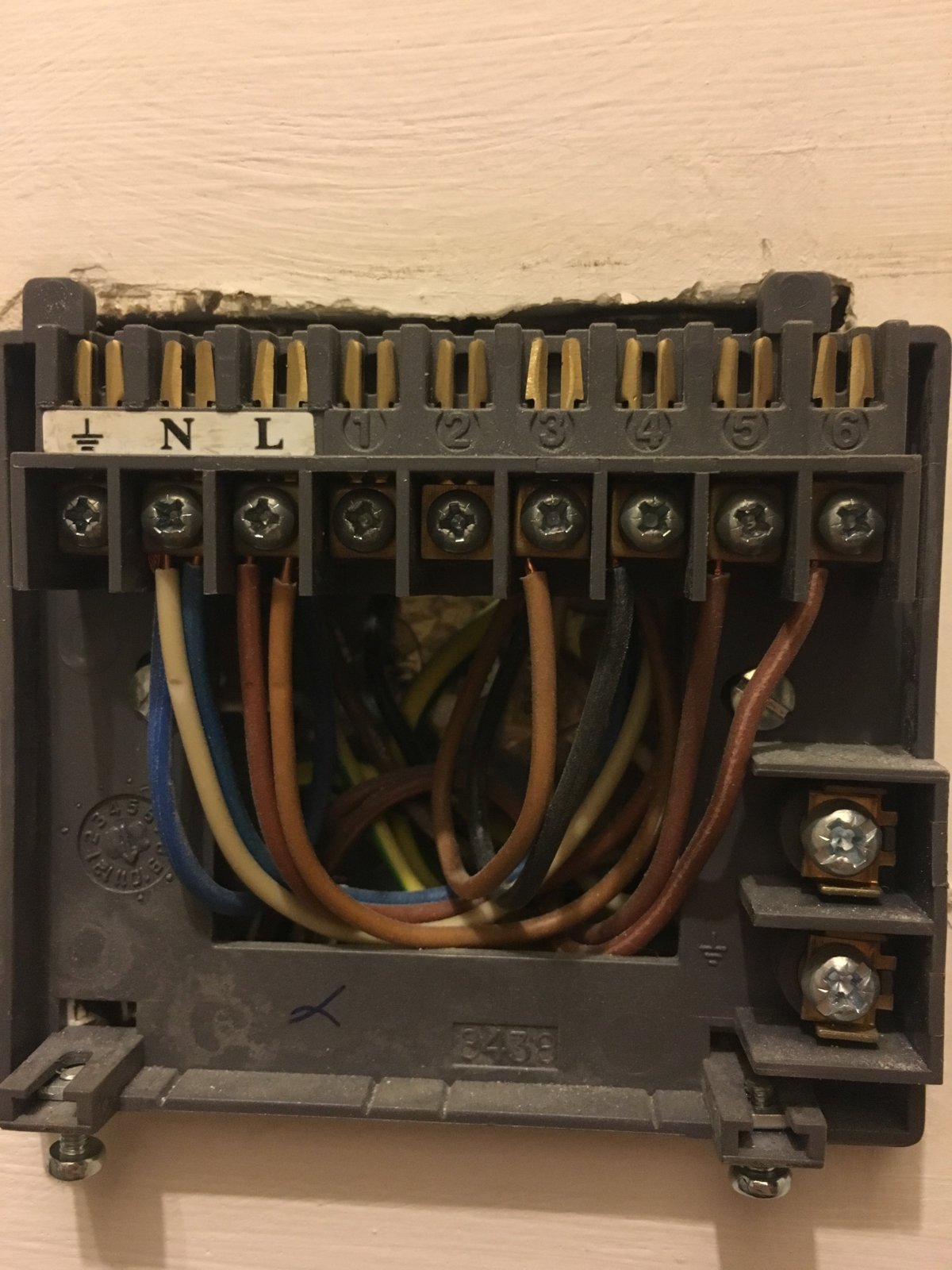

Its just the upper floor heating that is constantly on. When I set the temperature at 20 Degrees, Radiators are still on full blast even when the thermostat reads 23+ Degrees.
Suspect problem:
Not sure if this is the problem, I uploaded the wiring when it was still in TP5000 there are two wires one into COM and one into N/O.
N/C was not attached but there is a white wire hidden in the wall with the tip not yet cut.
When installing Tado, I only placed COM and N/O into the smart thermo stat and left the white wire in the wall where it was before.
Should I strip the wire and stick it into the N/O compartment?
I also attached an image of the TP9000 wiring, it has a white wire going into N. Please let me know if you need images of the current Tado wiring.

Photo of tado wiring would help...
Sorry about that i have uploaded the images. As you can see there is a white wire tucked inside the wall from previous installation not sure if I should plug that into Tado as it wasn't plugged in the TP5000 before.
The TP5000 is just a switch. 'Com' is in the input and 'NO' (normally open) is the output.
When heating is required, internally the thermostat connects the brown and black wires together, and separates them when it's not.
The Tado is exactly the same. So if you have not changed the wiring for the upstairs heating anywhere else it would appear that there is a problem with the Tado and its internal switch is remaining in the closed, (on) position.
'NC' is only used in rare circumstances with specific heating systems. If you system didn't have a connection to 'NC' before, it won't need one now and you could be creating a dangerous situation or cause damage connecting the white wire if you don't know where the other end is, or if it is connected to a neutral at the other end as you suspect.
As a simple test, try operating the heating with the first floor Tado thermostat removed from its backplate. Does the first floor heating come on now? If yes there is a wiring fault somewhere. If it doesn't come on the problem is with the Tado.

Thanks for the reply! I did what you suggested and it is indeed a Tado fault. Called them up and they said they “changed drivers” and now it’s working!
Not sure what they did remotely to make it work though
